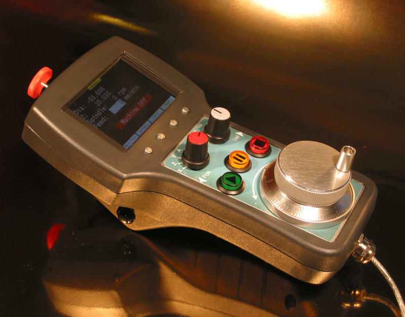

Making the design scalable may or may not be an option, depends what happens with the linear slides and what they end up being constructed from but I will know more next week.
As for the stepper controller, would there be any interest in a handheld controller that took away the need for a PC?
This is the initial description - The handheld controller will read from a USB memory stick and execute NC files with no need for a PC at all (however currently a PC is required to edit the pin config / steps per unit etc file which is then uploaded to the device using a memory stick) only a problem if you don't have a PC!!!!. It will also allow manual data entry via an inductive keypad and jogging of the machine. It uses a 3.5" colour TFT screen and is designed to plug into a 25 pin break out board. It uses a 100Mhz processor for stepper timing which should be more than enough.
I have already seen a prototype which works very well.
Estimated price - £200-£250
It will look something like the attached image.
22-05-2010 #14
Its a nice idea Steve, but if this is CNC for beginners then my 2p is that this complicates things - the device you show is still only a controller, you still need the stepper drivers, and I would argue most who are interested in building a CNC machine have access to a PC.
I think concentrating the electronics side on either sourcing a cheap driver set or, complementing the intent of the design, a cheap, easy to build, set of drivers would be better value. There is a wealth of knowledge about EMC and MACH3 and, esp in the case of EMC, there are a lot of cheap PC available to run the free software. Indeed, for real low cost, EMC2 (free) on a PC sourced from eBay has got to be a better option - there's a good selection of P3 and P4 systems which would run EMC available for <£100 and some as low as £30.

Steve, I know it would involve more work by yourself and those who could assist you but why not offer both the Pendant and the EMC2 options. Let the folks choose.
I for one like the idea of the Pendant (I am thinking of the dust problem which would not be so much of a worry for those who will be machining metals etc.) It may not be something I can implement straight off but to have the option would be great.Tim G-C
