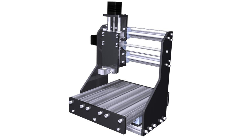

    I hear what you are saying about the linear slides which is why I want to try a few different idea's using the engineering plastic for the linear bearings and silver steel as guide rails, lets just see how I get on!
    The reason for using the controller together with 17Nm motors is because I have seen it working on a small machine with very good results, have a look at the image below.
    If anyone is interested then I know where you can buy these machines fully assembled and ready to go, cost price £450. All you will need is a stepper controller as per the one I have listed above and you will be away. They are also made in the UK.
    Before you ask I do not have any technical info on the machines but if anyone is interested then PM me and I will pass your details on.

  4. Is that one of the Marchant Dice ones?
  5. #25
    No!
    Designed and made in Derby, and not by me or John before you ask!
