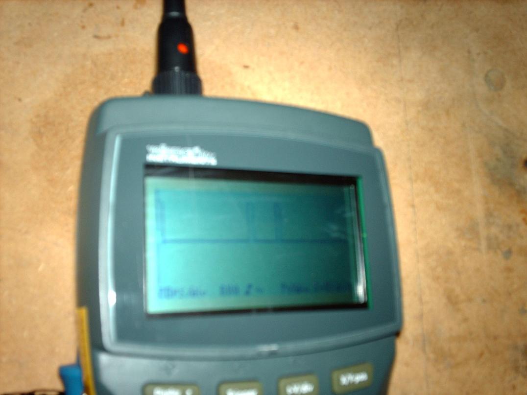

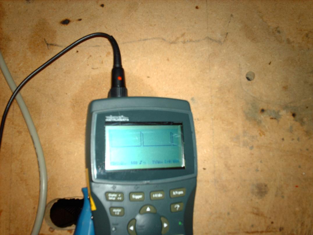

    I started to wonder about the data from the PC so have borrowed an oscilloscope and checked the pulses out of the end of the parallel cable (i.e not connected to the driver board). During a steady traverse (me pressing the left arrow for example) they show square regular spaced pulses (I'm triggering off the pulse to make it easier to read), but quite often the spacing of the next pulse varies considerably. This means that the PC is the source of the glitching.

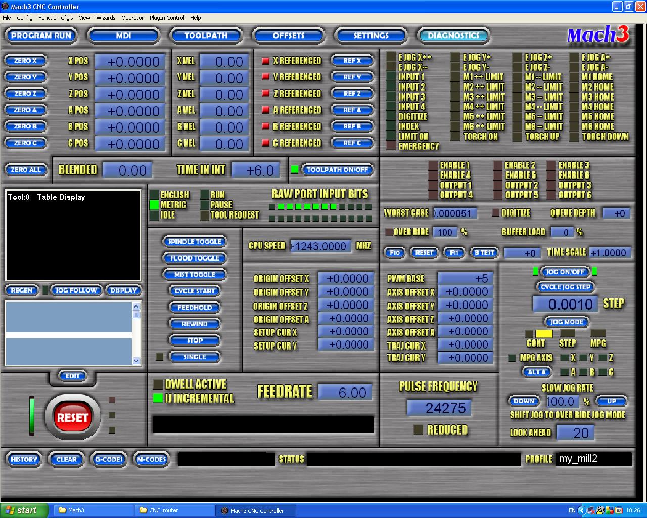

    The PC had a fresh XP install, with only Mach3, a CAD program, Vectric Cut2D, and AVG (virus checker). It is on the internet, but it still glitches even it is not. I've not checked all the processes which are running in the background, but the Mach3 diagnostic screen shows 'Int time' around 10. Sorry this info is a bit sketchy, I need to do more on this.

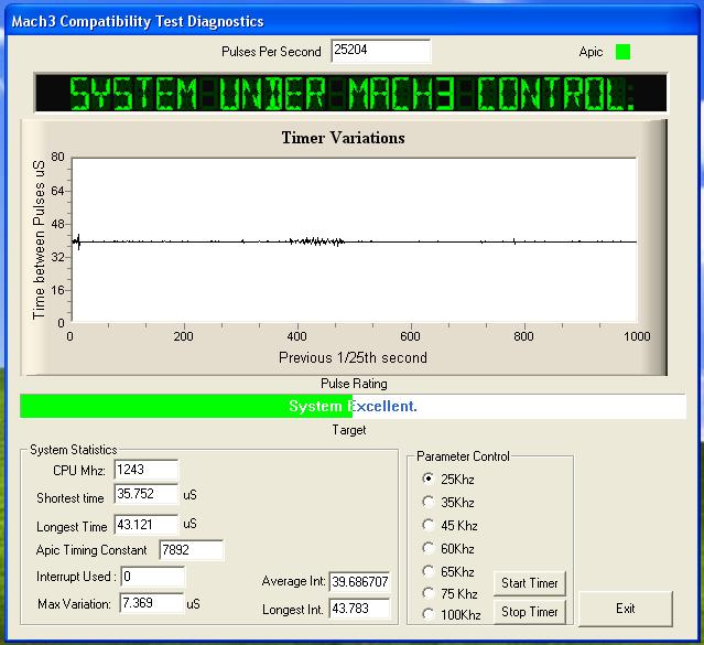

    Still haven't checked the video card, but managed to run a few more quick checks last night. Attached is a photo of the oscilloscope display when connected to the parallel port lead, pin 3 (x steps) during trraverse. First photo shows scope with even spaced pulses, second photo shows the glitching of uneven spaced pulses.
    I'm also have a video of the steppers running. I will post later, and you can hear the glitching.
    Screen shot of DriverTest program, shows all is well.
    Also switched off Virus checker, and set it up to trust Mach3. Made no difference.Click image for larger version.

    I don't use MACH because Windows isn't a friendly enviroment for stepping. Don't know if this will help, but on my PC pressing Cntl-Alt-Delete brings up the XP Task Manager. Check the "Performance" tab and see how flat your CPU usage graph is. Parking a jittery mouse slightly past the screen bottom right hand corner can help smooth it out.
    You could try the EMC2 trial disk (http://www.linuxcnc.org/content/view/21/4/lang,en/) which would help determine whether it's hardware or software.
    It's interesting that Mach3 appears to think the PC is ok but there are problems in operation. How long did you run the test and what other system activity was there?
    The EMC2 latency test suggests running it for a while and stressing the system at the same time.
    Will the scope capture to a file? - it might be more instructive to see a series of pulses.

    I did pull up the task manager and took a screenshot of the processes running, and nothing stood out as odd. I'm at work so don't have this picture, but will post it later in case anyone spots anything. I didn't try the CPU useage graph, but will have a look.
    In terms of Mach3+windows, I know there are many happy users running this combination so I should be able to get to the bottom of this, although I accept your point about Linux.
    FatFreddie,
    I'll have a look at EMC2 as part of the investigation. Should tell me where the problem is/is not. I ran the Mach3 test for about 20 seconds, and Mach3 was minimised and not cutting, but nothing else. I should try this with more things running, and for longer, and see what happens.
    I'm working on a way to capture the scope data since this would be a great help. Once I get the stepper video posted on youtube (never posted video before), it should help some of the experts out there to offer a solution.
    Another thing I'm going to try is to look at the signal off the parallel port directly at the motherboard. My scope data was from the end of the parallel port cable. I have read about suspect cables, and I'm hoping it is as simple as that because it would be easy to fix!
