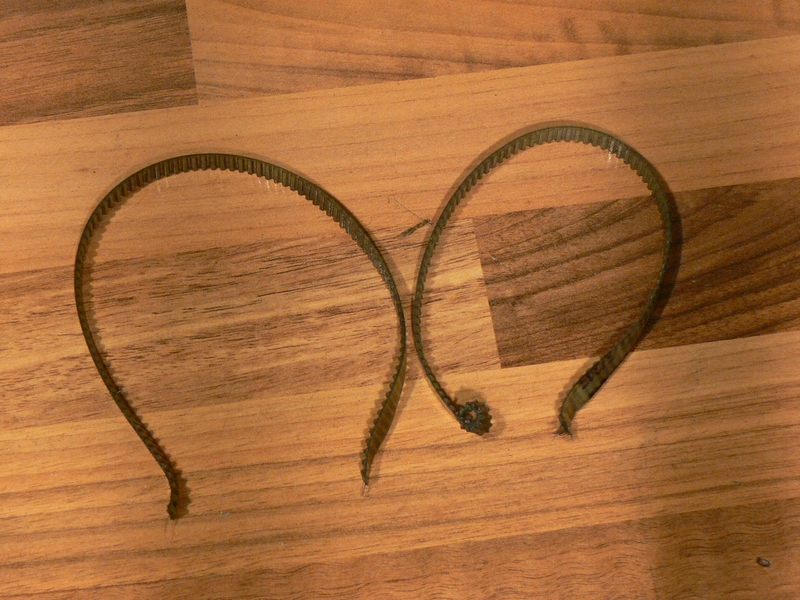

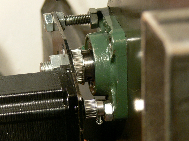

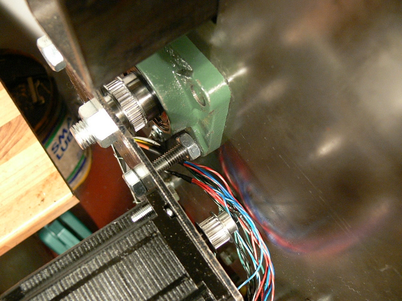

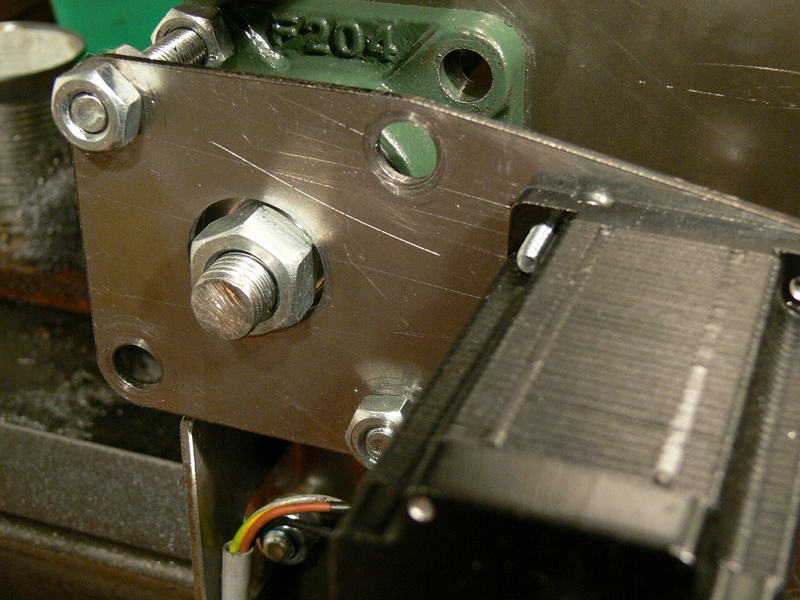

  4. I use T2.5x6mm Synchroflex timing belts to transfer power from stepper to lead screw.X and Y axes have two motors to rotate the screws. And yesterday the belt snapped, not for the first time I gotta say. So now I'm planning to replace two 2.5mm pitch belts with one 5mm pitch on Y axis but still leaving two motors to steer two lead screws. Of course I'll need to replace timing pulleys and make some tensioners. Stuff ordered,hope it will work.

    I've used XL pitch belts, at least 1/2" wide and have never had any problems. Can also make your own pulleys for them with a bit of care which saves a bit.
    What have you used for the nuts on, I think, the X axis? Is it just a brass/bronze bar tapped with the hole for oil or something more elaborate?
  6. I don't have rotary table to cut the pulleys :( . Money are sometimes an issue so I went for smaller pitch, cheaper belts and pulleys. On all axis I've got M16x2 lead screws. Nuts I've made myself from 32mm dia steel bar. They are 60mm long with a grease nipple re-drilled to fit 4mm nylon tube for oiling. Very simple, good and cheap solution, with no backlash at all.

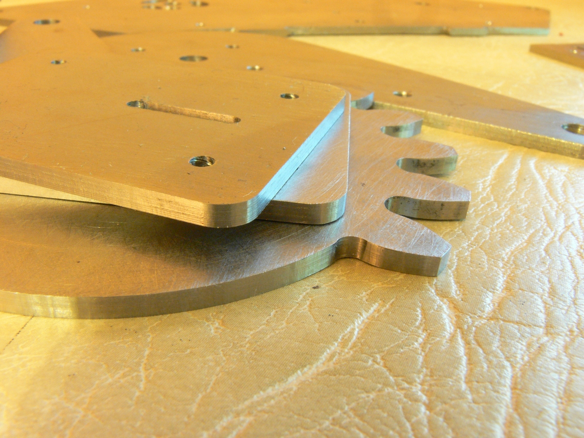

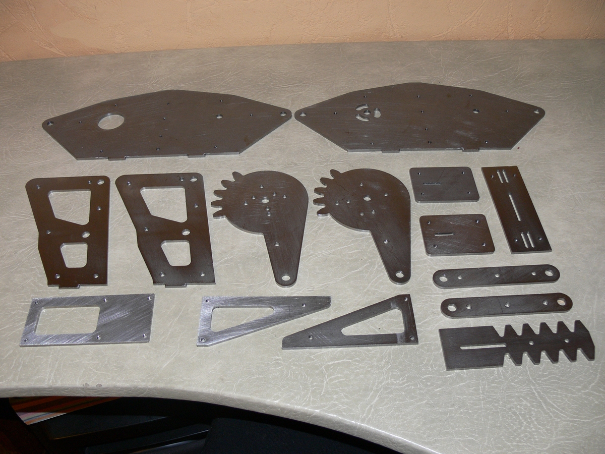

  8. You are right Chris. I've never cut timing pulleys, but some time ago I was messing with robotic arm gripper. All parts I've cut on my CNC from 3mm steel.
ID:	3751Click image for larger version.
  9. #8
    Quote Originally Posted by h4ppy-chris View Post
    you don't need a rotary table to cut the pulleys use your cnc to cut them out of plate ;)
    That does of course depend on the profile. You'd need a very small cutter to get a decent XL pulley with that method.

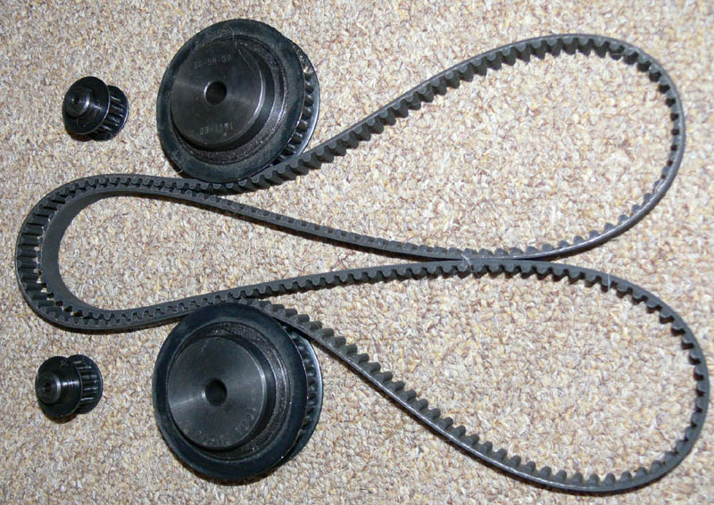

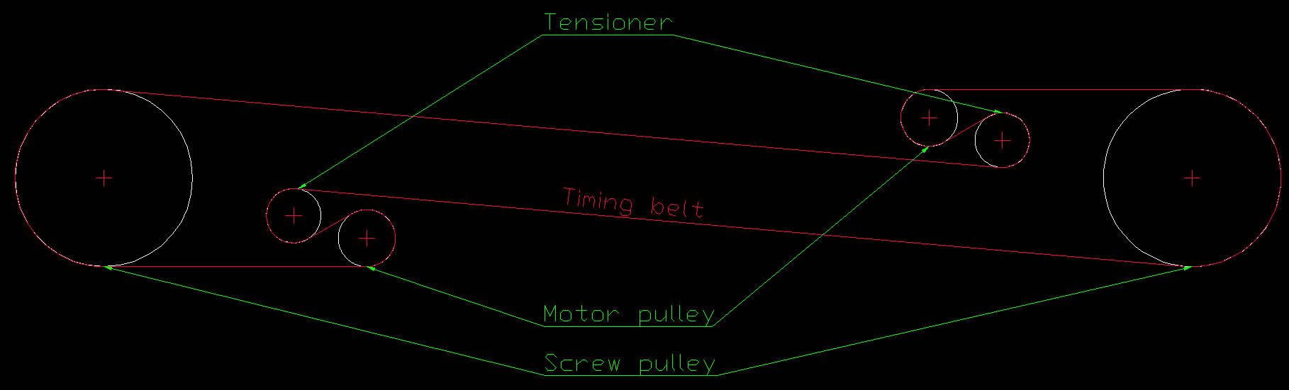

  10. Stuff have arrived. I managed to do some drawing . Hope tomorrow I'll find some time to put it together :)
ID:	3755Click image for larger version.
Name:	timing pulleys.jpg
ID:	3754Click image for larger version.
