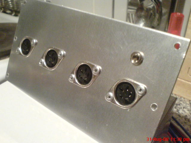

    I can do you a bag of 10 plugs and 10 sockets for... £6 Inc p&p.
    Send me a PM if you’re interested, you should note they are not the latching sockets but worked well for me.

    Lee those look like din sockets, I didnt think the current handling was that good!
    Irving those are the ones I use but have to drill them out to take the 4 core cable I use! but they work fine.
    Peter
    Peter
    Yeah, the clamps were a tad snug but I got away with it on my 4-core as I am only running 2A per core

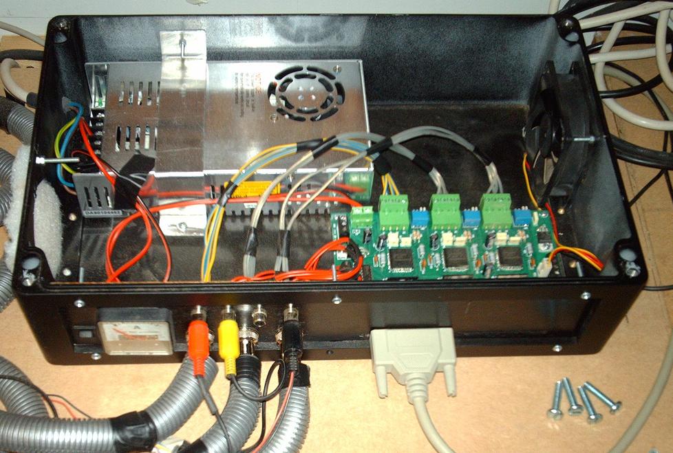

    Hi Nickmodelmaker,
    After looking at DIN, XLR etc. I also settled on the chassis plug that Irving2008 mentioned, although I bought mine from Maplin and paid more than that ebay price :sad:. I like them because they are compact, can't fall out, and have a good current rating (for my needs). Recommended.
    Barry
