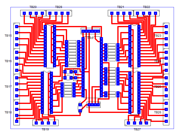

    I also use that cheap PCB from rapid, but tend to need the bigger sheets.
    Have you considered toner transfer, where you print the mirrored artwork off using a laser printer onto the correct type of paper, place it over the bare board, iron it on then etch as normal? I've used it quite a lot and you can do very accurate boards with a bit care. The best paper is the type that sticky labels peel off as the toner doesn't stick very well to it. The finest I did was an 80-pin TQFP as a test. PCB was fine but I couldn't solder it!
    Anyway, clearly milling PCBs is superior. Whilst selecting the track outlines and offsetting them to create the toolpaths works, if you're trying to make fine board it can be difficult to ensure pieces don't overlap. So instead I convert the tracks to the minimum required lines to isolate each connection.
    From this:
    (drawn with funny pads/track widths to make conversion easier)
Name:	PCB example2.png
    To this:
Name:	PCB example.png
    Unless you're doing fancy RF stuff the odd shape tracks shouldn't be a problem. It's also less cutting, so clearly tools last longer and it doesn't take as long to cut. The latter isn't really an advantage unless you're making several of the same as it takes a while to redraw it.
