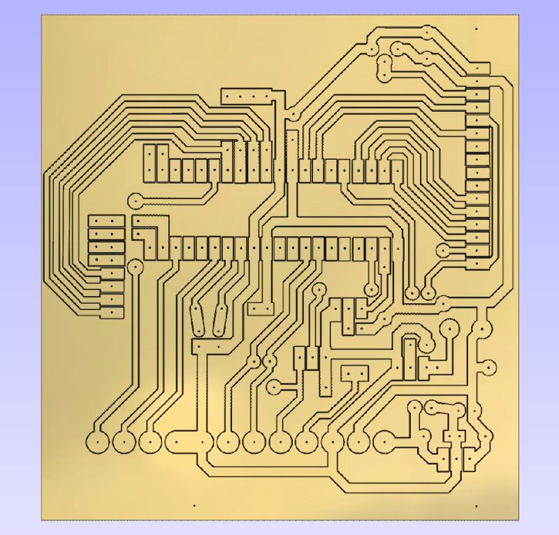

Name:	PCB LUCAS_2.jpg
    That's about 80 x 80 mm.
    John S -
  5. #35
    That's a large track width, all through hole and no tracks between the pins - I'd have been amazed if anyone had problems with that. A lot of SMT IC's have a quarter the pin spacing of DIL, which is when it gets more difficult.
    If it's a circuit which is running at relatively high frequencies I do engrave it in the 'normal' way or etch it.
    I cut plenty of PCBs on the Roland PNC2300A (same as one John S has) at school with a V-cutter. It's a very weak machine, yet did what I needed at the time (up to SOIC). So you don't need a massively rigid machine for PCBs, since the cutting force is minuscule, however if you're happy with the travel on the table and expect to use it for other things then clearly rigidity is good.
  6. #36
    Exactly....anything through hole like that, feels like groping "Dawn French" after Kylie ....Dawn might have a welcoming large warm bosom to nestle in but not many want to go that way nowadays.
    (nice board though)

    ... Oh, John, when they asked for a PCB with a bus I don't think they meant the #47 to New Street Road End ;) Joking aside, nice board John, smooth, good definition and more consistent isolation than I've managed to date.
