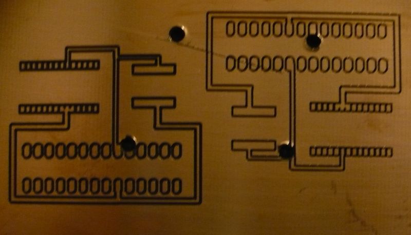

    I've decided that I need a CNC machine to mill and drill double-sided PCBs (0.4mm track size would be ok). I'll also want to cut fascias in FR4, mill custom PCB mountings (POM or ABS), and engrave casing for prototyping and maybe initial low-volume manufacturing.
    The best combination I can find for my money is a Merchant Dice A4 ballscrew machine kit with 800W Kress spindle, combined with Motion Control 3-Axis Driver Kit-1 from Zapp Ltd (3Nm SY60STH86-3008 motors, PM752 drivers), and Mach3. This appears to be adequate and upgradeable, and will cost me around £1500.
    I'm just looking for a sanity-check. Am I over-optimistic in thinking that a CNC machine costing that amount can give the repeatability and linearity to do double sided PCBs? (layer misalignment over 0.1mm can ruin the board)
    Are there better options for similar amounts of money that I've missed? I'd prefer to buy from UK suppliers. All advice and opinions gratefully received.

  2. Firstly, welcome.
    A good CNC machine should be able to hold an accuracy much better than 0.1mm but you'l need to work on the ballscrew nuts to get down to low levels of backlash to get the repeatability you need, but its certainly feasible The trick with double sided anything is the jig you need to ensure the part is exactly in the right place when flipped. The simple solution is a hard edge to push the board against, the difficulty is getting repeatability as the slightest dirt or swarf will give an offset. The best solution is a 2-part frame into which the board is placed which has locating pins that guarantee the registration from either side. This could be made from engineering plastics (delrin, HDPE) on the machine itself.
    I cant comment on the MD A4 kit as I've never seen one, however I have heard some 'less than complimentary' views. I'd have a think about the Kress spindle, it will certainly do, but runout can be an issue. I beleive there are some simple bearing upgrades to improve it. The 3Nm motors are a bit overkill for an A4 ballscrew machine but will serve for a bigger machine later.

    I had in my mind that I'd use two holes on the board for registration, either drilled just for that purpose, or possibly making use of diagonally opposite pads. However, I expect the custom holder with registration pins will be a much better option. I'm assuming that CAM software such as Mach3 will naturally handle the recalculation of relative co-ordinates.
    Spindle runout may be an issue - it would seem daft going to some lengths for repeatability just to consistently gouge furrows out of the board. The Kress datasheets don't specify runout, and I can't find any reference to people who have measured it. Can you suggest an entry-level spindle that might do as an alternative?
    I've also found it difficult to find any other UK manufacturers of entry-level XYZ tables. I've read mixed opinions on the Merchant Dice kit, but that mix includes positive reports too. If I didn't need relatively accurate PCB tracks, I probably wouldn't think so hard about this - nothing else I need requires much precision. I just want to be sure I don't have copper remaining at one end of an isolation path, or wiggly diagonal tracks, for example.
    I'm realistic about what I might expect from a £1500 machine - as long as I can get milled and drilled double-sided boards that are as good as I get with single-sided toner-transfer and manual drilling, then I'd be more than happy.

    This was done on a KX1 mill as a test for someone who wanted to do roughly the same prototype boards with no lead time.
    Not knowing sod all about PCB's, only JCB's, I asked for a file, this was code generated direct from one of the PCB software packages.
    On the left is the code as sent but the tool depth was too deep so it was edited and the one on the right run again.
    You may recognised the pad layouts but as scale the holes which were in the scrap sample board are 3mm.
    A Krees spindle will cut these tracks with no problems, no bearing update needed, I do finer work than this with no problems.

    This was done on a KX1 mill as a test for someone who wanted to do roughly the same prototype boards with no lead time. ..... You may recognised the pad layouts but as scale the holes which were in the scrap sample board are 3mm.
    Looks like 2.54mm pitch through-hole, and 1.27mm SMD. The job on the right is close to what I need. Do you happen to remember what tool you used to mill this?
    Just looked at KX1 specs - shame about the exchange-rate, because that would otherwise have been an option for me. The stated linearity and repeatability are well within my needs, and 180mm z-axis travel would be really useful.
    Just a vee shaped engraving tool with 30 degrees included angle, good for PCB's because the less you go the finer the cut and it's not so prone to breaking like a 10 thou cutter.
