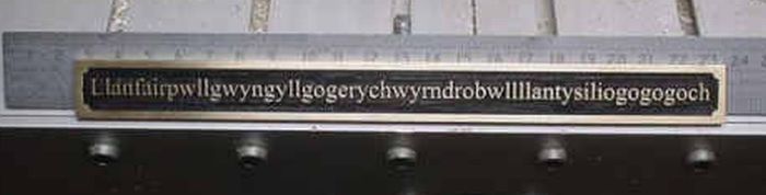

    How does the Vectric software cope with engraving ? I only need simple name plates.
    Do you have any experience of this ?
    Many thanks Nick.
    Nick,
    This was done in V Carve

    Sorry about the poor camera phone pic.
