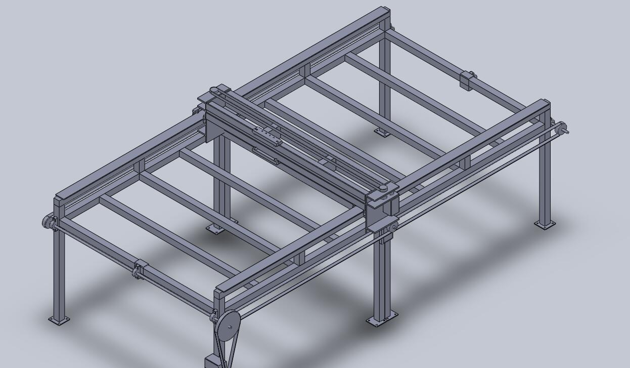

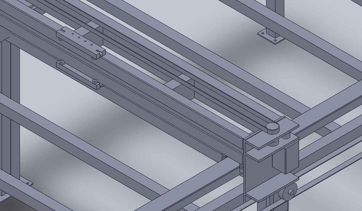

    Im following a design from automatedwoodworks.com and have reservations about the brace used in the gantry. A few people have said the gantry may twist using this design and I would like to do something to eliminate this possibility as much as I can.
    The original design uses 1no. cross piece of 100x50x6 aluminium channel but I have updated the images here to show the use of 2n0. 100x50 aluminium hollow section.
    Original machine can be seen here http://www.youtube.com/watch?v=7XwM_azm1so
    Thanks guys.

    Hi psiron
    Not sure I understand the how the y axis will work the same.
    The obvious problem I can see is that it looks like there are only bearings on the top beam and plate arrangement and the belt drive is then down a lot lower. if this is the case then you will have problems with the bearings binding due to the lever arm (cantilever) effect. I 'd move the driving part of the belt up to the centre line of the bearings. having the side plates drop down so far will also cause a lever arm in the y axis direction and cause racking that way to.
    Another weak point is the belt drive shafts at each end need more support, either a central strap in the middle or the best solution is to support the free ends. it may not be to apparent but once the belts are tensioned and its in motion even the smallest flex will cause problems.
    Have you got any more drawings or plans, is that CAD or sketch up? its all good in principle just dosnt look very well executed. to me the whole thing could do with more diagonal bracing, if its done in opposing pairs then they can be considered to act in tension so can be quite small sections with a thin wall.
    If it was mine I would turn the x axis bearings through 90 deg, centre it on the plate and then run 2 rails/flat bars for the y axis (1 above and one below the bearing) again with the belt driving half way between the 2, that way it's all braced up with no cantilevers or skewing forces.
    Anyway thats my 2 peneth
  3. Hi Psiron,
    I've been an Engineer for about 16 years, and into DIY cnc for about 2 years, so you can decide how to take any of my thoughts on this one.
    I'm struggling to imagine the Y gantry since alot of it is missing, but it sounds like an open section 'aluminium channel' which is bad for torsion. Closed sections are much stiffer. Any chance of a picture to help explain your idea?
    Linear rail for the Z axis will be fine. Tried and trusted solution. Consider mounting this in reverse with the blocks stationary and the rails moving. This allows the lowest block to give maximum support all the time. The conventional way round with the rails fixed means that the lowest block is always further up rail to allow for the plunge. Sorry, this is difficult to describe.
    It looks like the only thing stopping the gantry falling off the rails is the belt tension, and it's own weight. Not sure about that one. A high speed router coming off the rails could be nasty. Watch out when plunging! Maybe there is a lower bearing restraint missing from the CAD.
    As for the binding, there might be more to that than Russ suggests. In theory there will be a cantilever effect (binding risk), if the product of all the forces leads to a net rotation. During high speed traversing and changes of direction when not cutting, the force applied by the belt is likely to be well below the C of G of the heavy bits on the gantry, therefore there is a net rotation, and a binding risk. This could be overcome with gentle acceleration values.
    But during cutting, things are a bit different. The router inertia would have less effect (not moving so fast) and there is now a reaction force at the cutter. This might be quite close in Z to the current belt height. If they are the same height there is no net rotation and no risk of binding. If you move the belt up to the bearings, then you would be some distance from the cutting, and a rotation would occur. I've given this lots of thought as you can tell! This could do with a good picture, but the football has started so I'm off . . .
    Agree with Ross about the support on the shafts, they are loaded by the belts and may start to whip.
    Also agree that a bit more CAD would help . . .
    Barry

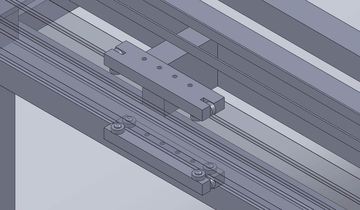

    Firstly the carriages have bearings below. The carriages are mounted to flat bar, there are 6 bearings in total in each carriage. Full details are available at www.cncrouterparts.com.
    With regards to the pillow block bearings I agree, the final design will include a central block bearing on each shaft to stop flex when applying tension to the belts.

  6. Hi Psiron,
    The double 100x50 box section gantry looks much better. If it is well tied in to the upright side pieces, then this may be OK. The next thing to flex would probably be the raised side rails upon which the gantry runs. Can these be joined across to each other at the far ends? This would block loading of the workpiece a bit, but is worth considering at least at one end. Or a big shear panel at one end to tie down to the under structure.
    The video shows linear rails, which are a great help if you can afford the long lengths. The video example does not bind with the belts low down on the sides, and looks like it would cut OK too.
    What do you mean by rhs instead of channel? If this is RSJ then this is also poor in torsion and would not make the best gantry. Run with the box section.
    Good luck with it, and send out more when you have it.
    Barry

    RHS is the term for rectangular hollow section, that's what is in the drawing. With regards to welded steel, my frame is the same as the original one in the video, welded 50x50x4 box section. The sides of the original gantry are drilled and tapped, the same as mine will be. I have the actual plans from the original machine, I'm just trying to improve the gantry really, I would also like to make any changes which would eliminate any problems down the road.
    The linear carriages run on drawn 75mm bright bar, drawn steel is extremely accurate and the carriages are designed to run on this material. I have seen a machine run on these rails and they are impressive to say the least. They are used in Joes CNC hybrid too. The flat bar is drilled and secured to the top of the table rails, by clamping both sides of the carriages together I can obtain a precise fit on the flatbar, once this is done on both sides the gantry braces can be cut to the precise size.
