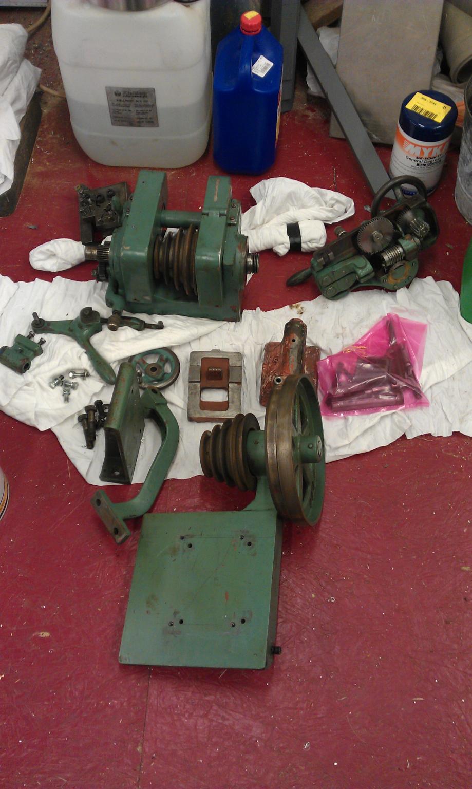

    The gearbox has been rebuilt and has been tested as working fine. I have stripped down most of the remaining parts now and cleaned the grease and crap from them and scraped the loose paint from some of the parts. I also have a couple of bags of bits that I need to make sure I dont lose somewhere.

    I also had some problems with the apron. The power feed for the cross slide was not engaging so I have also stripped this down and fixed it and reassemble it ready for painting

    I did find a problem with the compound rest base. At some point the thread for the base clamp has been stripped so this had to be replaced with a recoil. Hopefully this will be ok.
