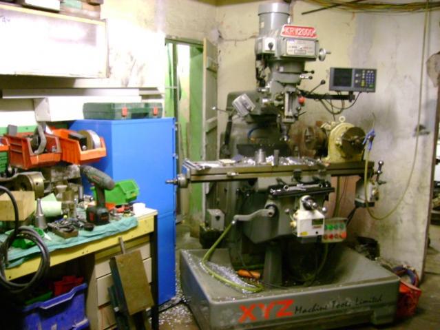

    A proper mill - something that'll take a couple of cubic inches out of a casting in a relatively short space of time...
    Hi I’ve got a mill and travel from north down to Kent fairly regularly M6, M1, M25, A2M2
    Would you be interested in me doing some machining?
    Kevin

  2. Quote Originally Posted by keebo View Post
    Kevin
    Kevin, Thanks for the offer. I'm going to look at a short term fix first but will come back to the milling out option if that proves unsatisfactory.
    Nice mill btw...
    regards,
    Irving...
