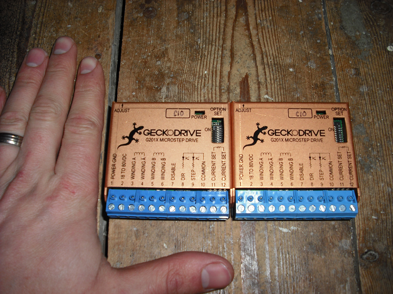

    I have so far purchased 2 Gecko 201x Drives and also the C11G breakout board from CNC4PC.

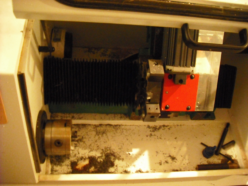

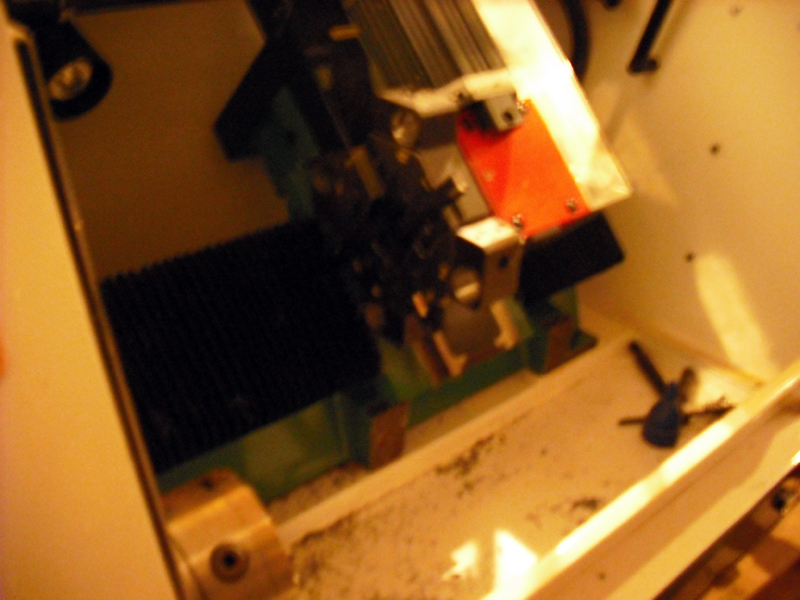

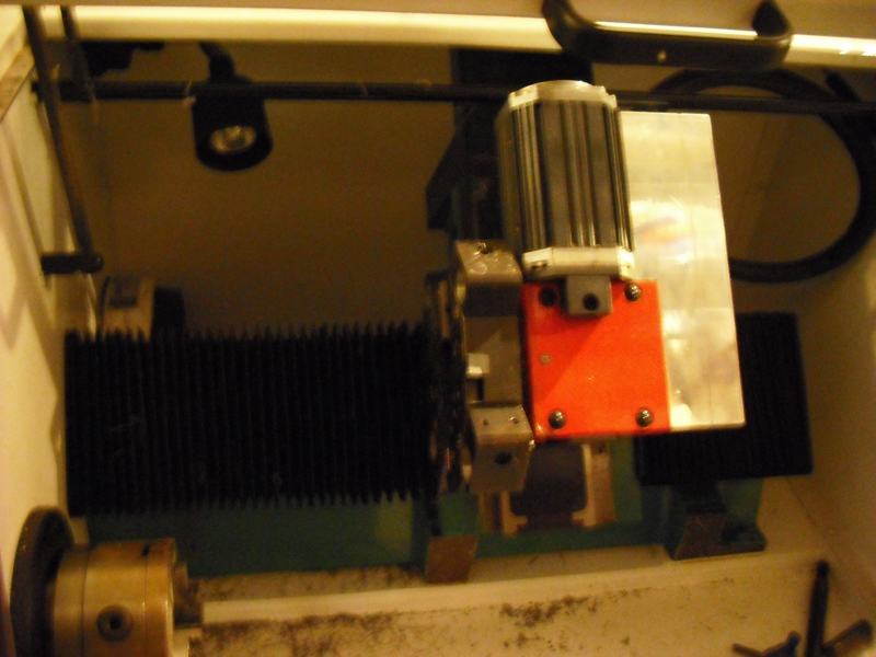

    Thanks Irving2008, I'm going to try to get the geckos in place over the weekend as I believe the attempted delivery today even though I only ordered on Monday from the states! I'll have to take a good look at the toolpost/spindle drive as there is defiantly only 230 going on, I guess maybe its an 3 phase inverter.
    I have attached a few pictures of the lathe, there not the best as my camera was going flat and I couldn't use the flash.

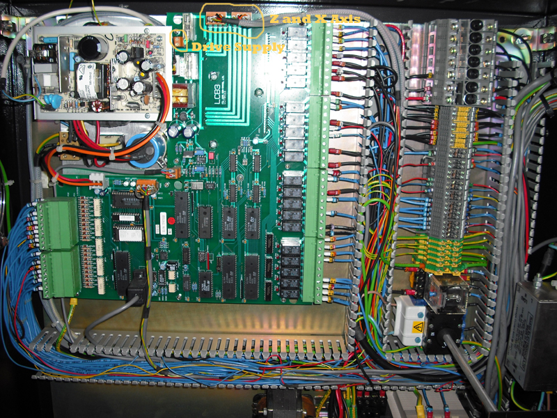

    Today I brought the electronic control box home and got the geckos out of their packaging. I was quite shocked how small they are but they seem to be excellent quality. Gecko shipped them very quickly, I received them within 3 days all the way from the US!
    Anyway I sat down with the control box and started working out what's what. I have identified the X and Z axis's on the slave board and also the drive supply. I has hoping to work out what voltage the steppers run at by measuring it from the drive supply connector but it seems it does not output any voltage when not connected.
    Does anyone happen to know what cables go to what on these steppers. If not can I just work it out by doing a continuity test?

  6. On the gecko's
    A+ = Yellow
    A- = Red
    B+ = Black
    B- = Orange
    If the stepper runs backwards, swap Yellow and Red over...

    Thanks Irving2008, I was hoping to give it a go today but unfortunately I have only just finished work! Any ideas what the supply voltage is?
  8. cant say, without a close look at the Power supply, but trace back to the smoothing capacitors for that supply rail and look at their voltage rating... generally the supply will be 50-70% of that. Or measure the secondary AC voltage of the transfomer that feeds it - the DC will be no more than roughly 1.4x that. I'd hazard a guess at 24 - 36v probably...
    I have made a little progress with the machine today. I worked out that I really needed heat sinks and fans for the Geckos as per the manufactures instructions for currents over 3A. I was told a little while ago that the steppers on the Mirac draw 3.5A under load (I also found out they run at 38V). I purchased 2 of these http://uk.rs-online.com/web/search/s...duct&R=158-556 heat sink and fan assemblies and have fitted them to the Geckos. I removed the slave board and then mounted the heat sinks to the large plate of aluminium where the slave board was.

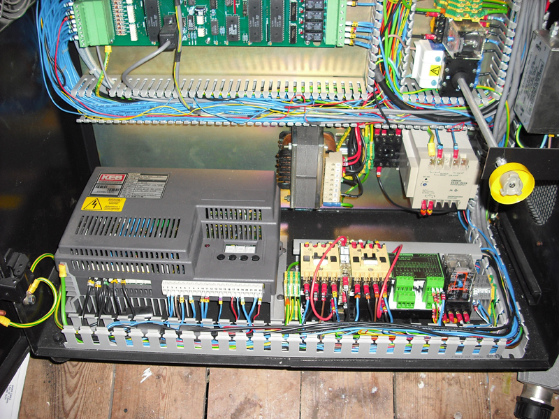

    I had to order 5 C15 Dual Relay boards from CNC4PC. They will be used for enabling the spindle and tool post, running the spindle and tool post in forward or reverse etc
    It seems that the spindle and tool post are powered from the motor controller/inverter together and 24V relays are required to turn the contactors off and on to turn the motors off and on. Theres speed control and an encoder for the spindle but doesn't seem to be anything for the tool post other than a DC brake. I'm guessing that the tool post uses a worm drive and runs at a set speed and you just have to time how long you run the motor to get to each tool.
