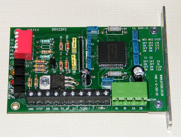

    3 x Driver 25PS (DiyCNC boards).
    2.5 amp at 30v max.
    Only used for a short amount of time.
    http://www.diycnc.co.uk/html/driver25.html
    £15 each.
