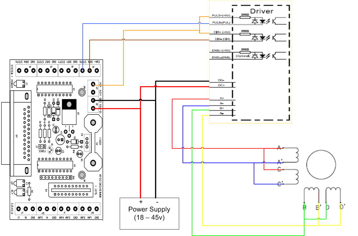

    I'll submit a drawing of how I've wired them up if this helps anyone?
  3. George,
    A quick diagram, and also say what you MACH3 setting are and we'll have you going in no time... :) The combination of kit you have is very common so there should be no surprises....
    What power supply are you using?
    Did you buy the DIYCNC board as a kit or ready made?
    When you power it on, what lights/sounds do you get.
    Do the motors 'lock' when you power up, or can you still turn them by hand?

    Hi Irving
    Power supply is 24v at 6.5amp output.
    Bought it as a kit but i'm conversant with electronics somewhat.
    Do you mean the lights on the Breakoutboard? if so only the blue powerlight comes on.
    The motors lock,to be honest I'm not sure about the pin layout on the breakoutboard...Imean the info in the manual is not written very well, I'd go as far to say that it was terribly poor explaination for the novice CNC builder.
    Will post a diagram later on today as I really need some shuteye,goteyes like ciggy burns in a blanket.
    Thanks a bunch for helping.

    Irving,that diagram doesn't show the enable +&- does that mean they are dismissed?
    There's one wire there that I had in "ena-"

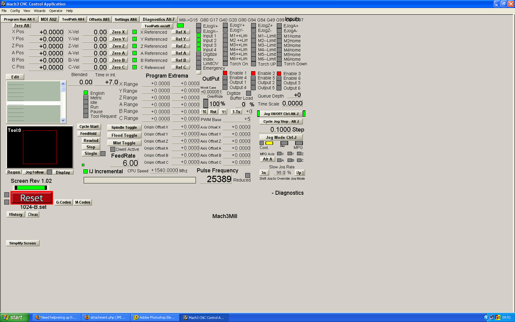

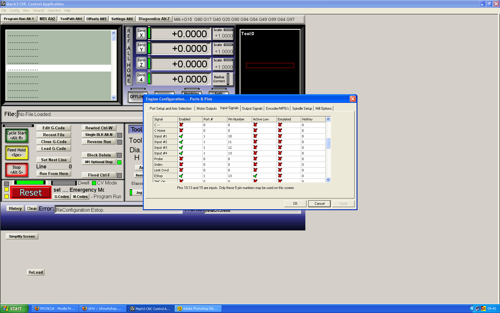

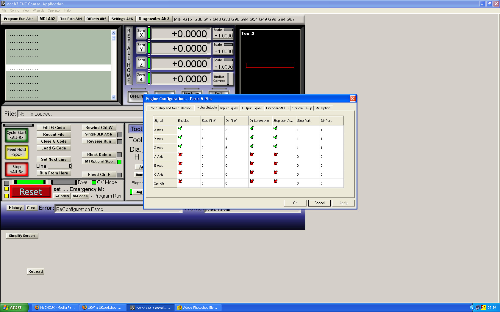

    Here's some info on the motors setupin Mach3...need any more please let me know?
    I'm summising in the diagnostics screen those red lights should be green? but no matter what I do I cannot get them to turn green?

  10. Quote Originally Posted by GeorgeD View Post
    George,
    In the Outputs tab, disable the 'enable #1,#2,#3 and output #1,#2,#3 lines (red X them) but enable the ChargePump line on pin 1... I suspect thats the reason its not singing... assuming wiring is OK
