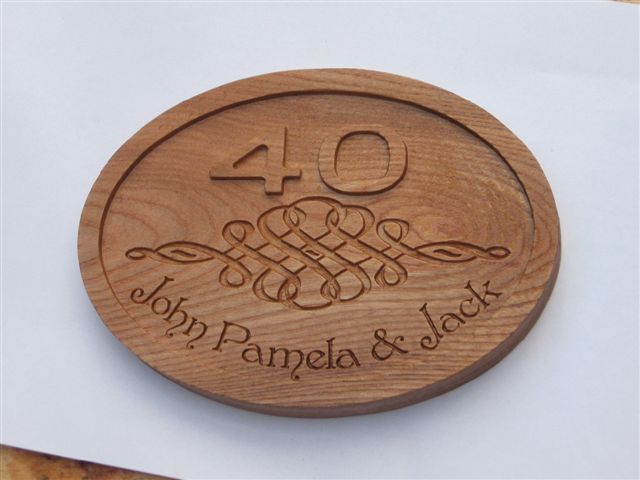

    cut this sign tonight with my router , wood is elm pocket was roughed with a 8mm mill end finished with a 3mm mill end, engraving done with a 30 deg engraving bit , v carve pro software . took me over a year to build this router but its been worth it
    That looks nice :clap:
    Now that dose look nice mate, have you put any stain on the wood or is that just how Elm looks ?

    just some clear lacquer lovely wood elm, went to a sawmill near me bought a load of off cuts elm , sycamore, ash and lime . keep me busy for a while
    That's a great sign mate can you tell me where I can get a DXF for the pattern used ?
    Nice work, well done. G.
