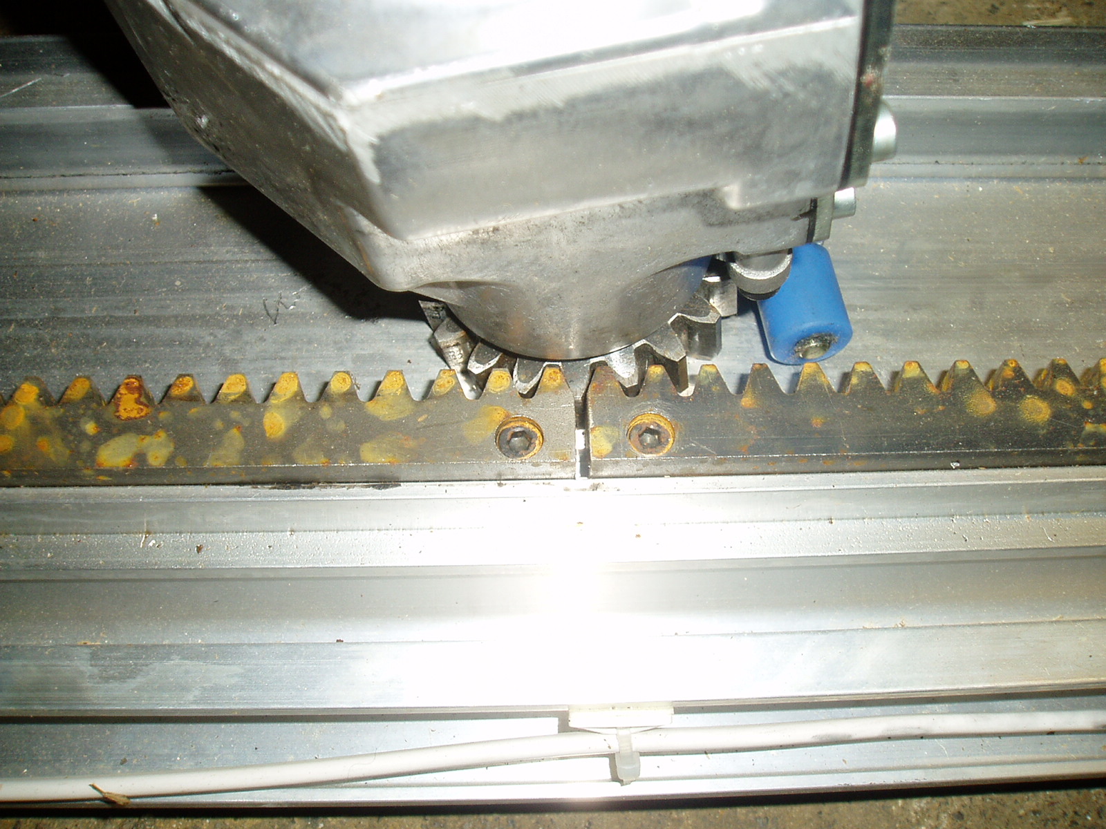

    Sure it will just get the angle grinder out, or better still bench grinder, and shorten to the right length. dosnt matter if you go a bit over just leave a coresponding gap.
    This is from a stair lift, not really precision kit, but you get the idea.
