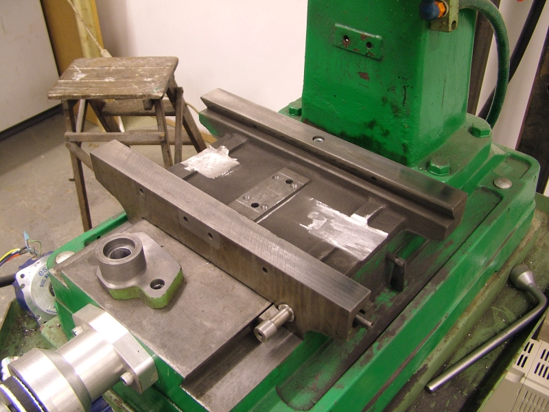

  1. I recently brought the above and would like to convert this machine to CNC. I have read a couple of excellent build logs that Tweaky and Robin Hewitt have written. My question is regarding the diameter of the ball screws to use. The machine currently has a 24 mm dia for the x and y lead screws. As Robin found out there is a tight fit between the underside of the table and the base on the cross slide for the ball nut housing. I would like to use a 25 mm dia screw as this is close to the current lead screw. The two sizes of ball nut, 20 mm and 25 mm, have a dimension of 44 mm across the double 'D' and 48 mm respectively. I have measured my machine and the distance between the base on the cross slide and the majority of the table is 44 mm. The two ends of the table are closer and would need to be machined away to give the whole table the same clearance. If I were to machine a pocket where the base is on the cross slide to a depth of 5 mm from the original top of the base I should have room for either size ball screw. I am just not sure if a 20 mm ball screw would be OK. The table on this machine is 800 mm long. I would be interested in your thoughts.

    Thank you for your reply. I have attached three photos. One picture is of the mill that I have. Note there is no round column. One picture is of the current nut which is bolted to a raised base on the cross slide casting and the last picture is of your cross slide casting which looks the same as mine. It is that raised base that I thought of machining to give more clearance for the X nut housing. The top of the current X nut does collide with the last 100 mm at each end of the channel under the table but has 45 mm approx clearance for the rest of the travel. The FSU nuts for 20 mm are close to colliding so this is why I thought of machining the base down by 5 mm. This would give me about 1/2 to 3/4 mm deep pocket to locate the X ball screw housing.

Name:	Warco Super-Major Mill.jpg
ID:	2429   Click image for larger version.
ID:	2428   Click image for larger version.

    Warco only support the X axis screw at one end, thrustwise. If you stick with that arrangement you may need a fat screw. If you hold X in tension you can save yourself a lot of work trying to fit fat ballnuts.
    If you are planning on using the Warco thrust races, you are probably also planning to skip putting a screw on the Z. This is a recipe for disappointment.
