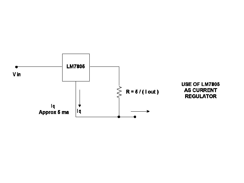

    I am looking for help and advice we regards to the best way to drive a low powered laser diode.
    This is a basic design I have come up with:
    I have yet to work out all the vavles needed for R1 and VR1.
    But would this design work ok?
    Thanks for your time.
    Best Regards.
    Not sure what the laser diode needs but a simple current source can be a 7805
    Hope this will help
    Peter
  3. It could work, but whats the laser diode current you expect?
    Most sub-200mW laser diodes are somewhere in the 60 - 150mA rating, so asssuming thats the range you want R1 = 1.2/0.15 = 8 ohm (use 7.5) and VR1 is 1.2/0.06-R1 = 12.5ohm (that could be tricky, but RS do a 25ohm 1W ). Power dissipated in each is ~0.2W (R1, use a 0.5W) and ~0.3W (VR1, use a 0.75W or 1W)
    Most laser diode have a forward voltage of 1.5 - 2V. The LM317 needs a 1.5v headroom and you need 1.2v in the R1/VR1 combo... so the input to U2 needs to be 2 + 1.5 + 1.2 = 4.7v... a tad close to the 5v out from U1. Also in this configuration, at say a diade current of 100mA, U1 is dissipating (24 - 5) *.1 = 1.9W and U2 only (5 - 3.2)*.1 = 0.18W. The disspipation in U1 is close to needing a heatsink (2W). I'd even things up and use a L7808 or L7809, which would then dissipate (24-8) * .1 = 1.6W and U2 would dissipate (8-3.2)*.1=0.48W and you'd have more headroom if you had a particularly high forward voltage diode.
    Personally I'd scrap U1 and drive U2 from the 24v rail, dissipation is then (24-3.2)*.15 (worst case) = 3W so will only need a tiny heatsink, anything better than 25degC/W - clip on jobbie will do.
    What is the purpose of D1 and D2?
    Peter's solution would work, the 7805 driven direct from the 24v rail would dissipate (24 - 7) *.15 (worst case) = 2.55W so again a small clip on heatsink would be advisable. 7805's are cheaper than LM317T!
