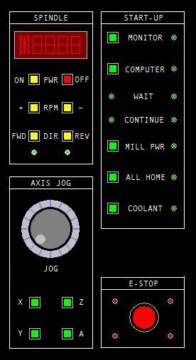

    Revised panel layout. (Thanks for pointing the errors out Irving)

    Why not use the one jog wheel for all up/down inc spindle speed?
    How will you change jog rate?
    You seem to have lost your 'feed' requirement. I'd use the one display to show spindle speed, axis steps and/or step rate, and selected feed speed
    BTW, in case you hadn't picked up on it, the e-stop to MACH3 is just a repeater input to tell it e-stop has been activated, the e-stop itself should release a main contactor and kill all motion not relying on software.... this is normally a self latching relay
  5. #145
    lol
    Using the contour shuttle express i have 5 buttons and a fast jog and slow jog available so the feed is not off the table just not on the layout yet..
    My mental capacity is less than yours so, i only suggest things that i have some chance of achieving, you have no idea how helpfull you have been already..
    Rick...or is it Fick... lol

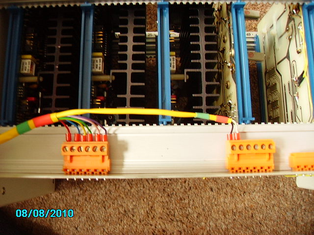

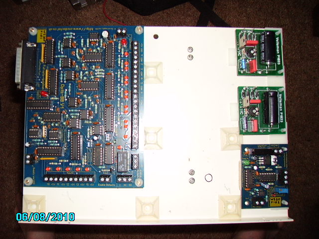

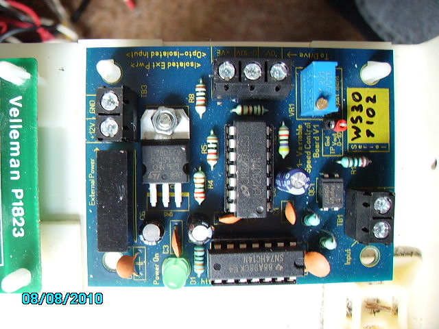

    Started to get the basic wiring done.
    First job was to identify the step and direction pins on the SD3 Drives using the SD3 manual. Once that had been done I fitted the transistors and resistors which addressed the fact that the SD3 drives use 12v logic and I will be using a 5v logic system.
    With those two things completed, ive mounted the boards i have so far.

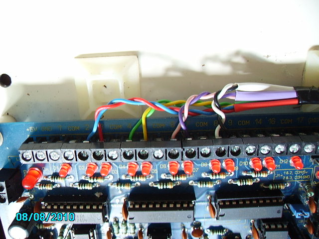

    Ive begun to wire things in..
    With the help of a post by Irving I was able to wire things to the default settings in MACH.
ID:	2585.............Click image for larger version.
    Stepper axis wiring completed!

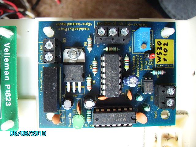

    Motor speed interface to be wired between Lenze 534 and BOB

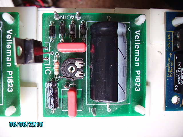

    Motor speed interface has its own power supply (0-27vdc LM317T based board)
    ** remember not to wire the output up to anything untill you have set the voltage.**
    Onward..
    Rick
