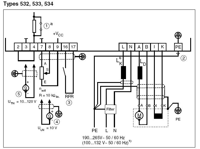

There is no brake resistor in this circuit but i dont think it will need it... the stop time from 3500rpm to 0rpm at the motor spindle is less than 2 seconds..

Oh yes All axis installed and working perfectly with mach, spindle working with mach speed control (how much fun was that lol) just installed E-Stop Circuit, and spindle start switich and contactor, now about to start on the Fwd-Rev contactor, and then on to spindle start, fwd-rev relays with mach control, at the moment it is a manual start button for the spindle start
and direction.
Onward!!!
on a side note ive almost finished my chineese tacho as a stand in untill something better comes along lolAlways bear in mind that your own resolution to succeed is more important than any other - Abe Lincoln
