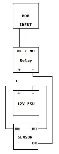

OK ive got an hour or so before i have to go to work so i decided to have a look at this tach setup, the 22 sensor i have used is obviously working as i get numbers on the display but they are all over the place, so i decided to investigate the existing sensor that is on the spindle, this is an rs 306-061, there are two types of this sensor, mine is the slotted type, my uestion is can i use this with the divider circuit i got from irving...(posted earlier in this thread??) or indeed if irving is around what does he think..

why don't you just make a disc with one slot, and swap it for the existing one.

Im fast leaning in that direction, i may just wait and buy the tachulator, its off the shelf, programmable, it comes with the sensor, and it has good reviews, I did'nt want to go down the build your own route as ive done all this PCB DIY before it drives me nuts but at least i had a go. the thing is i dont enough hours in the day as it is. Having built the circuit got the display and the sensor now comes all the tinering about, it really would have been quicker and less hastle to just buy one lol. but i really do believe in buying within the UK if possible..
