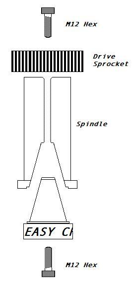

    LOL nope the spindle has an M12 (I think) thread in the top & Holds the sprocket on, that goes all the way through and as you may know the easy change has an m12 hex bolt that goes up inside it...
  2. #232
    Here is a quick drawing i knocked up just to give you an idea:-
Name:	Spindle cross section.JPG
    Ill give you a buz in a moment.
    Rick
  3. #233
    i2i's Avatar

  6. #236
    i2i's Avatar
    From the details and a quick chat it seems that the spindle has been made specifically for the easychange toolholder, without the normal r8 or 30 int holder.
  7. #237
    Quote Originally Posted by MHJ View Post
    As to the spindle taper I can't help you, because I've never had the easychange chuck off. From your photos it could be a modified INT 30 without the driving slots/keys or a shortened MT3....some measurements would throw more light on that issue. Is the disappointment about it not being R8 because you have a heap of R8 stuff? Collet chucks and so forth? .
    Well as stated by i2i in the post above, the actual easy change chuck and spindle, after investigation seems to have the same taper as one of the easy change tool holders, I had wanted to go down the R8 tooling route as there is so much R8 tooling out there at such a reasonable price. as it turns out my plans for the future of the 'Z' Axis fit quite nicely with the existing taper, in fact im very happy as i intend to fit an ATC and the spindle fits nicely with that but that will be in another chapter!!

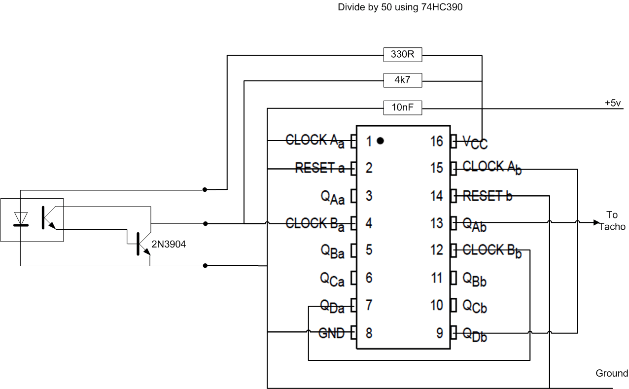

  8. #238
    OK ive got an hour or so before i have to go to work so i decided to have a look at this tach setup, the 22 sensor i have used is obviously working as i get numbers on the display but they are all over the place, so i decided to investigate the existing sensor that is on the spindle, this is an rs 306-061, there are two types of this sensor, mine is the slotted type, my uestion is can i use this with the divider circuit i got from irving...(posted earlier in this thread??) or indeed if irving is around what does he think..
    Rick
  9. #239
    This is the divider Circuit to save searching.
    And here is the link to the RS sensor
    midas.herts.ac.uk/Datasheets/opto/optoswitch.pdf
    Rick
  10. #240
    i2i's Avatar
    why don't you just make a disc with one slot, and swap it for the existing one.
