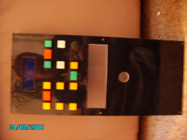

    I actually found an old 260 vmc front panel, in one of my bits boxes.
    Switches with lights, are you drooling yet
    :surprised:----:cry: erm.....:nope:or whats it like then? LOL
    i2i's Avatar
    i'll take a pic tomorrow and post it up
    i2i's Avatar
    I've just looked back through this thread, and it's the same as your original front panel.
    Thanks to the Mod for the translation.
