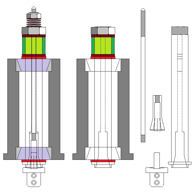

    Ok, so to begin with ive jotted an idea down in paint, there are no dimentions at the moment as i will have to base any measurements on the toolholder and the type of collets, im hoping you will all help me design this little addition with input such as bearing type tool holder type and collet type (not too expensive) the drawing is just a basic concept..
    So chirp in if you have any input :idea:

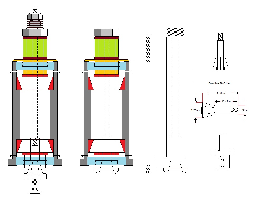

  10. #340
    Ok after a few PM's :whistling:Ive taken on some suggestions to the design like the addition of oil seals in front of the taper bearings and an oil gallery possibly for pumped cooling, and the addition of R8 collet dimentions, so any more input would be very usefull IE bearing type, coolant type, tool holder size and the such...:question:
