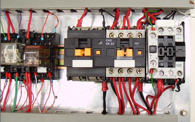

  9. #29
    Maybe i should have uploaded this one first but here it is anyhow (missing 1 driver that im examining)
    Oooo The Electrics.:surprised: :naughty:
