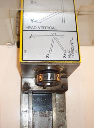

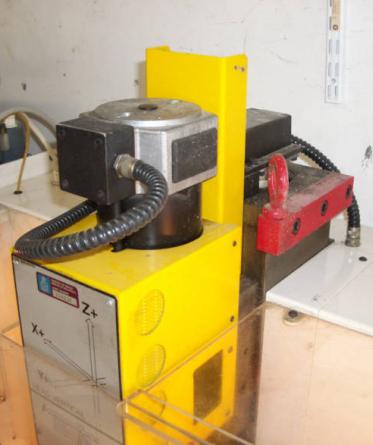

    We don't want to see the computer,Rick...we want to see the machine itself,so some more pics please of the heart of the machine.:wave:
    By the way that computer belongs to Noah. :heehee:
  10. #40
    Quote Originally Posted by GeorgeD View Post
    Ok here they are then...
ID:	2504 Click image for larger version.
ID:	2507 Click image for larger version.
ID:	2502 Click image for larger version.
ID:	2505Click image for larger version.
ID:	2506 Click image for larger version.
ID:	2503 Thats the outside done.
