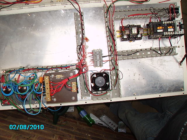

    Ok thats the rubbish yanked out!!

    :cry:
    Thats the progress to date, New stuff arriving any day now. The speed controller and the rack with the drivers in it have only been removed temporarily while I get the wiring sorted and to allow me to mount the new breakout board when it arrives..

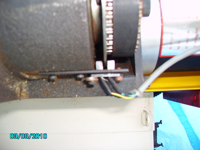

    Ive started to design the control panel to replace the old tatty one ive taken off and it occured to me that i would like a tacho on for the spindle, after spending a couple of hours searching the net i came up with the Trexon Tachulator from MKC Tools however they are on a summer break so thats a no go besides which coming from america it takes an age, so back to the drawing board.. So im not trying to re-invent the wheel here i just want to buy a board similar to the Trexon.. but guess what i just cant seem to find one so any sugestions here?
    Rick
  5. lots of ways to do that.... what do you have to monitor the spindle speed? an index pulse or just a control voltage?
  6. #46
    On the top of the spindle there is a metal plate with 50 holes around the edge, and what i suspect is a optical sensor.
  7. can you post a pic of it... and the sensor? That should make it easier...
  8. #48
    Irving, your wish is my command.....
    And here is one taken the other way.
    Does this help?
  9. #49
    Yep,thats a RPM timing sensor.
  10. Quote Originally Posted by Ricardoco View Post
    Does this help?
    Yes. with that number of holes was probably used for closed loop spindle speed control rather than just speed measuring. Have you retained the spindle speed controller and do you plan to reuse it? Even at this age it would have been 0 - 8v or 0 - 10v control signal and MACH3 can drive that through a suitable speed interface and that might be a lot easier than finding a suitable replacement speed controller. Any idea what the max spindle speed might be?
