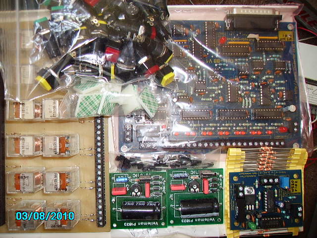

    Oh cool the postman has just dropped of some goodies for my collection
    12 Relay board DPDT...made by me
    27 Switches SPST latching and non latching...fleabay
    2 x 0-27vdc power supply boards...maplin
    Motor Speed interface for mach...cncdoctor
    Opto breakout board...cncdoctor
    Standard breakboard...from the shed
    50 x bc547 transistors ....fleabay
    100 3k3 resistors..... fleabay
    100 bi-colour LED's...from shed
    100 Chrome LED panel mounts... from shed
    and so it begins........
