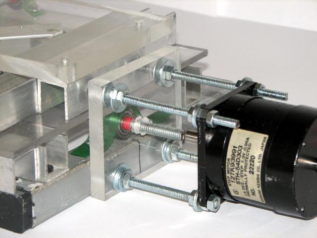

    I havnt purchased one yet because I wanted peoples views on it before I possibly wasted my money. With regards to mounts for the motors I couldn't see any pre drilled holes in the frame so I assumed I would have to find my own way of mounting them? Perhaps threaded rod and some bolts??
    Right o.k. Yes there are pre-tapped holes there. I think i know what you mean with thr threaded bar. Maybe an m5x70mm allen bolt and use a bit of pvc pipe for structure strength.
    We'll figure it out, i'm sure. Probably post a few pictures if anyone was interested.
    Quote Originally Posted by WollyUK View Post
    I would be interested to know how you get on as I like the price of this machine but not the various opinions I have been hearing. Here is a pic of a mounted motor that I saw. Please bear in mind I know nothing about CNC machines and there construction, its only something ive seen.
