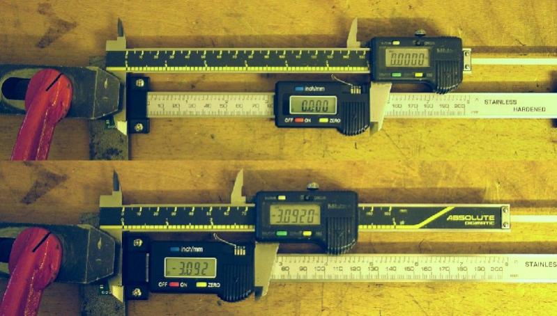

    Can you explain 'cheap Chinese scales' further and how you plan to use them... I assume in place of encoders on the leadscrews? I was thinking on the lines of hacking apart a couple of cheap 200mm digital vernier units - that would give 0.01mm resolution (.0004thou), were you thinking along the same lines? If so, have you opened up one yet to see whats inside?
    The cheap chinese digital scale resolves 20480 lines per inch but it's hard to get the jitter down to less than 3 counts. I simply dump the bottom two bits and accept a stable 5120 counts per inch (approx .005mm res). Don't forget to clean the grit out if you buy one :D
    It's 2x24 bit two's compliment, here's a link...
    http://www.yadro.de/digital-scale/protocol.html

    Thanks for that. Do you have a link to the 'scales' themselves? I was thinking on the the lines of creating a DRO for the lathe initially, then possibly CNC-ing it later but was being put off by the high prices charged for DROs generally. I have the means to write the software for myself and plenty of hardware available.

    I shopped around then bought my scales from Allendale
    http://www.allendale-hosting.co.uk/
    I made the mistake of buying a vertical mount scale for the Z axis, found you can't turn the display on without resetting the whole thing, I thought this might turn out to be a pain when testing so I dumped it.
    Allendale also do pretty anodized aluminium covers for scales. Means you can't see the display but does make them drip proof. The end mounts for the scales are a bit naff in pressed steel, so I remade them in aluminium.
    OTOH they do work...
