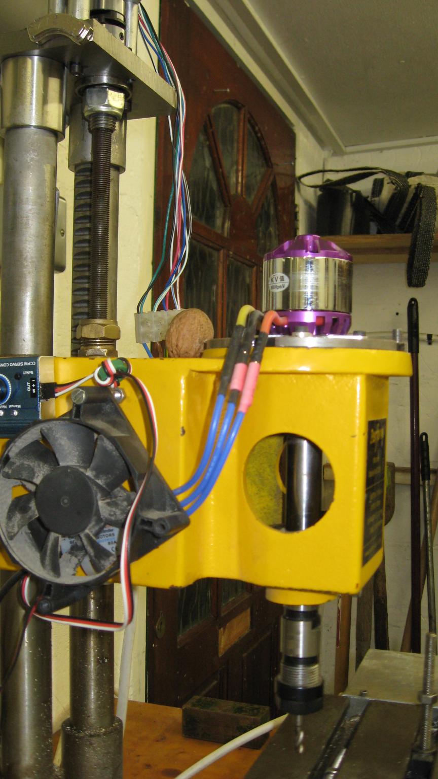

    Hi Mark just read ball the thread,very interesting I use a 650kv outrunnnermotor on a mill with a 80 amp speed controller, servo tester and a 15volt psu supplly. I have run it on mach3 to cut some small bearing pockets taking a 1mm cut with a 6mm cutter Ihave not had any problems with heat build up. I have fitted a fan on top of the speed controller bolted to the main frame of the mill.

    Hi Mark just read all the thread
    hahaha!!! that must have took some doing :)
    i dont have any heat trouble with the larger two motors, its the tiny 4000kv spindle thats giving the bearings im using a hard time m250cnc(phil) thinks it may help if i run them in bit by bit not alowing them to over heat or trying lighter grease, ill give those a try when i find the time
    thank god somone has a rc brushless motor spindle working for them, loads of people seem to have a go at building them but iv had no reports of any useful results untill yours, are you running it 1:1 or are you on pullys and belts??

    Hi Mark I use a Arceuro ER16 which is 1:1, the motor is actualy a 800kv have loaded a photo

    Splendid!!! 1000w (ish) ??
    i might need to fit a fan to my esc, it gets to hot to touch now and again
    are you not finding the 800kv a bit quick to cut aluminium?
  10. #140
    f750's Avatar
    Lives in herne bay, United Kingdom. Last Activity: 21-11-2022 Has been a member for 9-10 years. Has a total post count of 13. Received thanks 1 times, giving thanks to others 0 times.
    I use good quality aluminium and spray a small amount of WD40 to lubricate.
