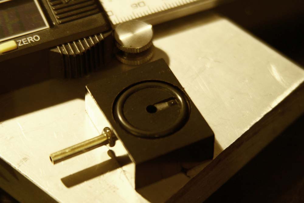

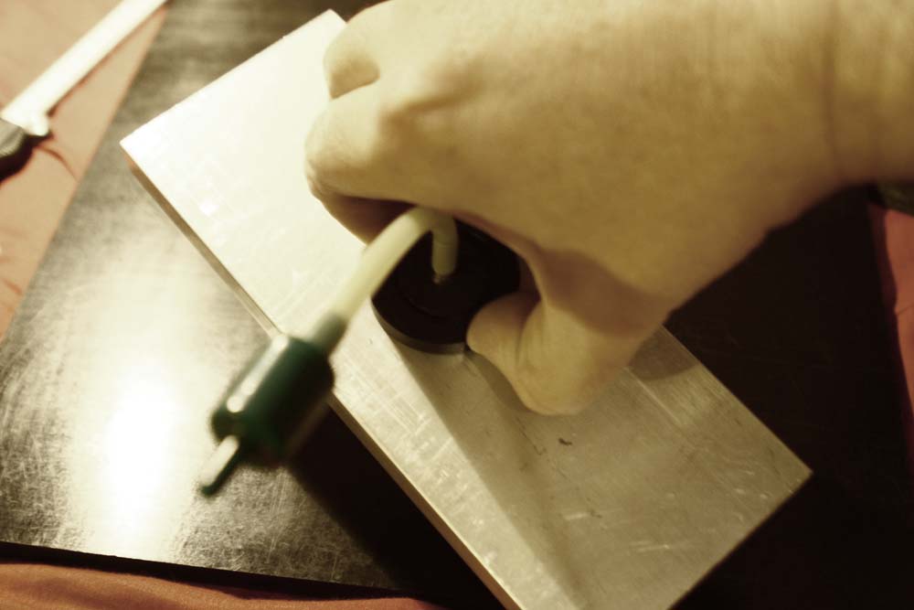

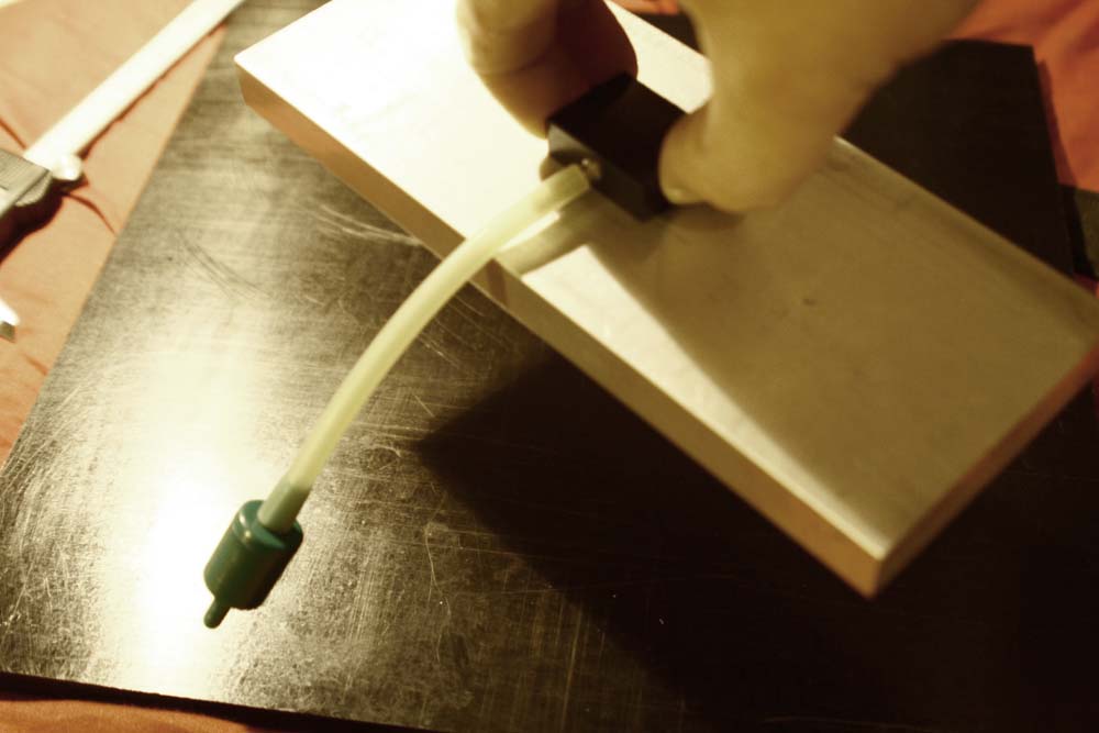

    You could stick a sheet of whatever plastic you're using down to the bed and mill slots/holes for the air

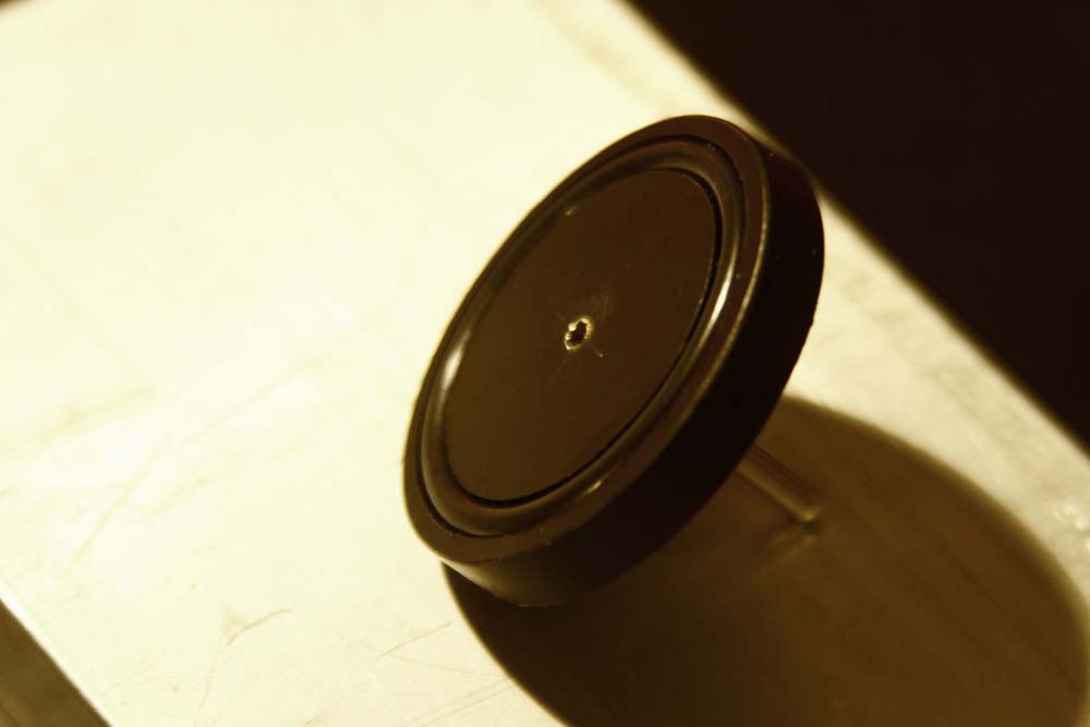

    iv considered it for long runs, might be a pain to get the holes routed to each o-ring if its a complex pattern
    the problem with mixing diffrent size o-rings is the diffrent surface arias would compress the o-rings diffrent amounts

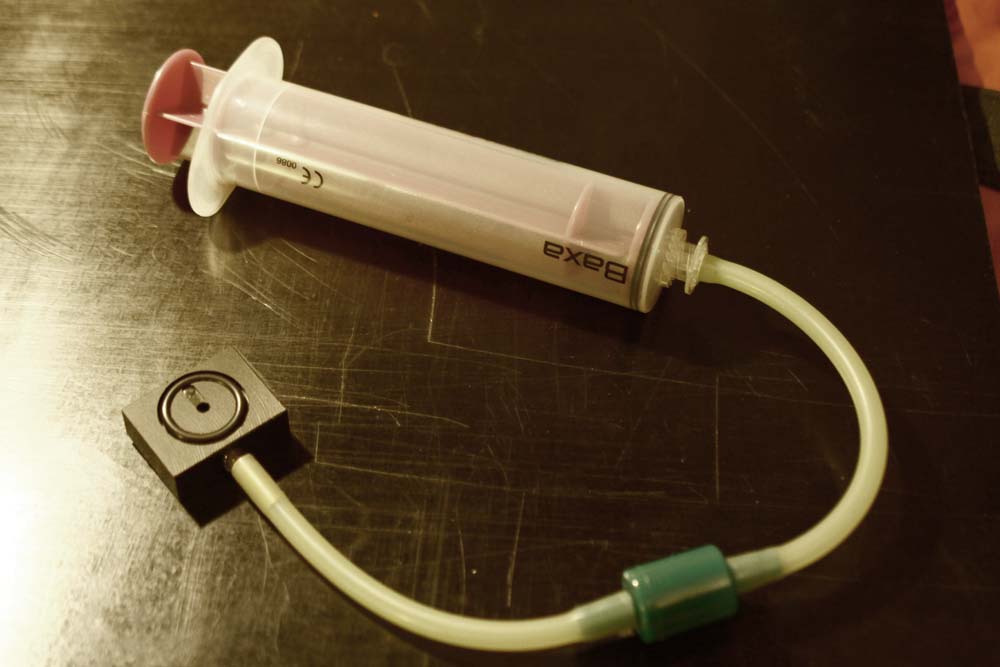

    With a sufficiently big syringe how many pads do you think could be served? Or are you sucking the air out of one at a time and swapping the syringe round?
    im going to try using one syringe and fix one of the one way valves as an exsaust so you could pull the initial vacuum the pad valves will hold the vacuum ill press the syringe home and the air iv removed from the pads will be routed through the exsaust one way valve ?????? if you can get your head around that :)
    i need to do a drawing to show you what i mean.... imagine you have two one way valves attached to the end of the syringe, youll work it out :)
    am i sending you a large syringe ? (iv got a few from work)
    Oh, two valves ... you're using the syringe as a pump!
    If you could send me a syringe that would be great, I've not got any that seal any more - found out they don't like concentrated sulfuric acid. I can papal you something for it.
    I had better buy some valves and tube. What diameter are you using?
    dont worry about it man, work was scrapping old stock so i didnt pay anything myself :)
    they dont like WD40 either
    i didnt manage to get much of the surgical tubing, i need to buy some more myself, it looks like 1.5 or 2mm ID and the brass tubing is 3mm
    i just used what i had lying around, if i was buying id go for the smallest diameter i could get

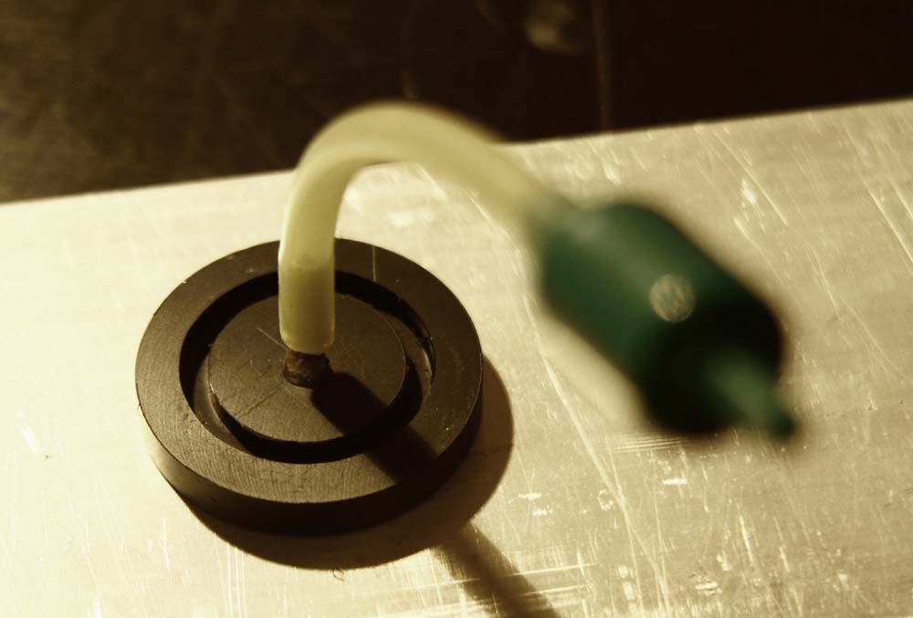

    Ps: the only reason you would need to use the syringe like a pump is if it failed to seal on the first draw, it would save you having to remove the syringe and start again, im pretty sure you could pull a pretty good vacuum on 4 double sided pads all in one stroke
    the 30mm pad held onto a un-polished block of alli for hours without the need for a top up, id top up every now and again if it was on the cnc though :)

    Just a note to say that the different size O-rings should all compress the same amount as long as they are all the of the same thickness, therein lies the problem getting the same thickness in different diameters.
    Peter
    Quote Originally Posted by ptjw7uk View Post
    sounds to good to be true, ill have to do some maths, iv got plenty of o-rings from 18mm ID to 50mm ID and they are all 3.5mm section
    Your right it is to good to be true, must have been asleeop when I did the calcs!!
    Peter
    Darn it ! never mind, it would have been nice :)
