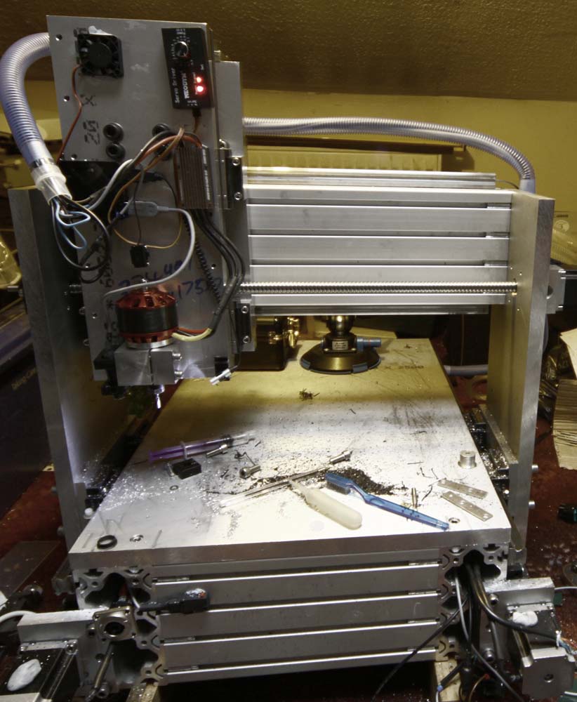

    its a bit scruffy at the mo but it is working well :)

    iv been looking at ways of clamping work to the bed without drilling and taping hundreds of blind holes that will inevatably clog with shit
    im thinking i will drill and tap some choice holes as and when things develop
    i may have a job with a hundred or so small control panles to engrave so iv been looking at ways to clamp easily and with repeatability

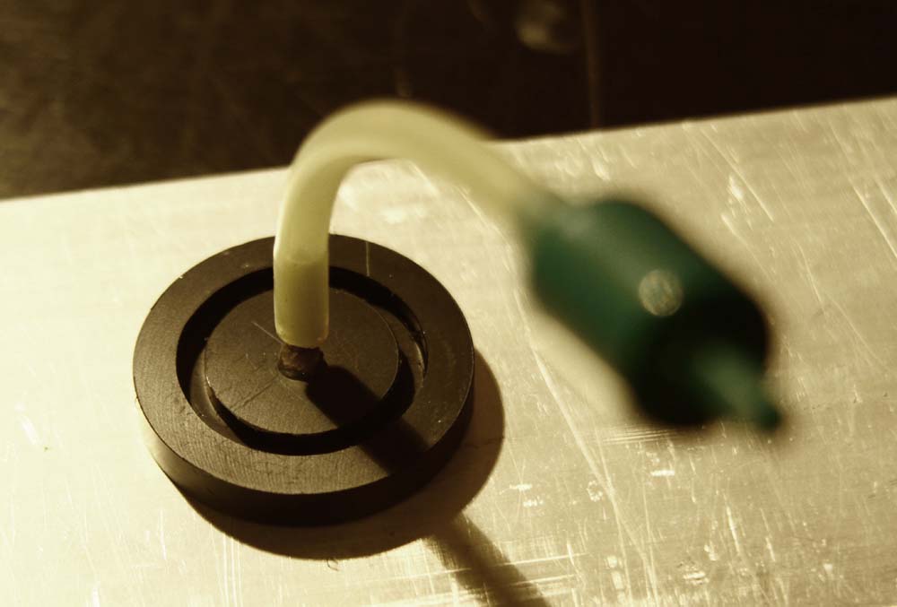

    20mm o/d o-ring with 0.34mm protruding above face

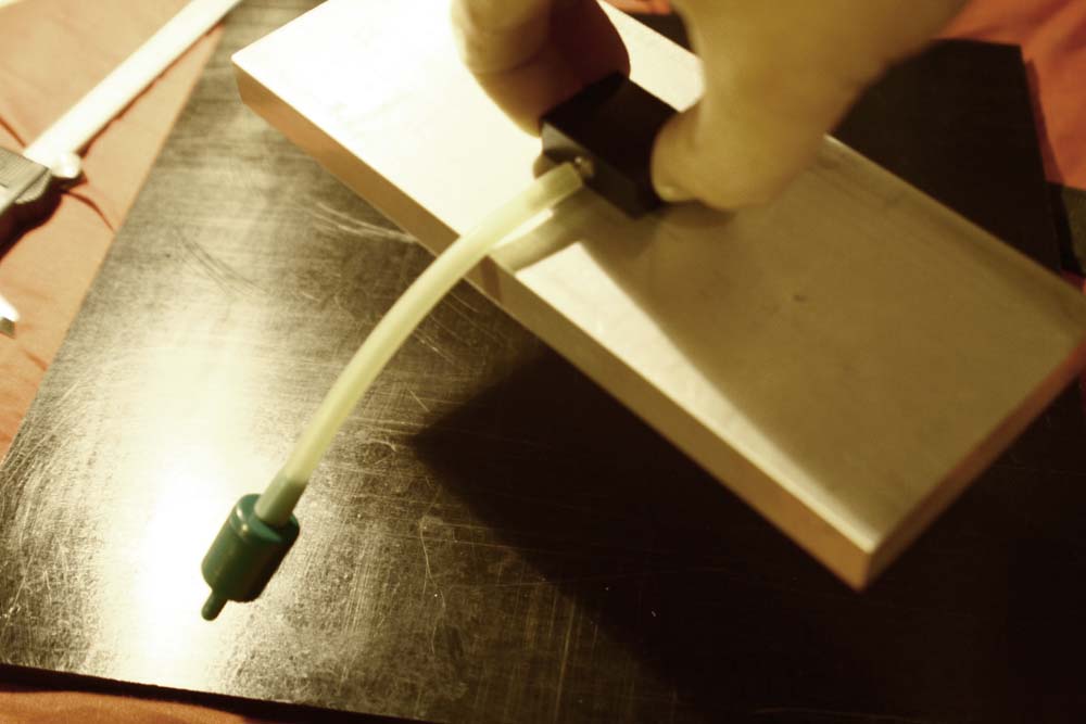

    one way valve
    one way valve holding the vacuum,, at 20mm O/D it only just holds onto this alli plate

    takes quite a bit of effort to get this one to pull off
    i left it stuck there like that for an hour and i had to give it a good pull to get it off, i wouldnt trust it to hold while on the cnc but it gives a good indication of how well the valve holds the vacuum
    very simple and cheap to make in any size , im looking at machining both sides and just placing them between my bed and work peice out of the way of the cut
    once iv proven the cocept i may use a peristatic pump (nice and quiet) to pull the vacuum
    iv also orderd some transparent valves so i can see which modules are failing to seal
    cant see it not working at least for engraving :)
