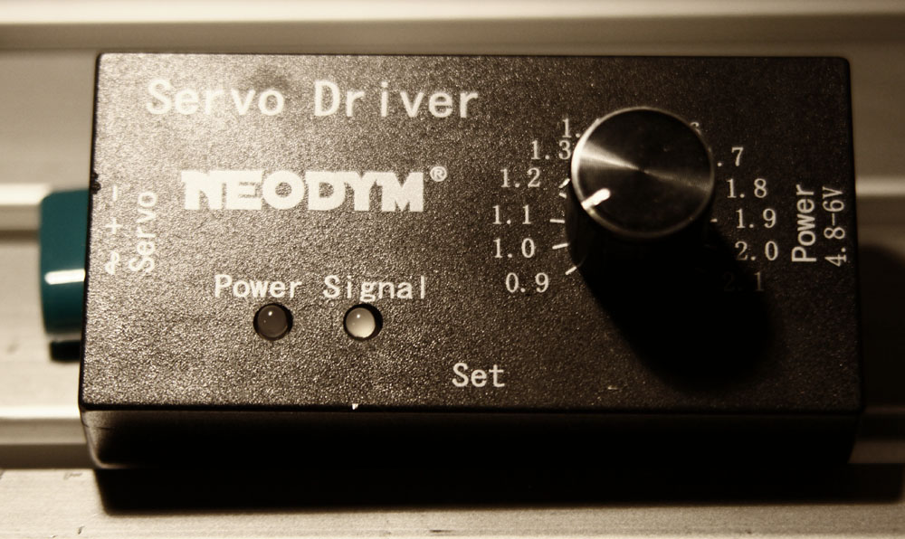

    Yes modifying the servo tester is a good way of doing it. The problem is we'd need no know what the pot is connected to first..i.e the circuit diagram of the servo tester. I don't have any servo testers so I can't really help there yet.
    The servo tester could be as simple as the one here:
    http://pcbheaven.com/wikipages/How_RC_Servos_Works/
    (There's some good info there on how servo signals work. It's the same for the ESC so worth reading.)
    In which case you can't easily change the pot.

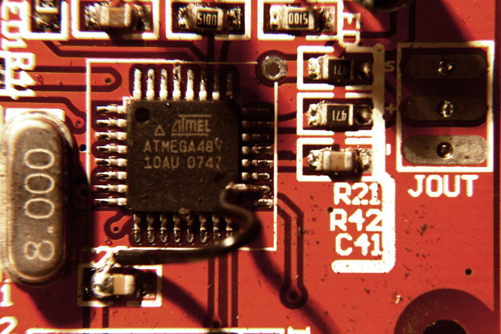

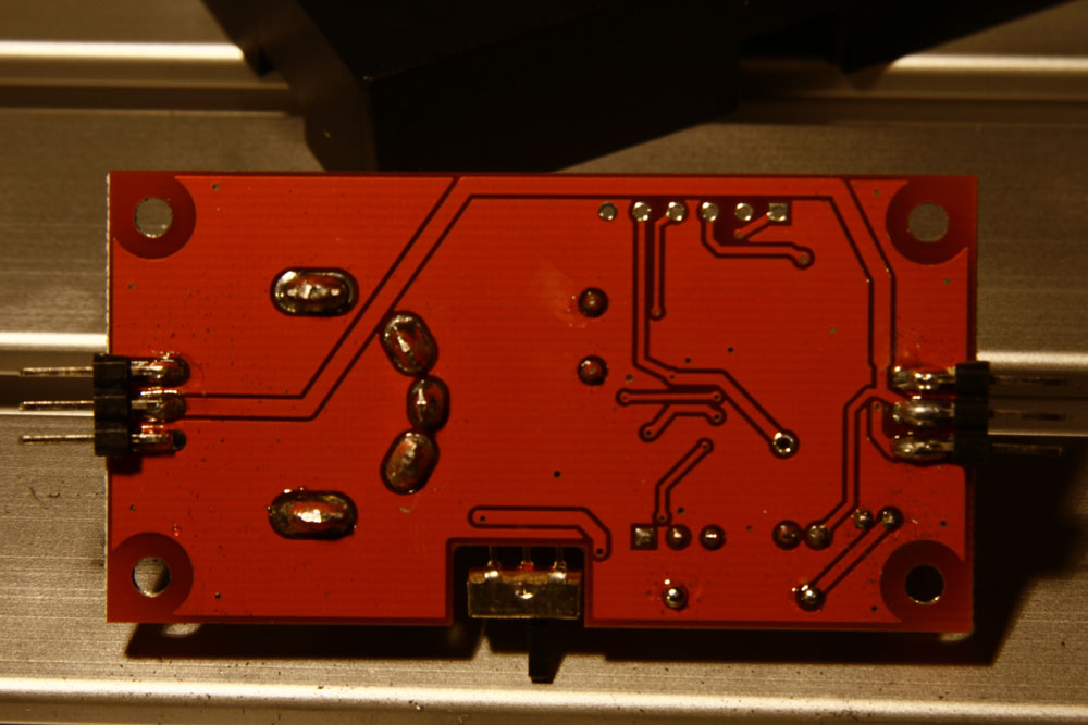

    Maybe open up your servo tester and take a picture...

    dont know if you will make any sense out of these... its just a magic box to me

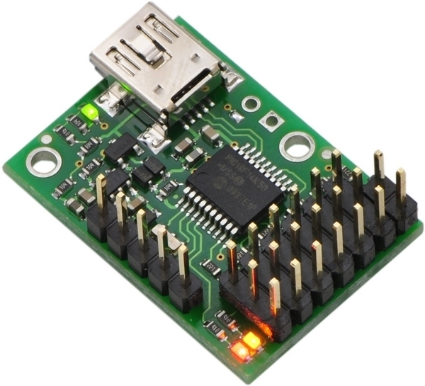

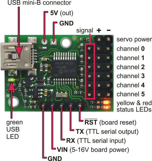

    iv just orderd a "MICRO MAESTRO 6-CH USB SERVO CONTROLLER ASSEMBLED" £12 ebay
    im not sure if it will solve our mach spindle problem but i thought id give it a punt

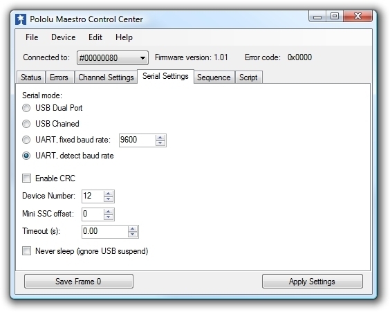

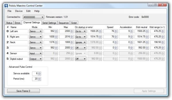

    im hoping mach will know what to do with it :question:

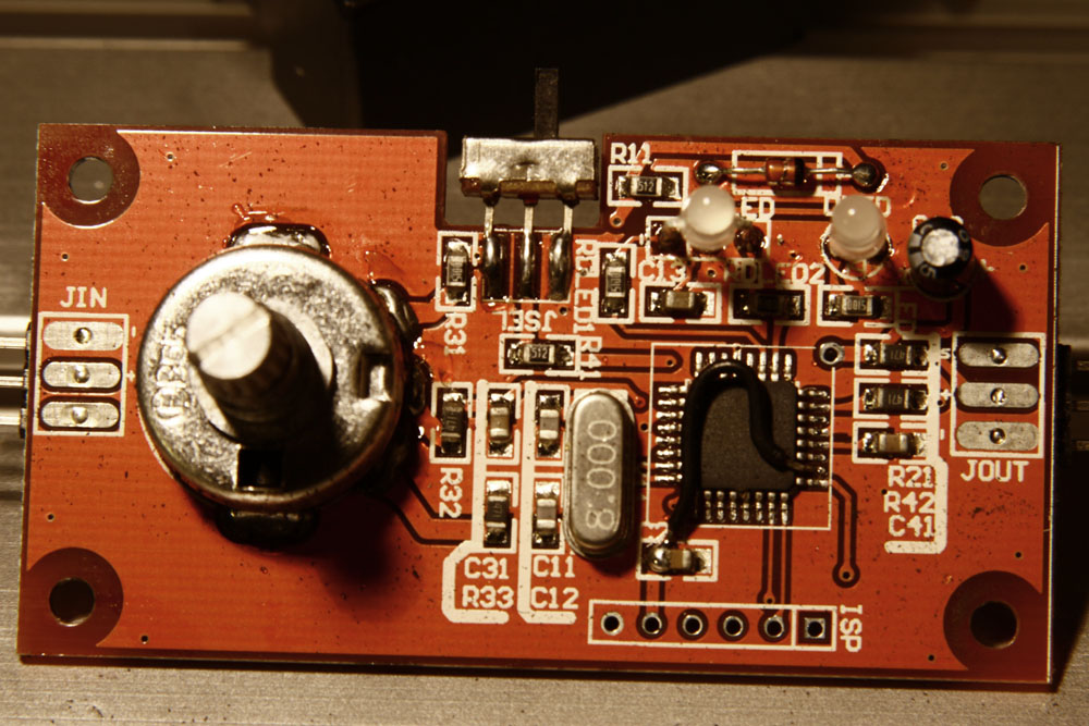

    I don't think mach3 will interface with the thing you've bought, not without a lot of effort. I might be wrong though. You could just run it in the background and adjust it manually on the computer anyway?
    Servo tester, still trying to trace the PCB. I think it'll work with the parallel port...
  5. #85
    Ok disregard that, just had another look. It should be simple to get the servo tester connected.
    :idea: Here's a step by step guide.
    1. Remove the potentiometer, or just desolder the pin connected to R32.
    2. Solder a wire to the pin of R32 that was connected to the potentiometer.
    3. Connect the other end of that wire to the chosen output pin on the parallel port...say pin 14.
    4. Solder a wire to the negative of the circuit board, e.g. pin labled '-' on connector JIN, and connect it to any ground pin on the parallel port.
    5. Set PWM frequency in mach3 to something high, like 1000.
    6. Under Config-->Spindle Pulleys set max speed to the max RPM of your motor.
    7. Cross fingers...it should work as normal with the rpm show in mach3 corresponding correctly.
  6. #86
    Hmm, before you do that measure the voltage between the pin of R32 that's not connected to the pot and ground whilst twiddling the potentiometer and see what the range is...
    Ooh, is that a programming connector I spy on the PCB! Could be handy for something.
  7. #87
    Disregard steps 1 and 2, that's not safe to do if the parallel port outputs over 5v. Measure the max voltage as I said in the previous post then just desolder the switch and solder the signal output wire from the parallel port to the PCB pin of the switch which was connected to R31. Then adjust the pot untill it gives the same reading for voltage with mach3 at 100% spindle speed as it did with the pot at 100%. Good idea to remove R32 whilst you adjust the voltage, then put it back when you're sure it's right - that guarantees not to break anything. Quite tricky soldering though!

  9. #89
    just for a refrence iv mesured the voltage between both sides of R32 with the resistor still in place
    0.24v both sides 0 speed
    3v both sides flat out
    thats with 5.57v coming in from the ESC battery eliminator
  10. #90
    iv orderd one exsactly the same for you to experiment with (if you agree) , PM me your address and ill send it over to you once it turns up here.
    if you manage to solve the issue then let me know how you did it and we'll call it even
    That sounds like a good plan :) I've sent the PM. I'll work it all out properly and take some photos of what I do when I get it.
    If that voltage is 3v max then we can use the existing potentiometer to scale the voltage from your parallel port to be the same.
