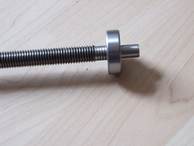

    Its only for the rear spindle inserts for a couple of different sized longish bars to stop the whiplash.
    Just turned this threaded rod down from 12mm to 10mm for the bearing,chuffed I am... don't want to push it on all the way just yet as the end bit needs a screwthread on it tolockthe bearing in place,mind you it doesn't really need it as the bearing is a tight fit.
    Forgotto say,this is stainless steel.
