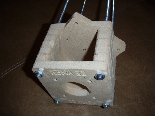

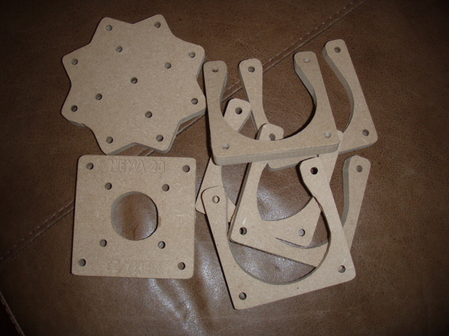

    For sale on ebay. A new improved design over what my router is currently running. Helpful for new builds (I found the motor mounts on my build very fiddly with few tools to help me).

    Comments / feedback welcome. Also, if you've got any ideas for similar components you need to help you out, let me know.

    might just be me but it looks like you loosing steps or calibration need looking at or it could just be the picture
    like the design those spacers are a good idea makes adjustmet easy
    Tom's Avatar
    Yeah, you're not wrong - there are a couple of things I'm planning to improve on this machine. All fixed this week, and none affect the function of this part.
    Backlash in X (causes poor text resolution)
    Gantry flexibility parallel to Y (causes the wavy edge on X direction cuts)
    Z not quite normal to the table (causes the "stepped" appearance to the cuts, where each pass is visible separately)
    Cheers for the feedback! :)
