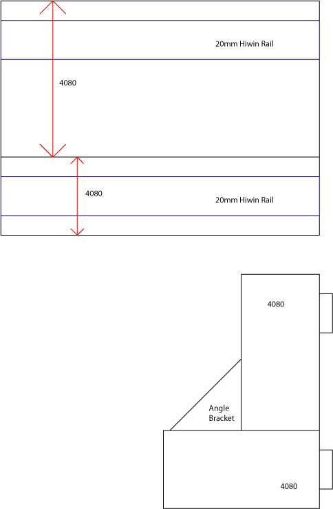

    I had some time at work to mess around. Ok it only shows three components but its a start! This is the x-axis I was going to make out of 4080 extrusion. Fixed together in a L shape with the rails on the top and bottom. Will this be strong enough over approx 1200mm or should the extrusion be bigger. Also when the bearing blocks are fitted, do I build off the blocks to account for the ballscrew between the rails, or should I mount it behind and build the z-axis to sit acutally over?
    If I fixed the aluminium plate or extrusion for the z-axis to the bearing blocks it would sit quite close to the x-axis.

  10. Its not a question of strength... that'll hold quite a weight... its a question of rigidity... how much will it deflect, vertically and horizontally, in the middle under load?
    In the catalogues you will find design tables which shows how a particular type of extrusion will deflect and that will give you a clue. If you look at page 49 of the Hepco catalog they give the formulae (use the simply supported arrangement as a worst case) and page 50 the parameters for their 80x40. If you work the math it suggests a deflection of 0.00084mm in the 80mm direction (vertically) and .003mm in the 40mm direction (horizontally) for each Newton of load for a 1200mm length. (someone check these, they seem a tad low)
    Your 'L' structure is slightly more complex. The vertical deflection is inversely proportional to 0.5 * w * h^3, where h is 120 and w = somewhere between 40 and 80 (I'll hazard a guess the effective value is around 55). So if a simple 40w 80h deflects X vertically, your complex beam will deflect less, roughly 25% of that. Similarly in the horizontal the ratio is roughly 30%... these are very much rough and ready, others (Ross, routercnc, et al) can do the more detailed analysis... and tell me I am wrong!
    Typically the horizontal load for a wood router is due to cutting forces and 5 - 10N would be a good allowance, giving a deflection of roughly 0.003 * 30% * 10 or 0.01mm horizontally. Vertically you have the weight of the z-axis and the router/spindle - that could easily weigh 5 - 6kg or 50 - 60N, so a deflection of .0008mm * 25% * 60 or 0.012mm in the centre of a 1200mm run.
    Incidentally the deflections for a piece of 80w x 120h would be .003mm horizontally and .008mm vertically, better but at the expense of added weight.
