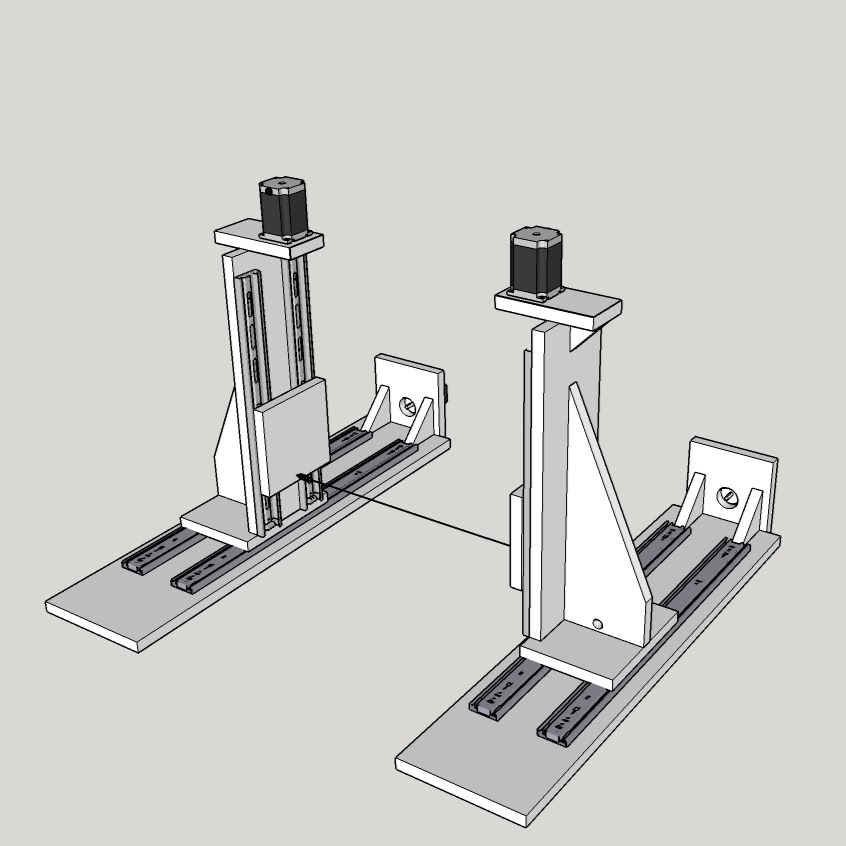

  2. Hi Bobc
    Wire will be tensioned by spring to allow for the x axis on both towers to move interdependently for cutting tapered wings. I'm testing out different software but profili2 pro has 4 axis for foam cutters and foamworks generates the gcode as well.
    post some more pics up soon when I have it cutting some foam
    Keith

  6. I've added a lot of details to my build including plans, instructions and parts/cutting lists all at my website www.rckeith.co.uk . I've have a video almost ready that should be up in a few days on using Profili Pro 2 for cutting foam wings which I'll then follow up with one on Dev Fus Foam. I've used these to produce a 50 inch Wing span Hawker Hurricane. A few images below. Not finished yet because of other stuff getting in the way. I'm now looking to build a CNC router probably a Openbuilds OX but also may try and build Mark Carew's Phlatprinter this seem ideal for producing foam models. I like the fact its fairly compact and can produce large parts.
