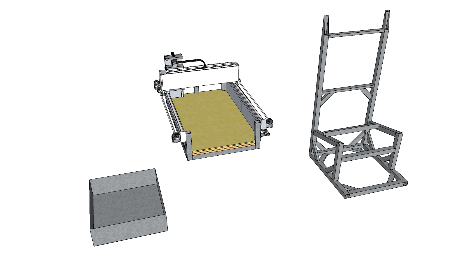

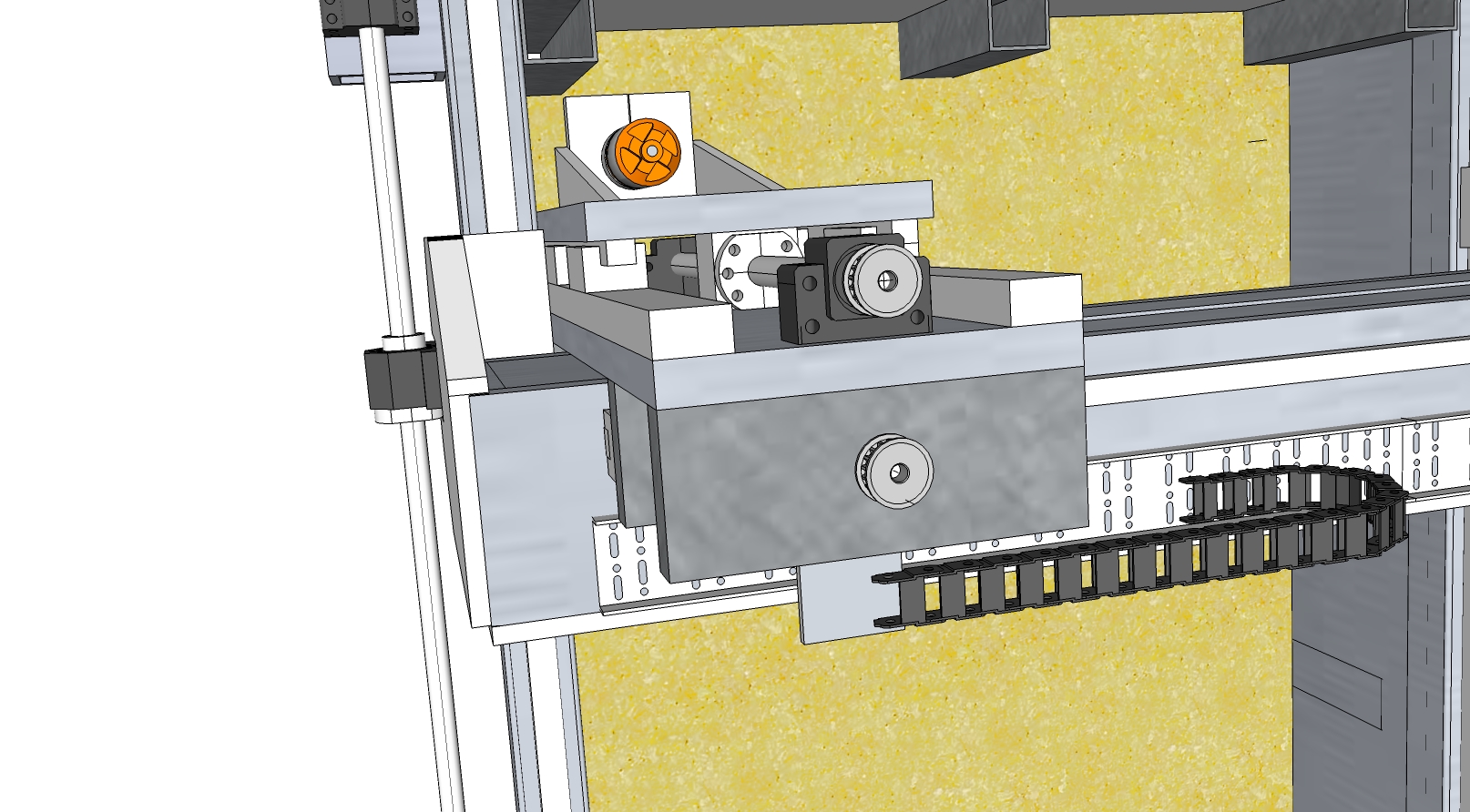

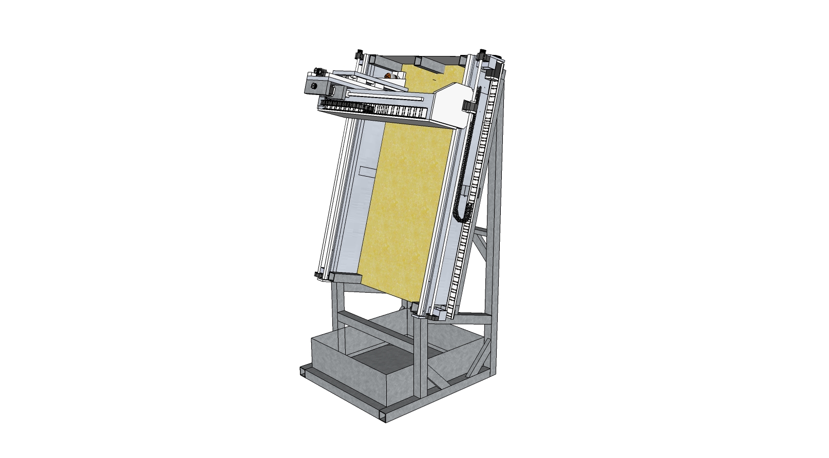

    Just swapped the supported round rail for linear rails and also turned the Z axis 180° so the chips will not collect on the ballscrew or mount. I've also dropped the Z axis stepper behind the upright and it will be connected by belt (1605 with 1:1 connection to the stepper) It will have a cover over/round it and I'll look at making a cover for the rest of the Z axis. I've now gained 50mm of Z travel so total travel now 200mm. For the Z axis rail mounts I've had to raise them on some 20mm plate strips to get the 1605 ballscrew in there. Will have to make a low profile mount but that's the least of my worries!
    Changing the X axis to single stepper and belt drive, yet to work out the finer details of supporting/tensioning pulleys.
    Anything that you peeps can see that could do with altering? I've tried to keep most of the plates with straight edges so I can cut them myself. the only ones I've left with curves and machining are the Y axis end plates. I could always make these with straight edges and no machining!
    The actual router frame is removable from the upright frame so that If so wished it can be put on a flat surface if ever required. Also for working on (pouring epoxy resin for levelling the rails for example) it will be easier than trying to tip the whole frame.

  7. #97
    i really like it neil.
    stupid question, and one im sure you have already though about it, but incase you havent, the total height (when on vertical stand) is going to fit in your new shed right? cant remember your total dimensions...
  8. #98
    Thank you!!
    Yes shed is 2.4m at the apex and just over 2m at the sides. This is 1.8m total height....also got double doors so can get it in and out again...

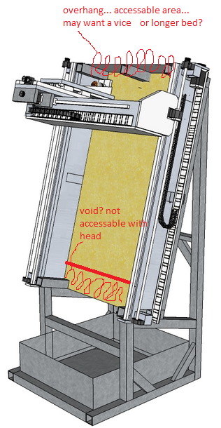

    also... dont get stung like i did initially on the accessable area... remember you have lots of wasted accessable area at the top of your machine... where you could perhaps extend the bed or add a vice etc... and there is a void of unaccesssable space at the bottom...Click image for larger version.

    I was thinking about that earlier. I was going to shorten the bottom and put a vice on but then decided to reverse the Y axis to stop chips from collecting on the ballscrew and bearings. Don't fancy having a vice at the top but might shorten the bed and make provision for a 4th axis.
    The cutting area I was aiming for was 1000mm x 500mm and this just about gives me this so was going to leave as is but you've tempted me to have another look
