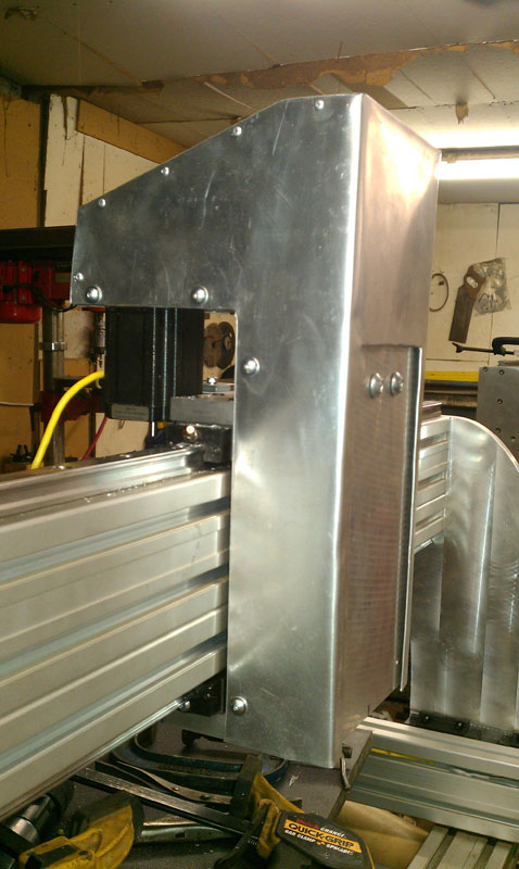

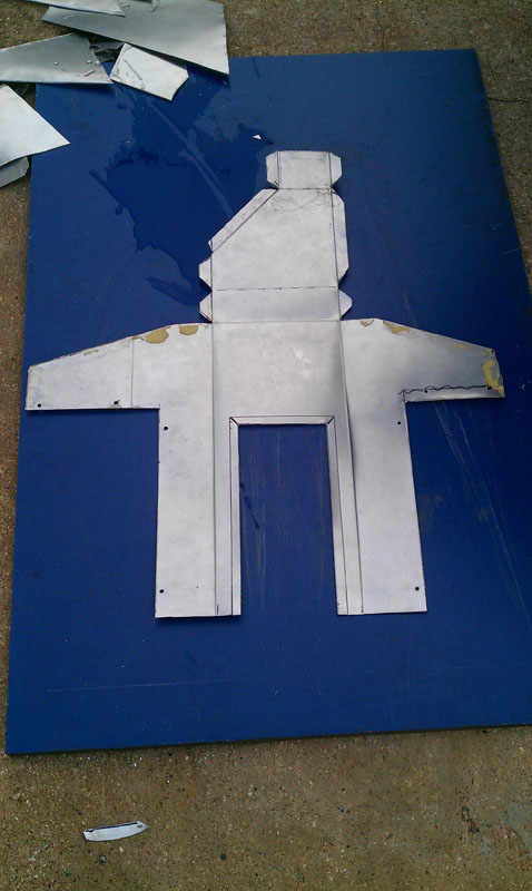

    #4 THE BIG ONE . . .Complete Z axis cover needed FROM THE START. While turning 180deg you have lessened the chip collection points BUT they will get in there and the ONLY way is full cover. They are easy made with thin Ali plate and weigh nothing not the prettiest things but very affective. Something Like this

    Also while turning 180deg helps keep chips off rear of front plate it will also make it very awkward for when your changing tools.? The way you have it When doing jobs with several tools you'll have to lower gantry to reach spindle properly and that will mean leaning over gantry so will be very awkward.

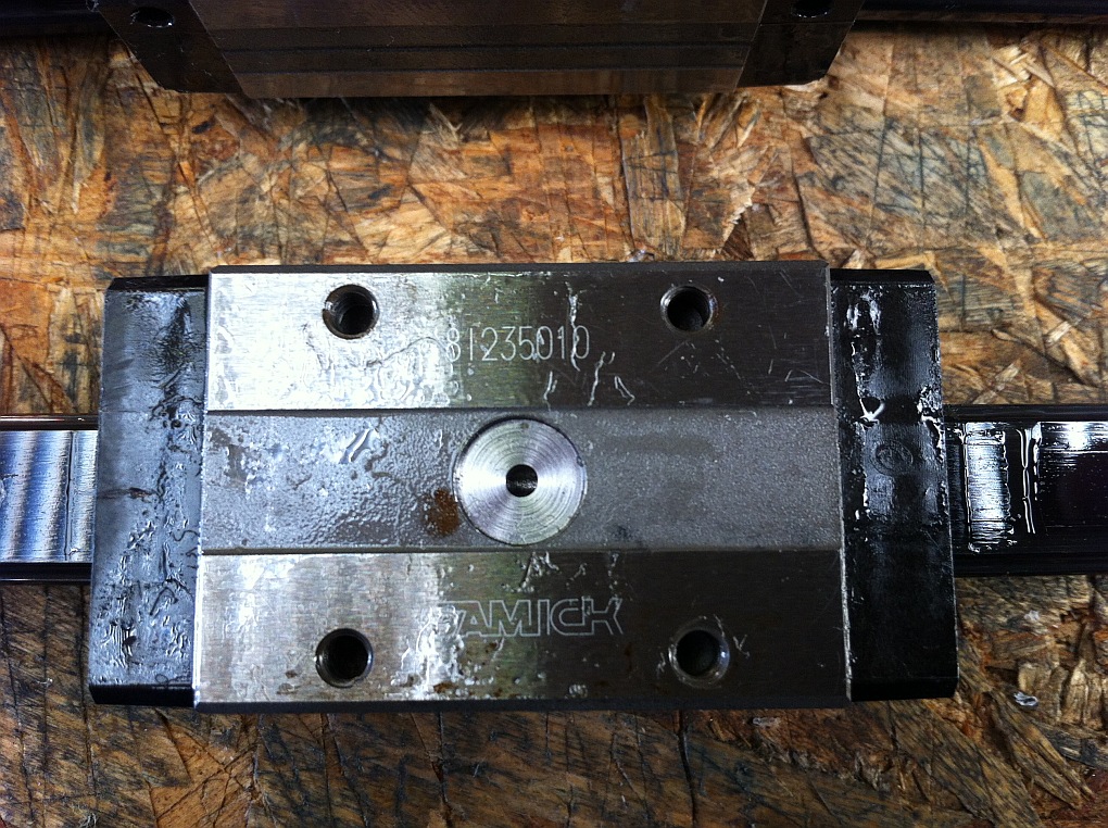

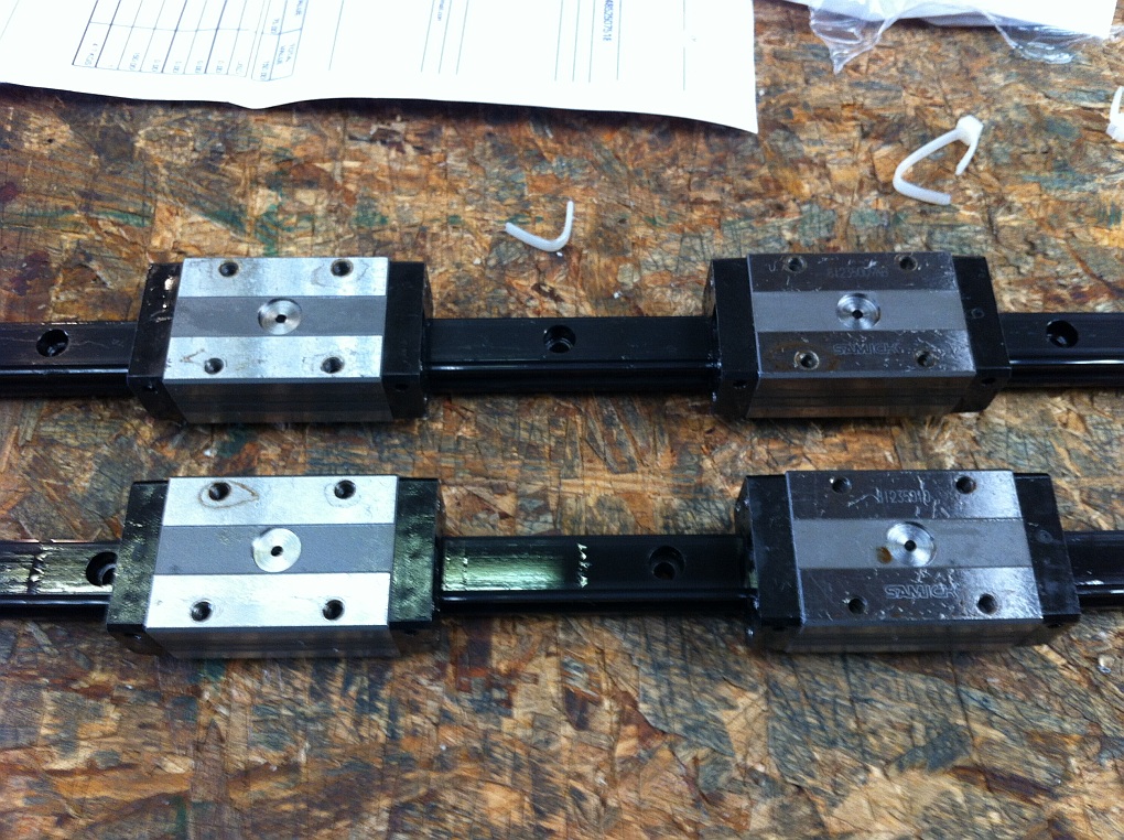

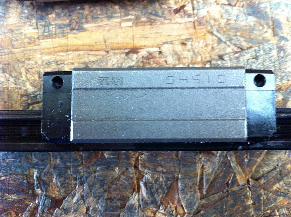

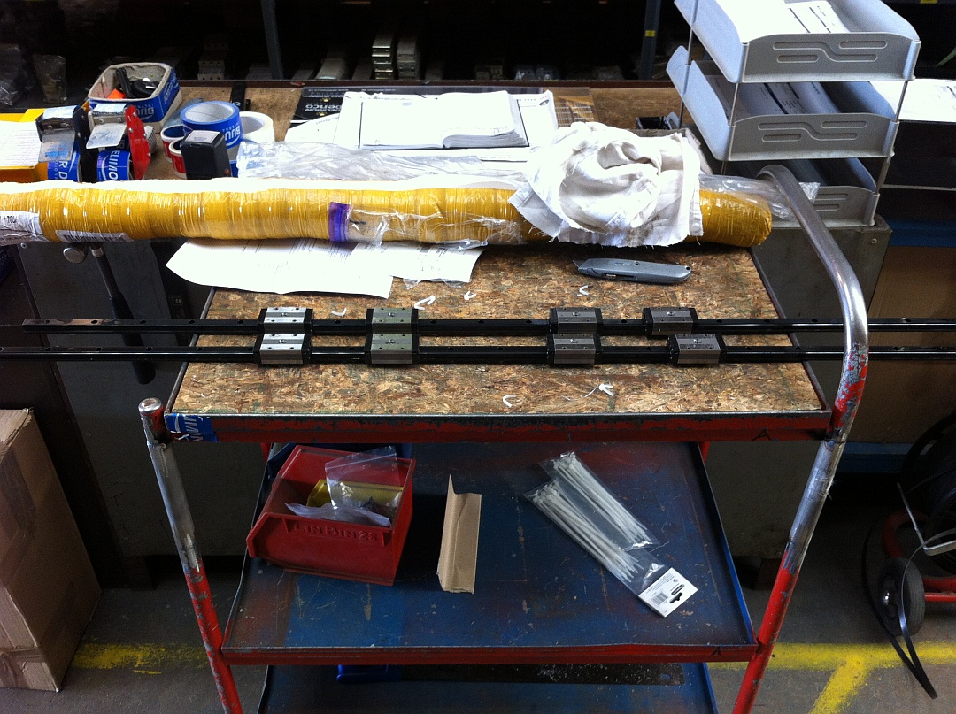

    Ordered one lot of linear rails 1190mm long with 8 blocks on Thursday night, they arrived from Korea today at 8.45am......that's fast...straight through and no stopping at customs (if you know what I mean ) These I'll cut into two lengths, one 750mm long for the Y axis and one 420mm long for the Z axis. Ordered the ballscrews from Chai today so waiting on one more lot of linear rails (1390mm long for X axis) and the ballscrews and then I can start the build in earnest!

    Neil...
