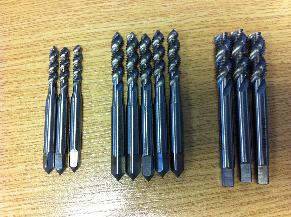

    Just received some spiral flute taps from China so once I've welded up the frame (should have all the parts cut by the end of today as I did all the 50x50x4 box this morning and just have the 50x25 bed supports and bracing angles to cut at lunch!) and got some Ali cut for the gantry I can start drilling and tapping to my hearts content
Name:	Spiral Flute M4-6-8 taps.JPG
    Edit.....yep all steel for the router frame (not support frame) is now cut. Welding starts tomorrow

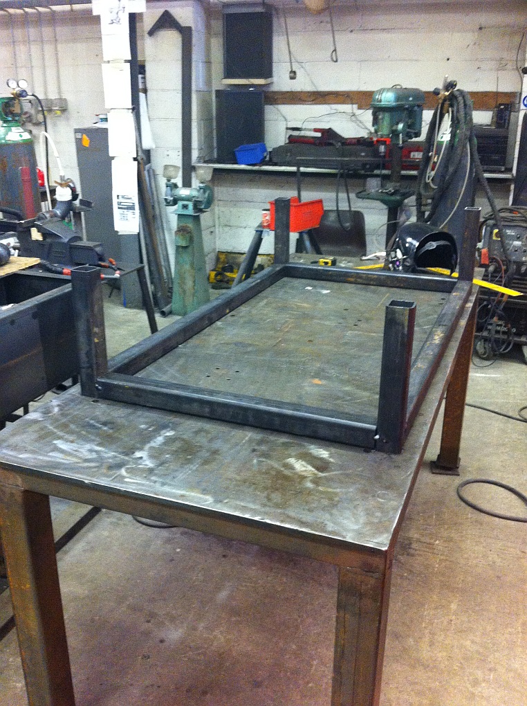

    Managed to spend 1/2hr in the works at lunch tacking the frame up, well most of the time was spent clearing the bench and putting it back after anyhooo....result is below:
    Tomorrow I'll add in the rest of the cross members and if I've got time (I doubt it in the 1/2hr I have available) the braces
    Neil...
    Build log...here

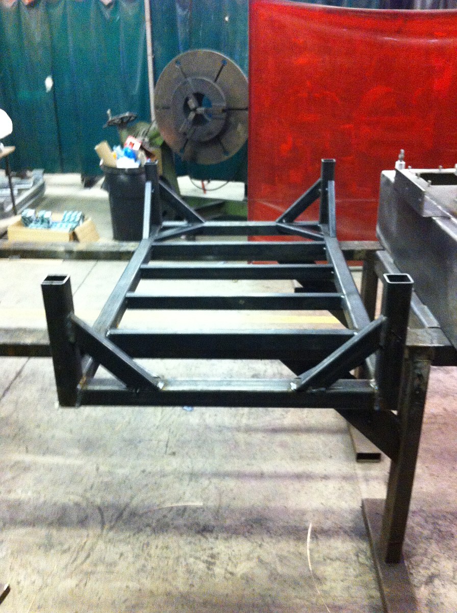

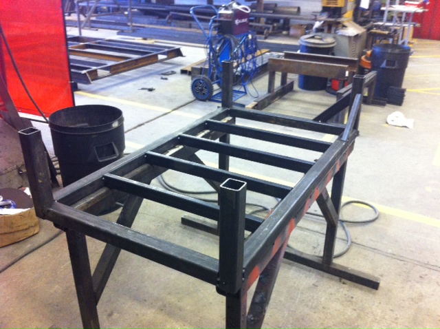

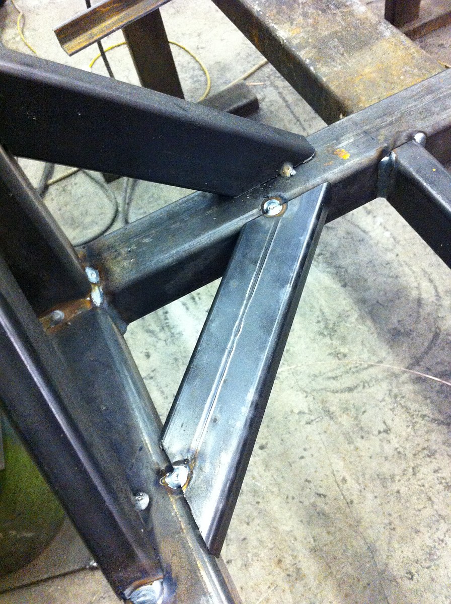

    Todays tacking up....
Name:	Bed braces.JPG
    When putting the first angle brace on an upright I found out that in my haste to cut them I set the angle to 40° not 45°
    I would really like a couple of hours in one stint to go at it, I could then get it all tacked up and squared up ready for welding properly.
