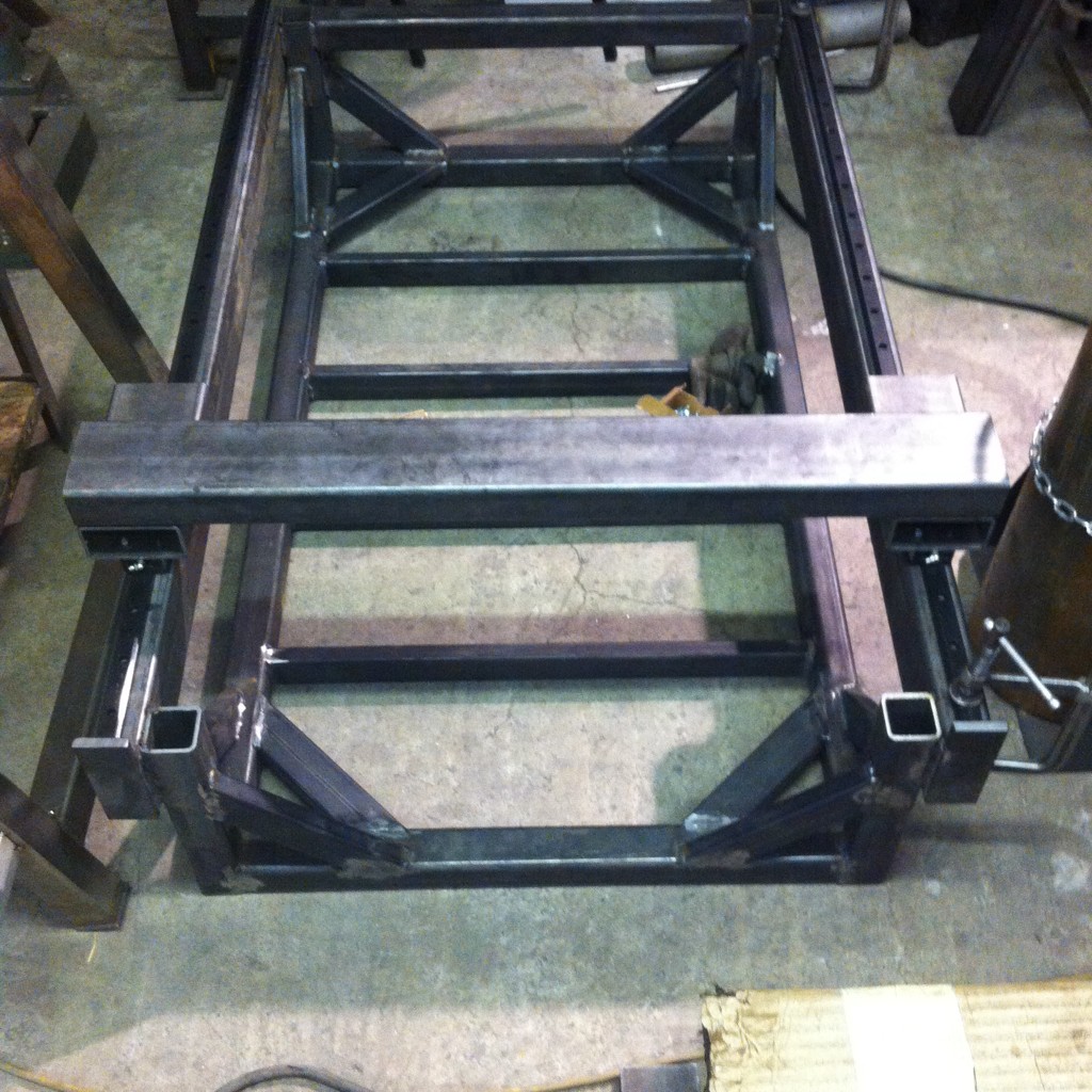

    Well spent the 1/2 hr in lunch marking and drilling the holes for the X axis carriages in the 100x50 box section. Used the 6mm transfer punch and the 60x60 angle that I've already drilled as a template to mark the holes and then the pillar drill to drill them (obviously.)
    I'll probably dummy mount the rails to get an idea of how it will fit together and then mark the L section gantry for drilling the holes and bolt them together for a play....a bit like this...

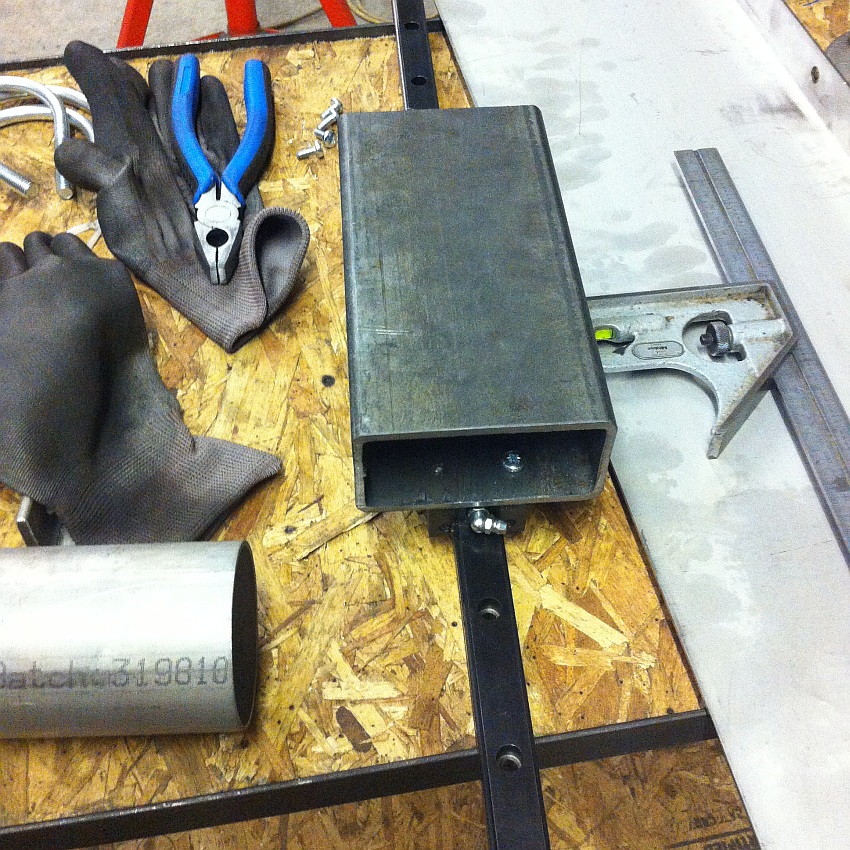

    Today's small advancement....wish I could have a few hours uninterrupted in the workshop to crack on! Anyway I only managed to mark out (wrongly ...what is it, measure twice, cut/drill once??!!) the holes for the bottom section of the gantry and drill them and put the carriage mount pieces on the carriages. Marked out one carriage mount but ran out of time to centre punch and drill.

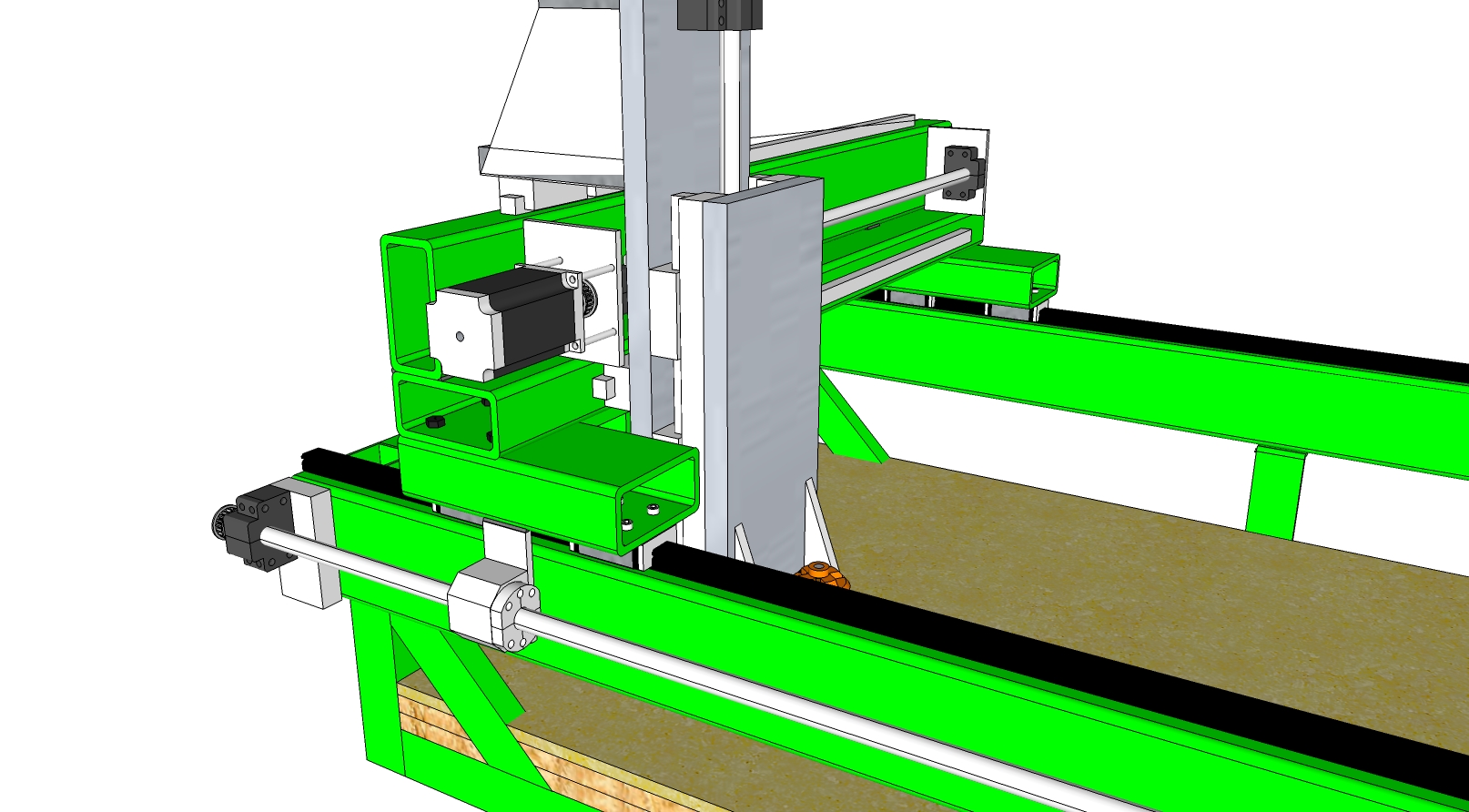

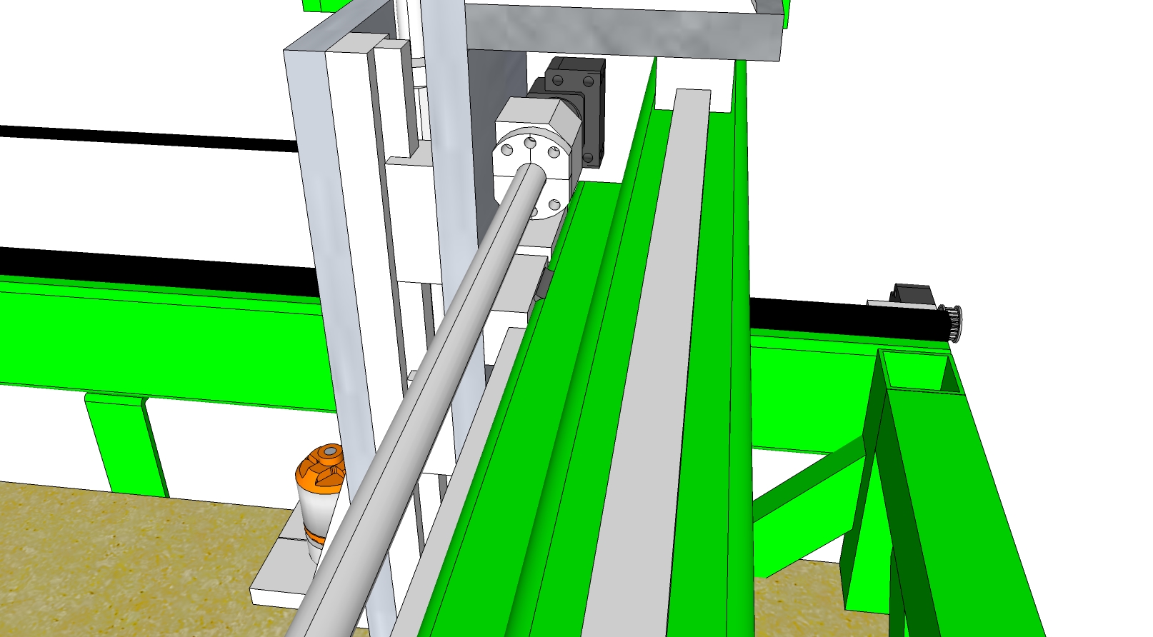

    Looking good Neil. You just have to keep chipping away at it.

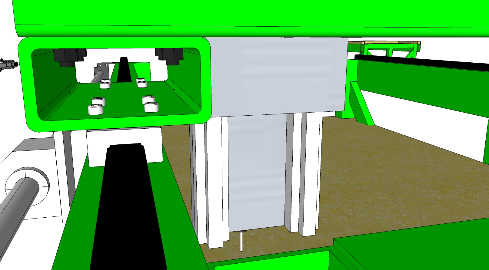

    In post #224 and #221 the Y ballscrew looks like it is some way off the Y axis, dropped down on some spacers. Would it instead fit under the Z stepper motor and attach directly to the trapezoidal shaped plate on the side of the Y axis (i.e. ballscrew on top of the gantry)?

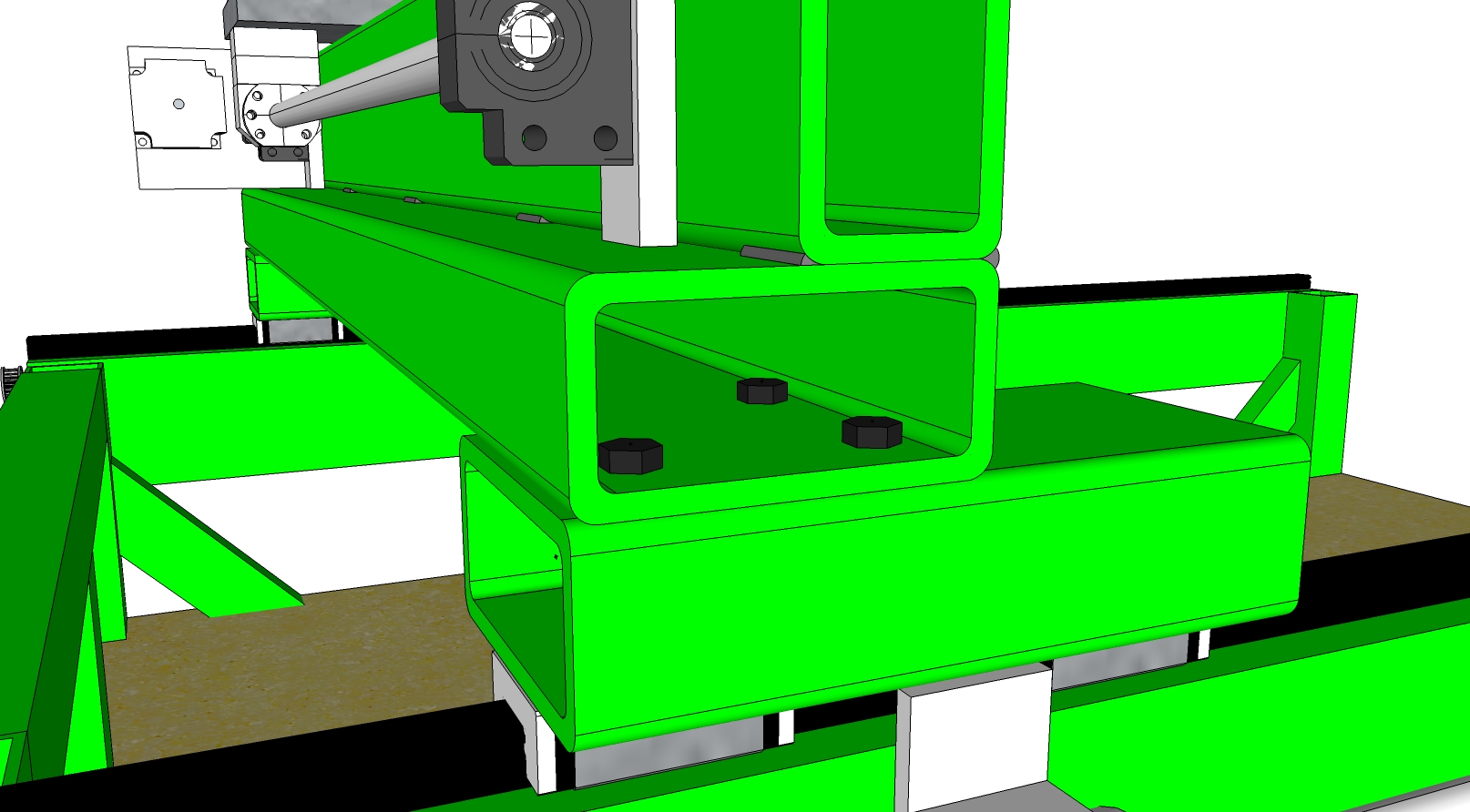

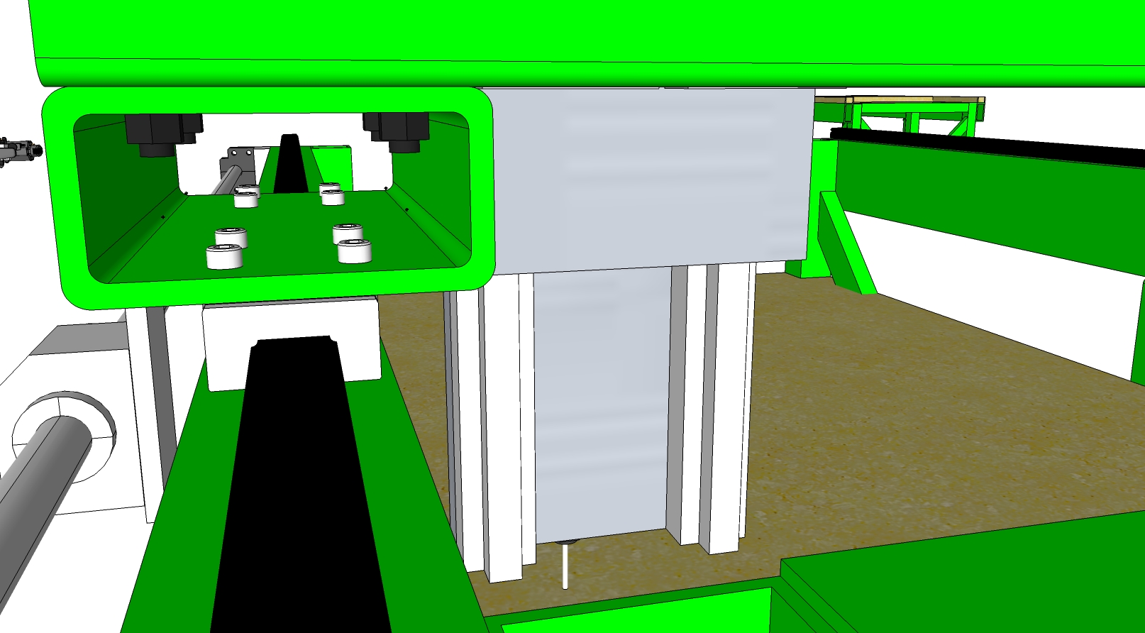

    Re-drawn the gantry as I realised that if sent vertical there was a nice shelf for the chips/dust to collect on. How about this way?
    This shows the Y axis ball nut holder attaching to the Z axis plate.

  8. #228
    Neil,
    You've turned the gantry round !, I thought the idea was to have the ball screw at the back out of harms way ? I know this reversed way puts the ball nut nearer to the Z axis but it's been stated that in practice it makes little or no difference to have it at the back.
    I like the box section idea between the bearing blocks and gantry, it allows easy access for bolts and does not require counter boring.
    Seeing as you have spacers between the frame and ball screw bearings on the long axis, why not extend them up so that the ball screw is more in the same horizontal plane as the rails ? I had them like your drawing at first but decided to raise them as far as possible. I'm thinking a limit switch could also be mounted on the extended spacer, above the ball screw bearing.
  9. #229
    Don't forget my machine will be mounted at 75° from horizontal (eventually!) so before the gantry would have collected all the crap being thrown up by the cutter. This is only going to be a temporary gantry (famous last words!) as I'll use it to cut the aluminium parts for the "proper" gantry from the 800x1000x20 sheet of Ali I have lying around gathering dust, which will then be enclosed to protect the ball screw.
    I've put the ball screws there to protect them from flying crap as much as possible from the cutter as they are hidden behind the rails where they are. They are only 45mm below the X axis carriages so I'm not sure that it would make any real noticeable difference in terms of performance?

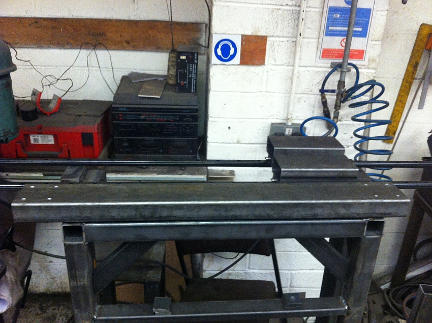

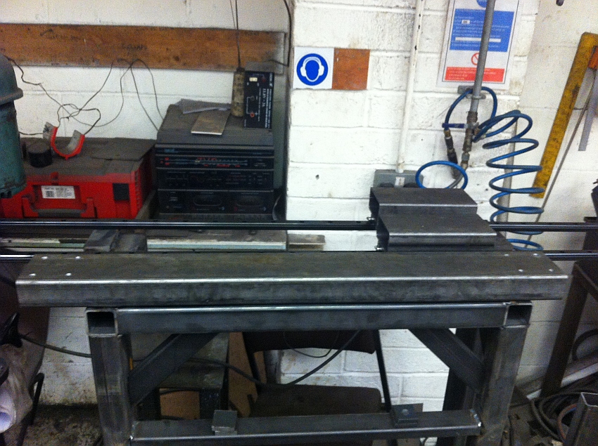

    Yesterday I set one rail parallel to the steel beam and bolted the steel to the carriage mounts to check that the gantry beam had the holes in the right place.
    I had to drill some new holes as in my rush on Thursday I drilled the pattern 90 degrees out (less haste more speed!) Managed to loosely bolt the gantry in place but ran out of time so had to unbolt it all again. Need to get a shift on as now only got the workshop facilities for another month...
