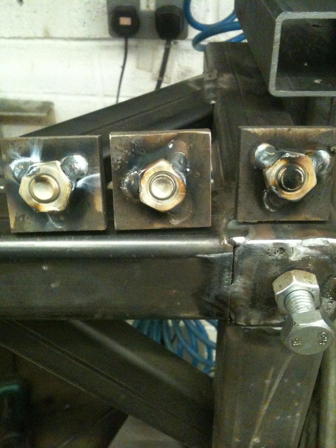

    Well got out in the works for 1/2 hour just now...miracles do happen!!
    Managed to drill some holes on some 40 x 40mm flat and weld on some M12 nuts to the back. These are for adjusting the frame flat whilst the epoxy is setting, they won't be used for feet as it's going to be vertically mounted......eventually.
    Managed to weld in one of the feet and tidy up a bit with the angle grinder. Also put the top part of the gantry on and stitch welded it to the bottom half making the L shape. Camera died before I could get a picture of it though...

  7. #247
    Don't do a 'rush and regret' job on it, which I sometimes succumb to myself
  8. #248
    Won't be rushing, not huge amounts to do. Want to get the epoxy on tomorrow...
    Neil...
    Build log...here
  9. #249
    This mornings progress...
    Ground all the welds flat that needed it. Tacked on a piece of 50x50 angle as the bridge between the rails.
    Realised I'd left the stop plate unwelded on the top so put a run if weld down and ground it back. Now the epoxy won't leak there.
    Frame being forklifted round to the test bay, no point carrying it when there's the equipment to do it for you!
    Frame tucked away and feet adjusted so it sits level.
    Sat out the way in a corner...
    What's missing from here? Yep my digital scales so no epoxy mixed and poured today :(
    All moats in place. Used masking tape to seal the gaps.
    Put the gantry on the frame and shimmed it level and 90 degrees to the x axis mounts.
    All ready for the pour which will be first thing Monday morning before work. Not a bad 3 hours work this morning really.
    Neil...
    Build log...here
