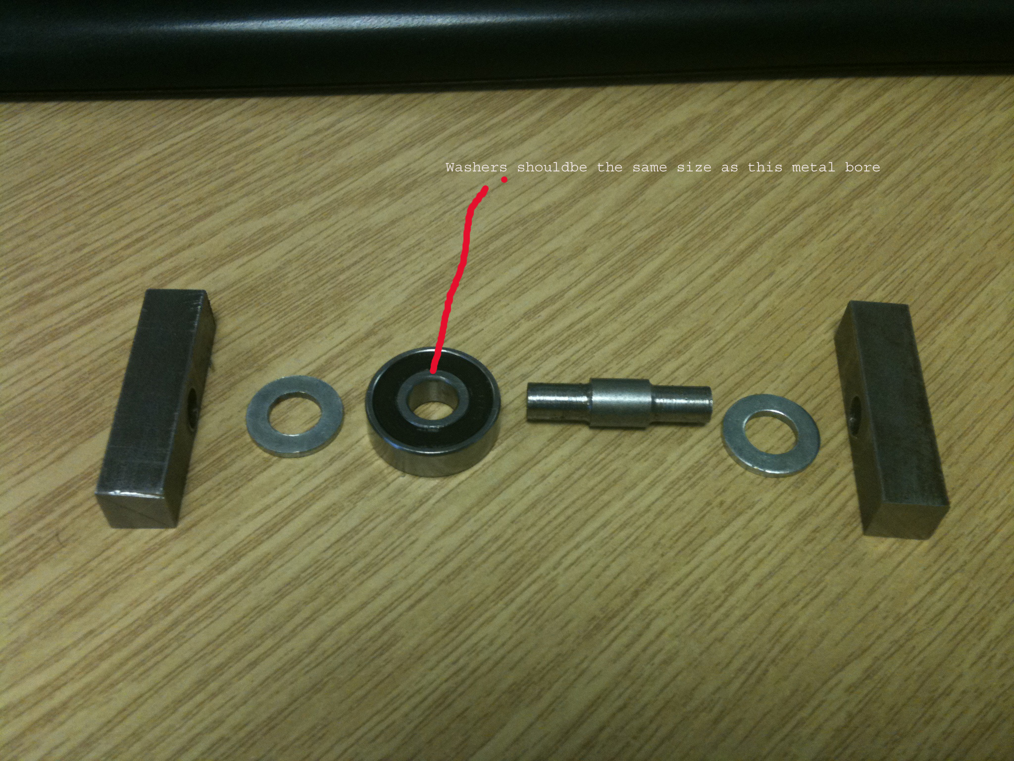

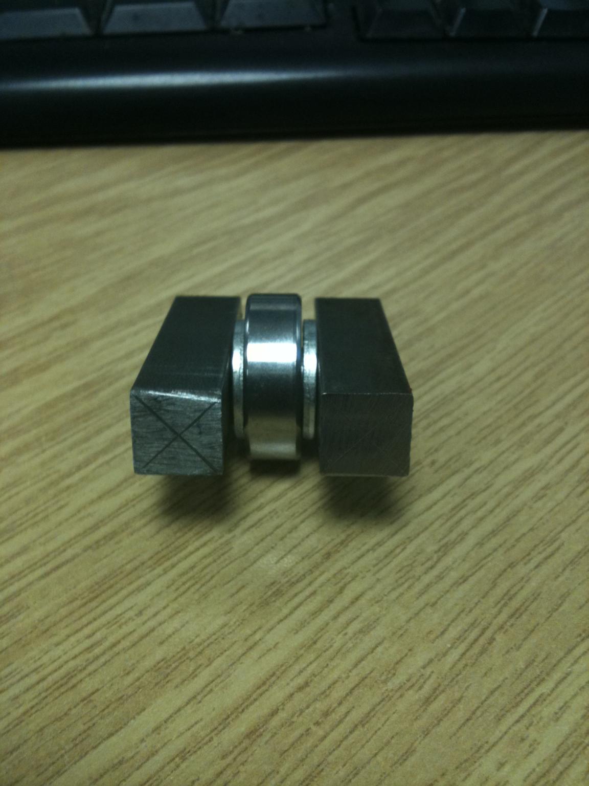

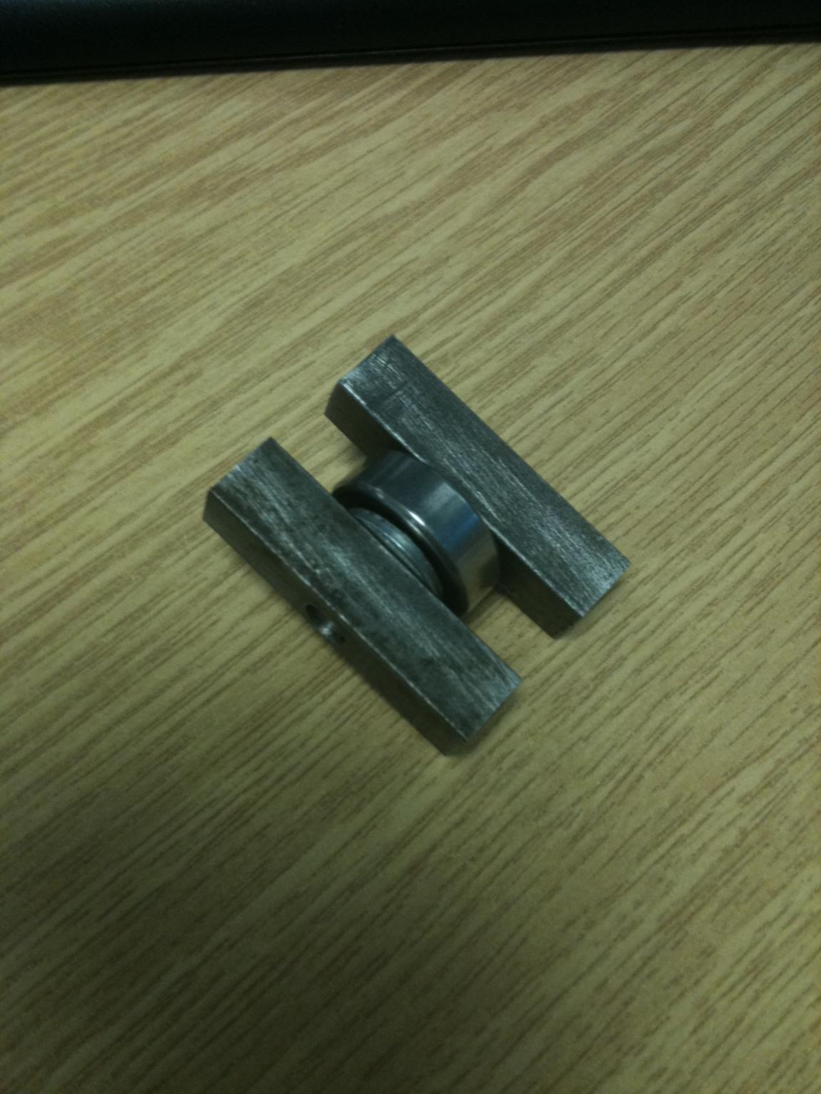

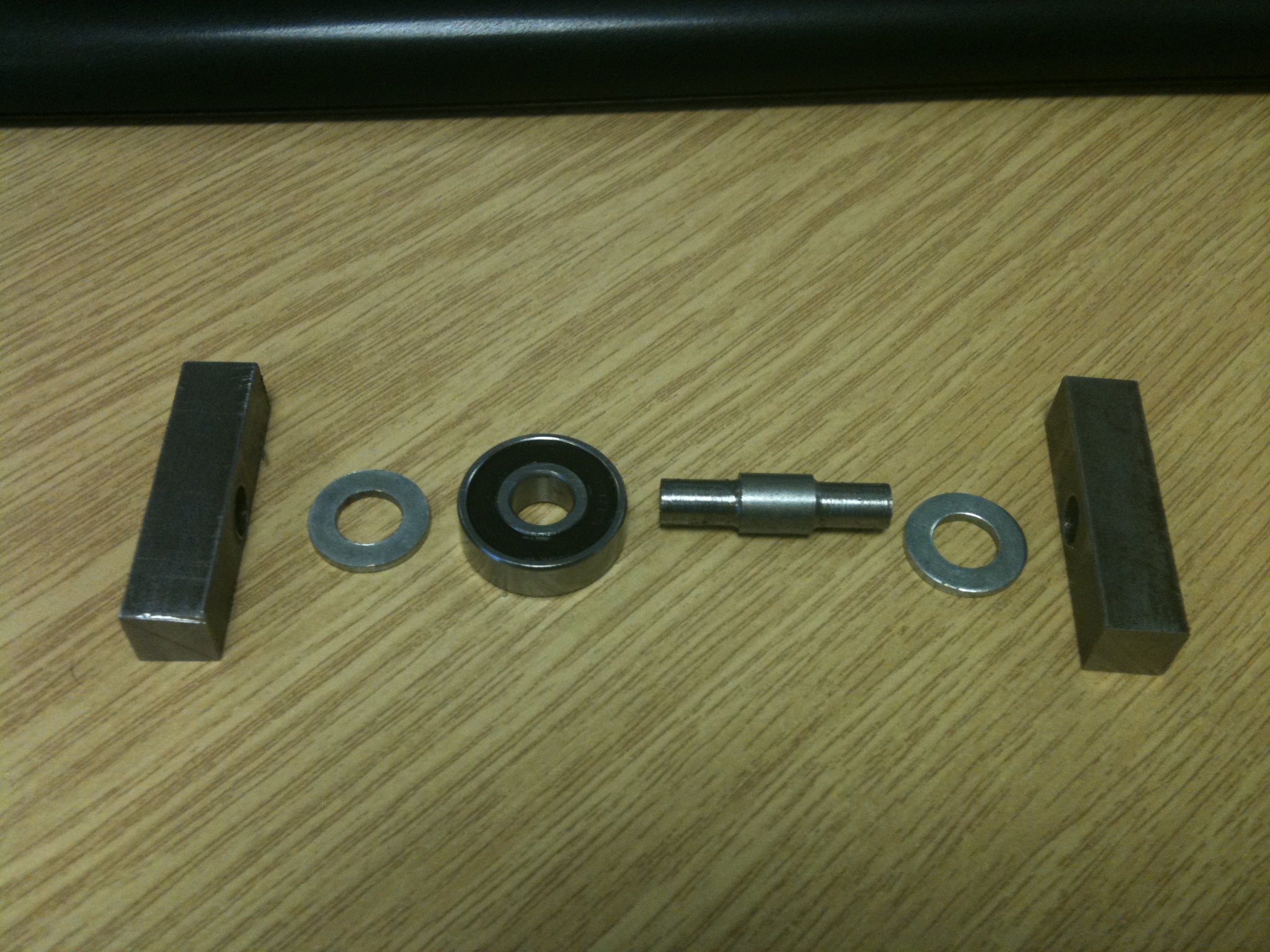

Well been far too busy last week at work (clearing up all the bits and problems that had accumulated after 2 weeks on holiday
) and out of work (been doing DIY :confused:) but today managed in my lunch 3/4 hr to do a little something on my skate-o-rail bearing.
The problem with only having 3/4 hr is that by the time I've set the lathe up (read cleaning everyone else's muck off it!) I've run out of time to do anything!! Will have to set aside a saturday morning for a more serious production run! Anyway all I managed to do was cut 2 off 10mm sq steel axle supports, drill a 6mm hole in them and turn a rough (and I mean rough as the tool needed sharpening) axle.
Pics are attached. Ends need drilling and tapping yet and another 2 off units and the end plates making...still it's further forward that I was!!Last edited by Lee Roberts; 23-08-2010 at 02:27 PM. Reason: Cleaned up the image locations.
23-08-2010 #17
Hmm! can't quite make out whether these will cause friction,the washers at the outside of the bearing will rub against the rubber housing and cause some degree of friction.
Personally the washers shouldbe the size of the middle outer bore with at least a 2mm gap between support and bearing.
23-08-2010 #18
23-08-2010 #19
Hi mate, I think ideally you should look at re doing the axle stud, only this time start with larger stock and turn it down leaving a nice set of shoulders for the bearing inner race’s to home to. (Sleeves with shoulders)
The rubber shields on the bearings will turn but its not ideal and they could end up jamming.Lee
23-08-2010 #20
I'm also guessing that those bearings are 8 to 9mm wide? if so that spigots bearing spindle is far too wide and will cause the bearing to side travel.
