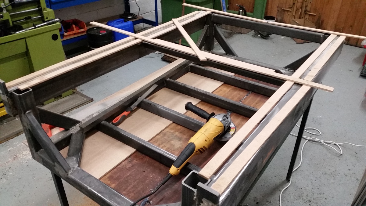

    Well I dusted off the frame this afternoon and took the last of the epoxy off. It's actually set really hard so I could have used it after all....but better safe than sorry I'm going to re - do it from scratch. 10 mins with a hammer and chisel (screwdriver) and and angle grinder with flapper disc and it's back to bare metal. Going to cut mdf sides this time and seal the gaps/edges/joins with silicone sealant. Got to do a bit more proper work now this afternoon on the lathe but hope to get the moat done tomorrow.

    Only managed 1/2 hour on this today but cut the MDF for the moat. Tomorrow I'll glue it together and seal it, thinking of sticking it to the steel with silicone sealant which will also act as a sealant to stop (hopefully) any leaks as I don't want a repeat of last time where despite my best efforts (obviously not good enough) I had leaks at some joins.
    If I can get it together and sealed then I might go for a pour so it starts to set over the weekend. Whatever happens I'll not be rushing this....lesson has been learnt from last time :)
