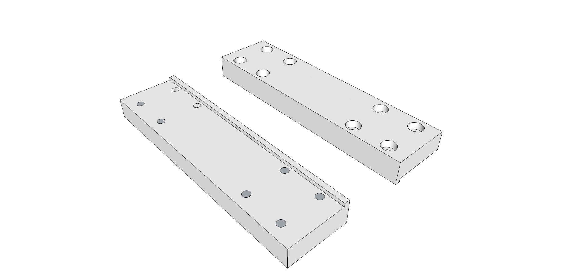

    I've decided to cut the 20mm piece of Ali I currently have to the correct width for the bed which will leave me a 100mm (ish) wide strip 1000mm long (ish) which I can use for mounting blocks. I'll cut a piece 200mm long and machine a carriage block...
Name:	X-axis carriage block.jpg
    Then after attaching the carriages on the master rail I'll move it up and down and clamp the rail ready to drill.

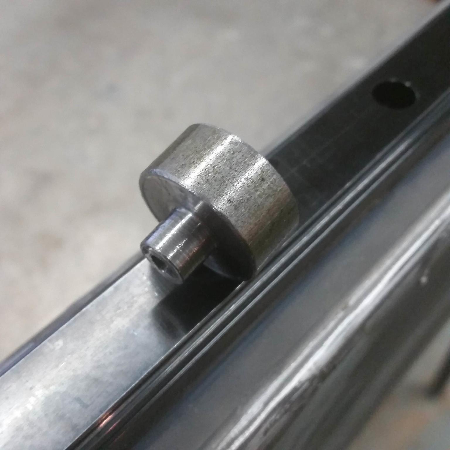

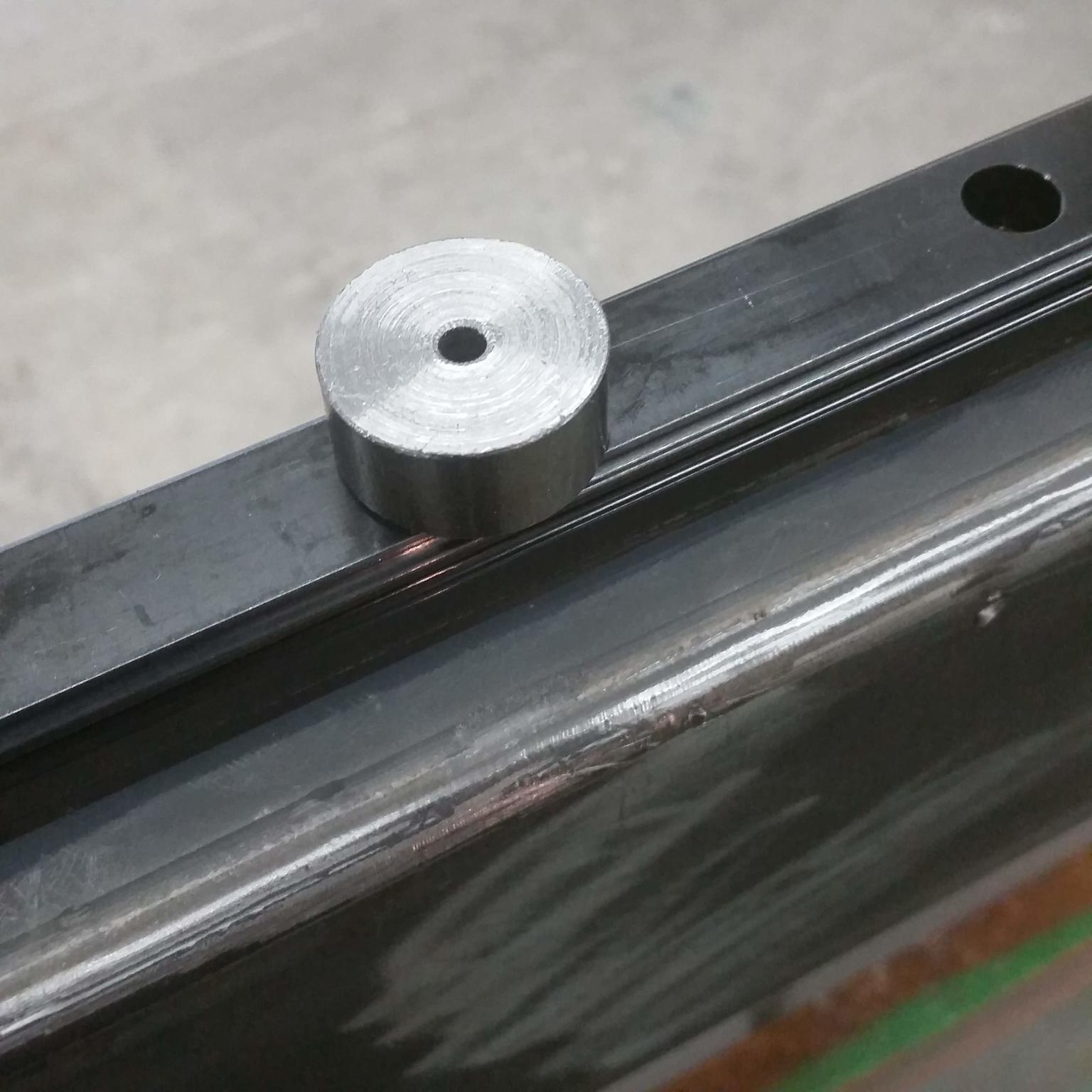

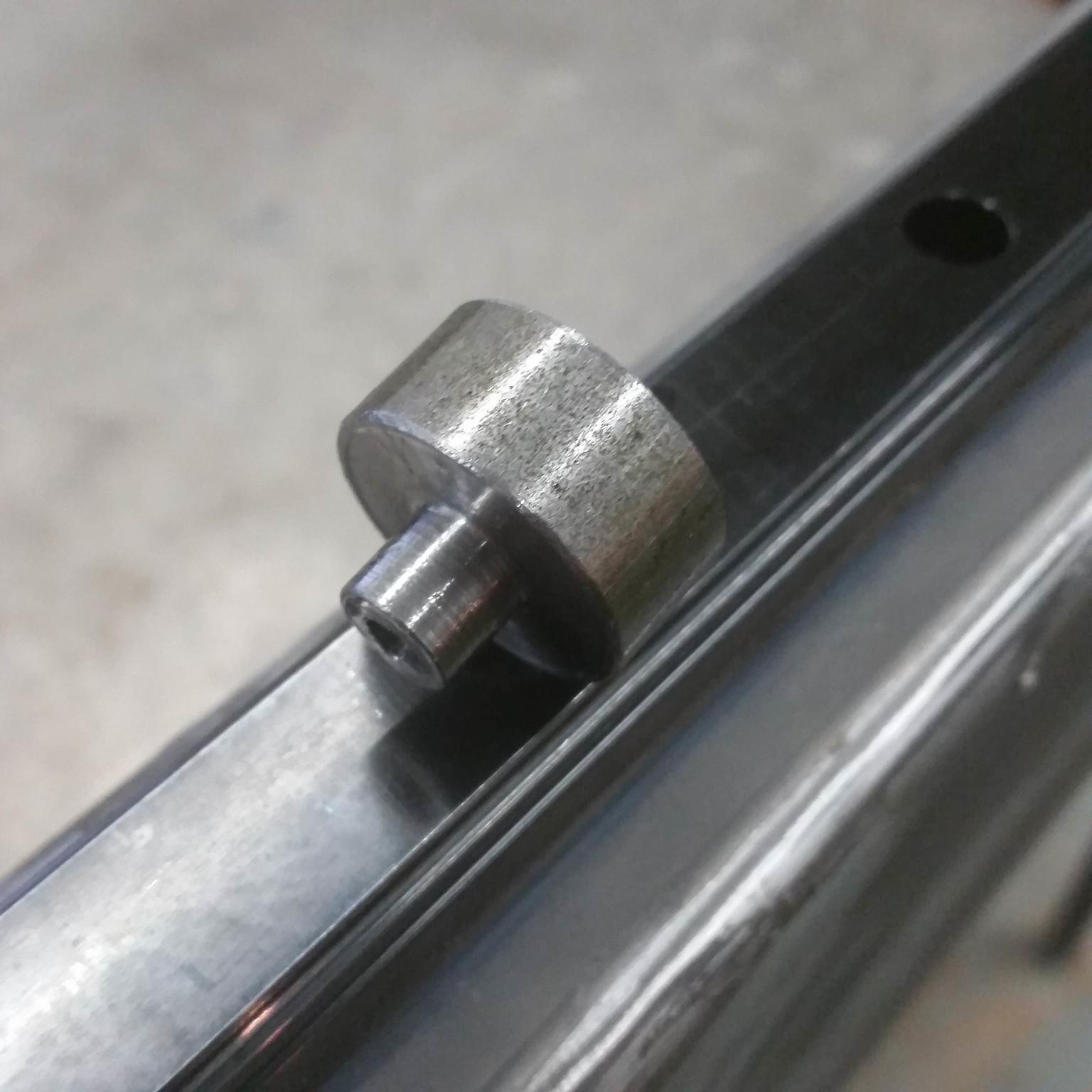

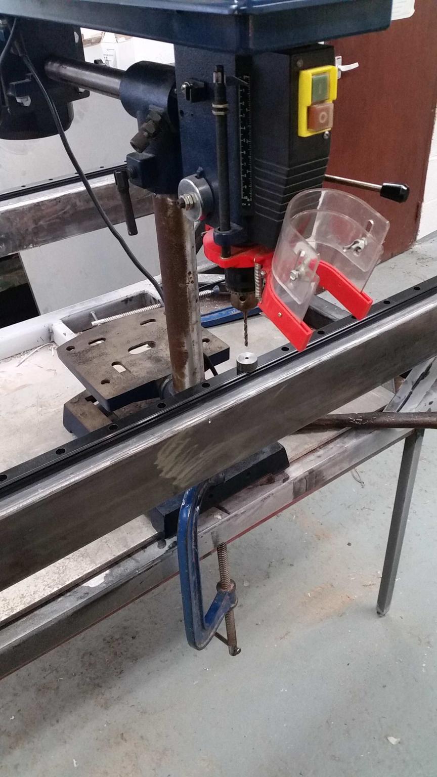

    I've put a piece of 10mm Ali plate on the bed and moved my Pillar Drill on to it to drill the holes, a bit like below...
Name:	Pillar Drill rig.jpg
    Should make drilling easier (but slower) and I hope not to snap any more drill bits as I snapped one in an end hole on the rail

    Neil, It's obviously best to drill the holes spot on but if they are tapped at an angle it's wasted effort, I like your drill guide so maybe a similar thing is reguired for the tap or maybe you could just open out the drill guide hole slightly.
    Funny you should say that....I've just made a tap guide as I had that very thought. Will be tapping them by hand, shant be impatient and use a drill!
