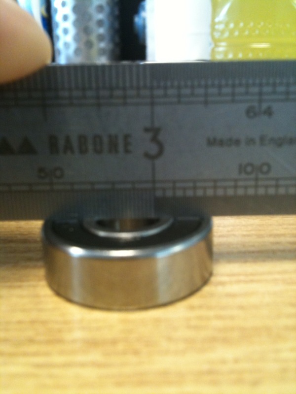

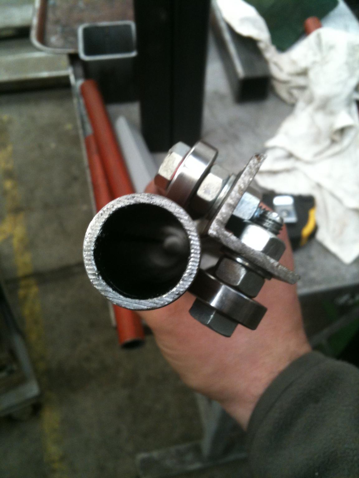

    The washers do not rub on the rubber shield, see attached pic. But I was going to turn down some custom ones on the lathe if they did instead of using std M8 BZP washers. The bearing is a 608RS which is 22*7, the washers are 1.5mm wide and the centre of the axle is 10mm.
    Neil...

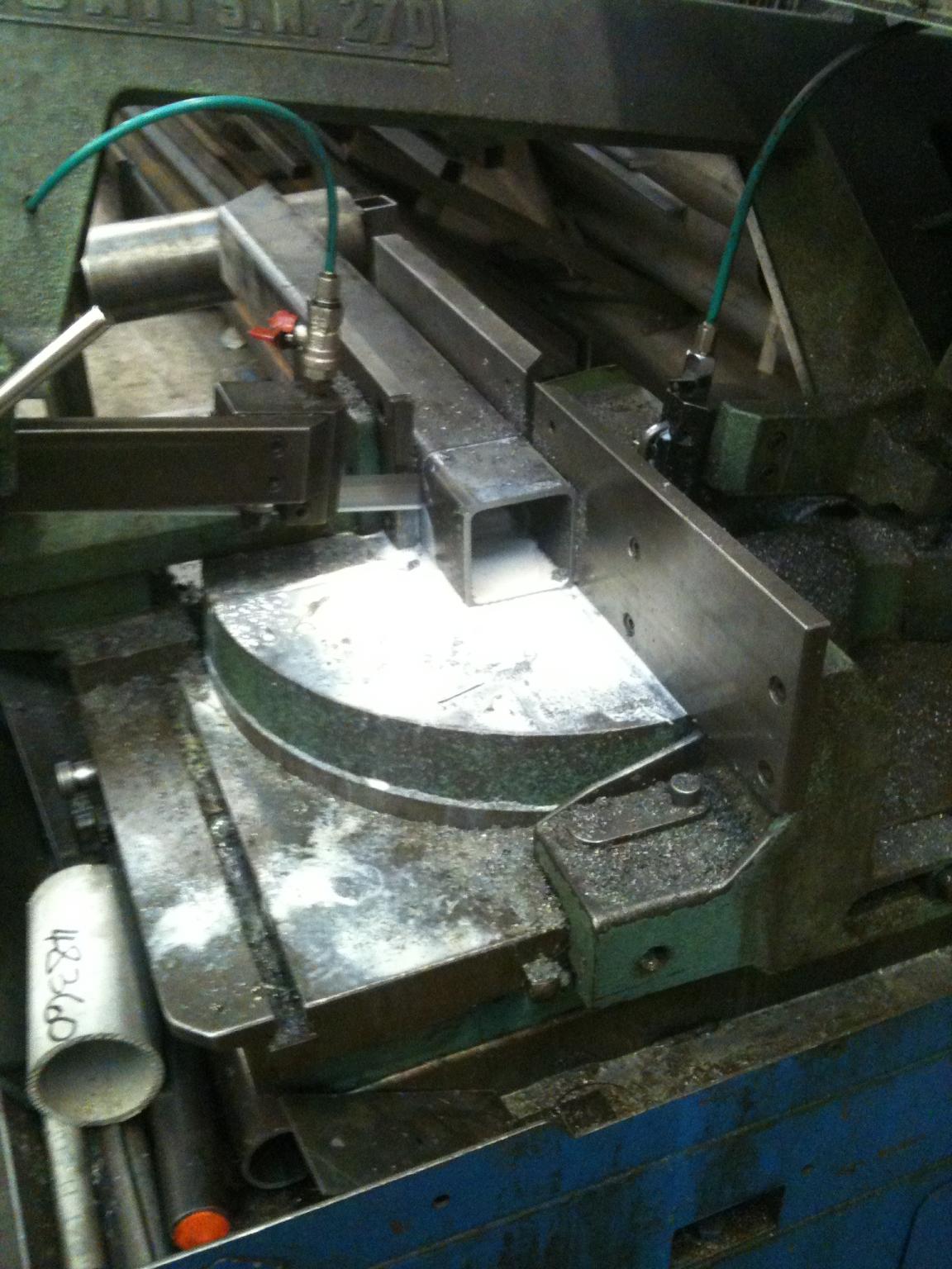

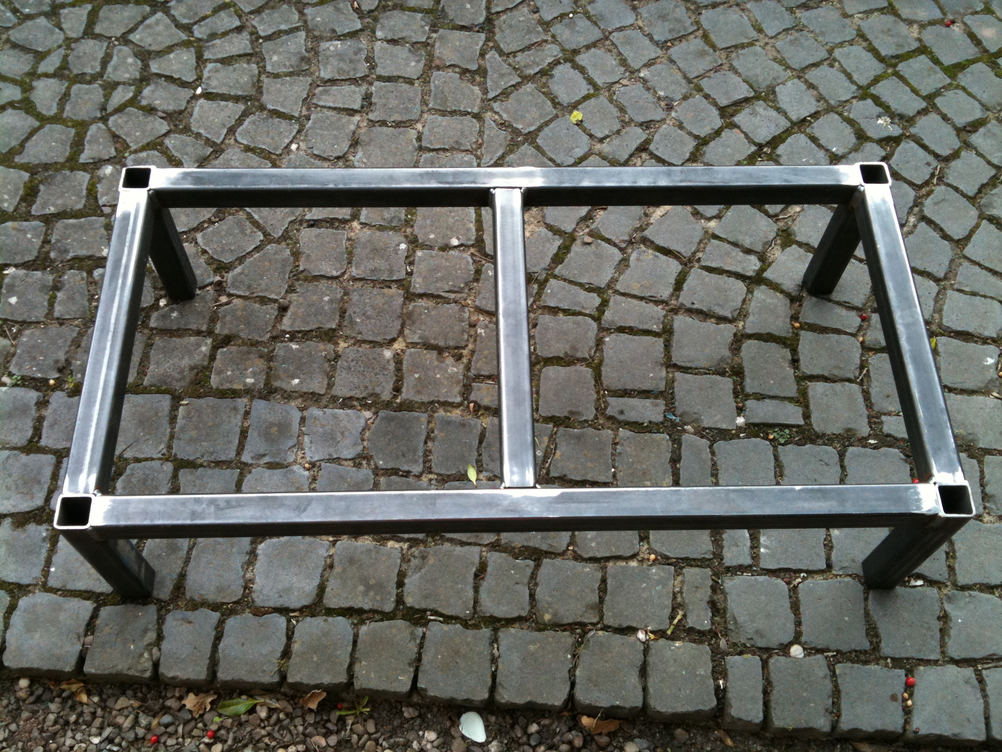

    Well after about 6 weeks of doing other things (scratch building a RC glider DIY etc...) I spent a couple of hours in the works on Sunday cutting up some steel for the frame and the rails, see attached pics. Just got to cut some angle for the rail supports and do some welding and things will be progressing...think it's gonna take a bit longer than I thought given the limited time I've got to put into it.
    Still like British Rail....(as was!) I'm getting there

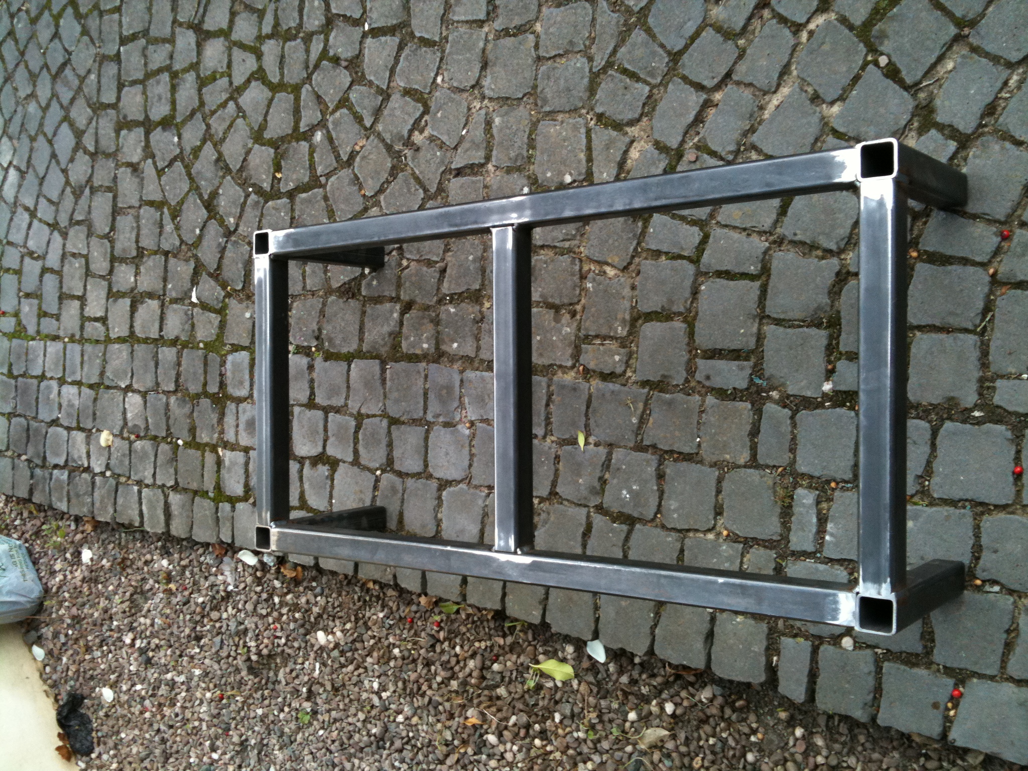

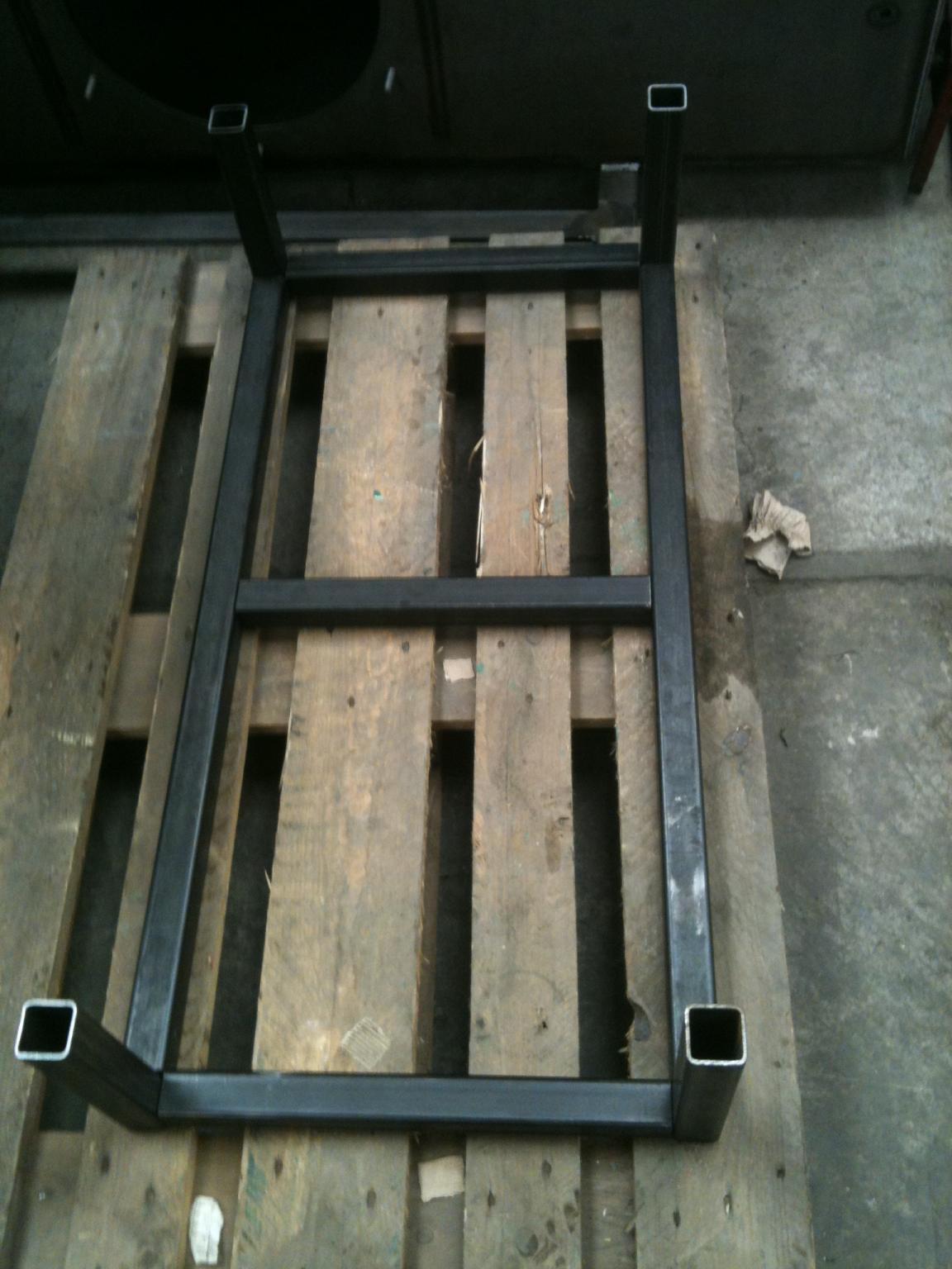

    Hmmmm....well it's taken me a year to weld up the baseframe, did it last saturday morning. Got into RC helicopters in the last year which has taken up all my time and money (costs alot to crash, well it does when you crash like I do:naughty:) also started selling Velcro on fleabay which has recently taken over my free time and what little money I had left. Anyway....I also drilled the rail holders I'm planning on using in my lunch hour. Now hoping to crack on with this build.
    Will post pics as and when I get stuff done!

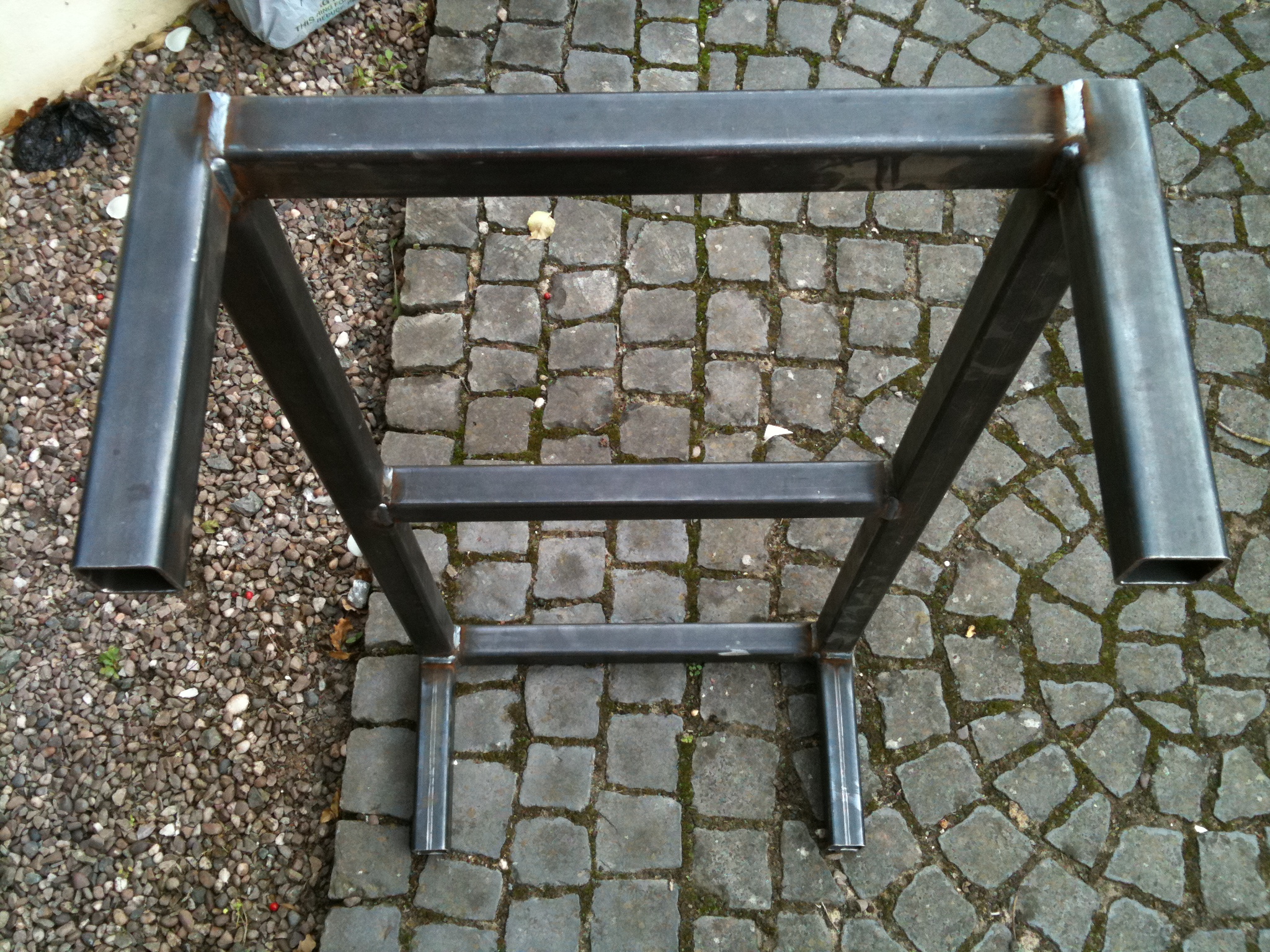

    Neil...
    Build log...here

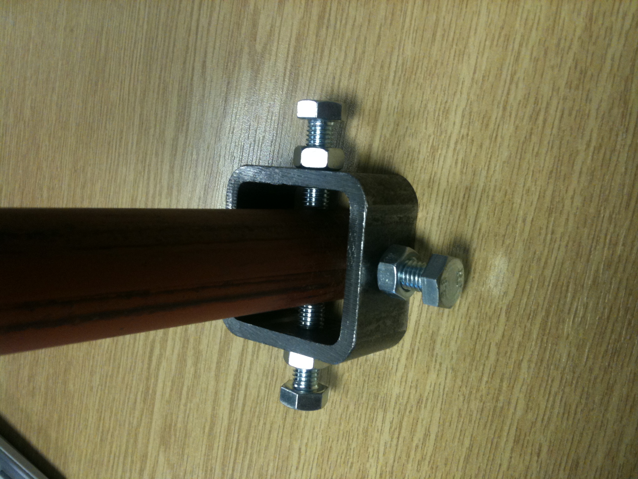

  9. #29

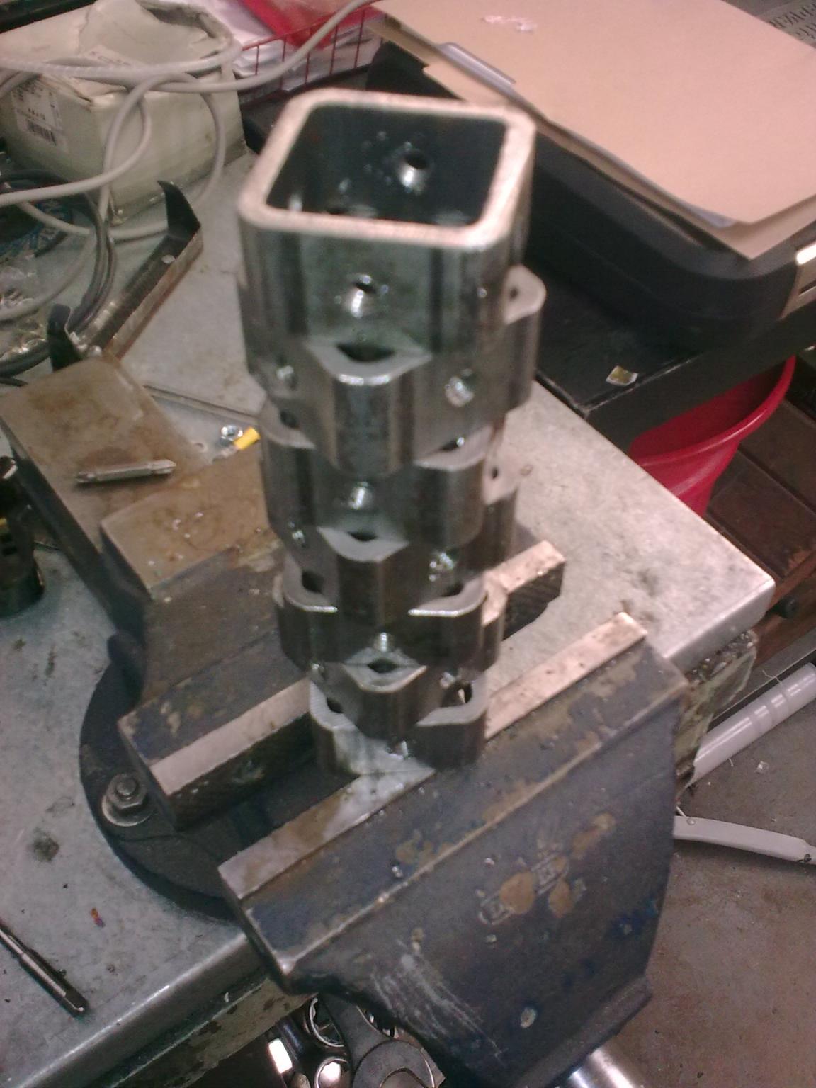

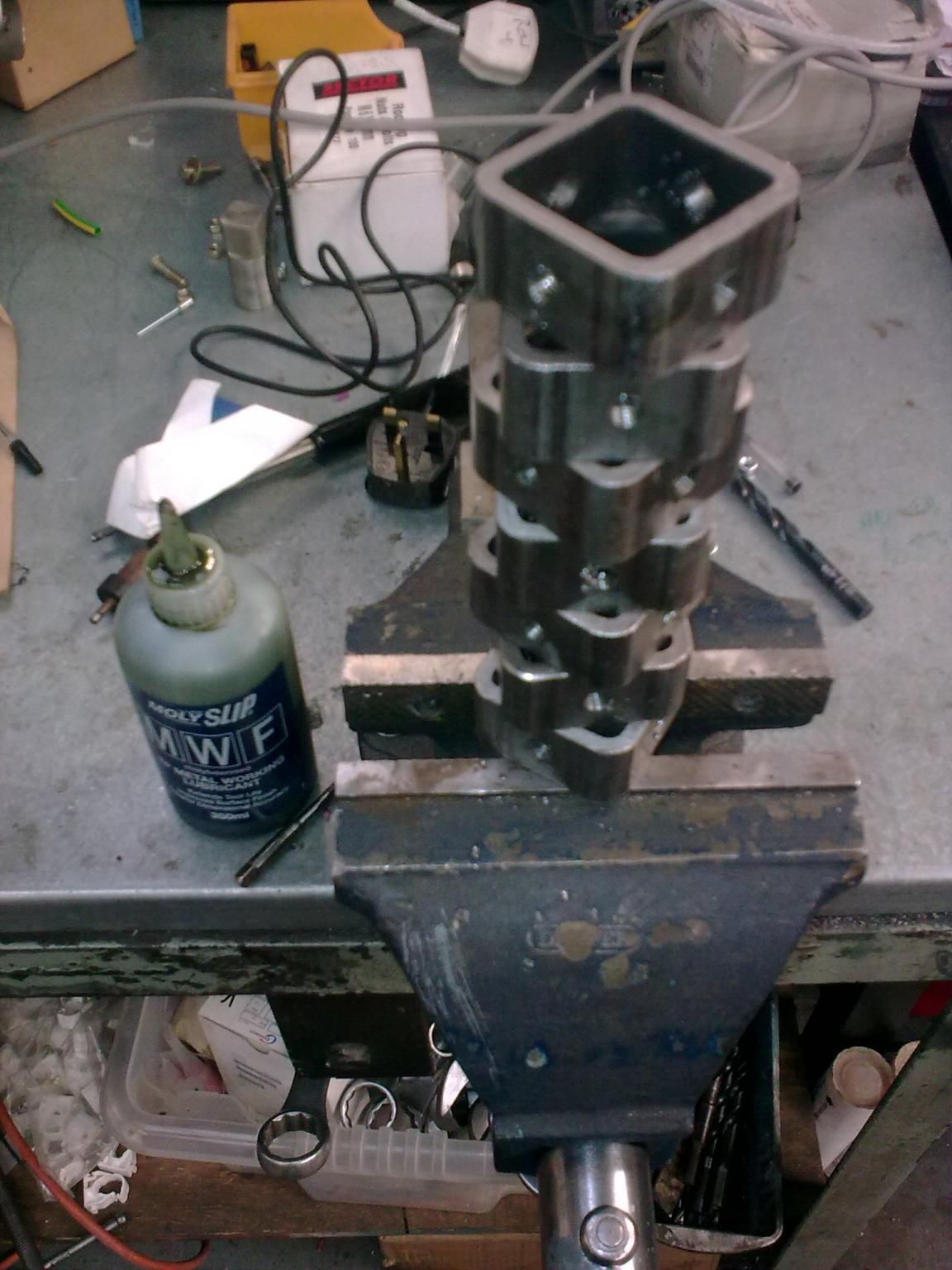

    Did a bit of drilling and tapping in my lunch today...
    Neil...
    Build log...here

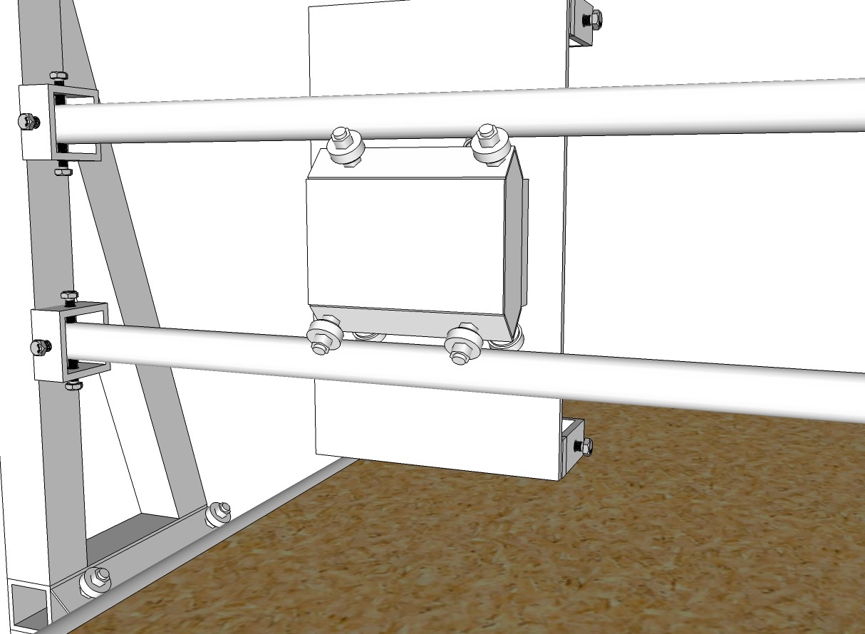

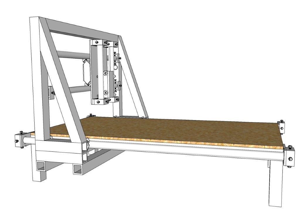

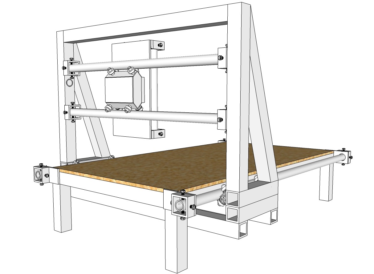

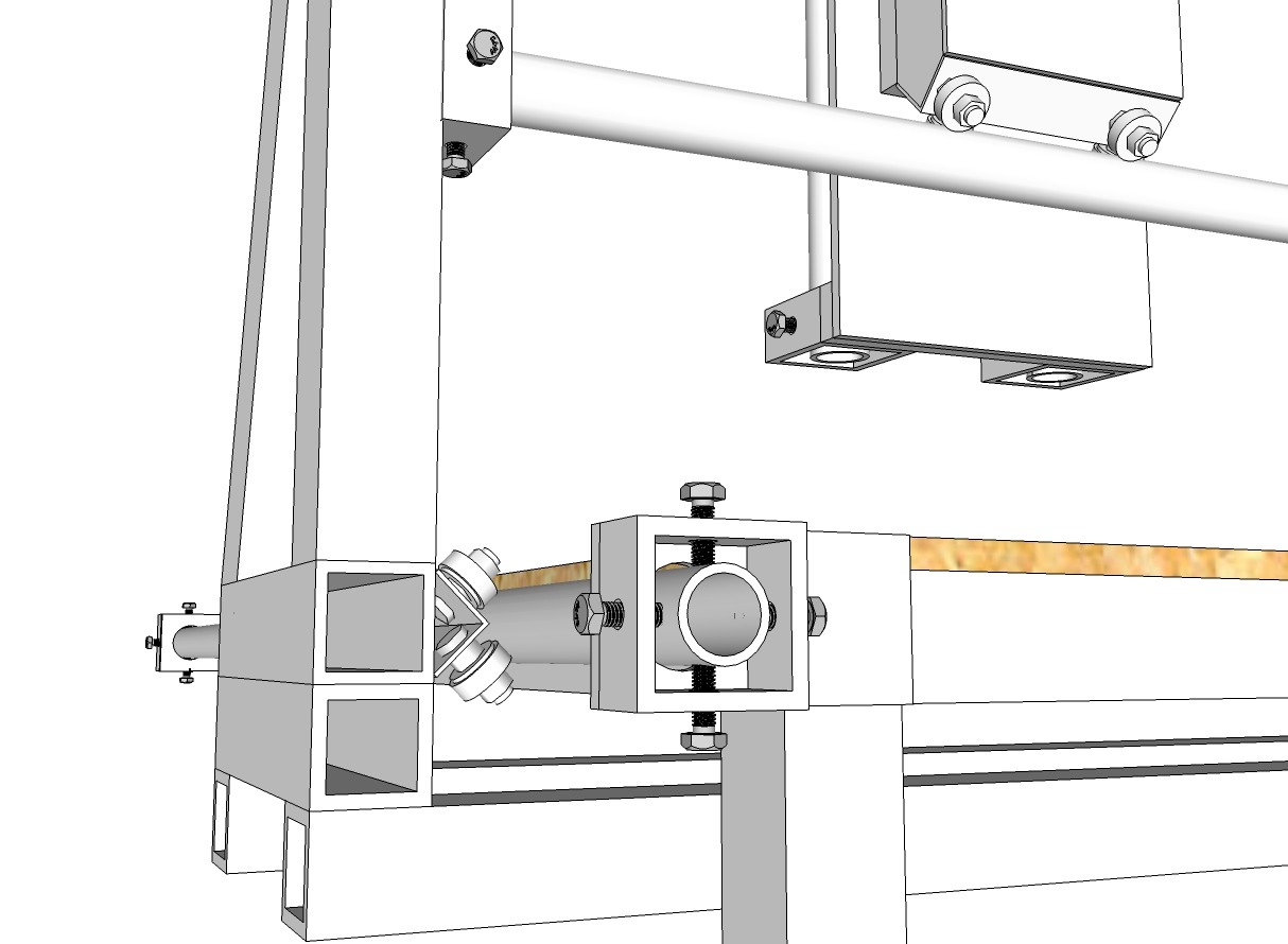

  10. #30

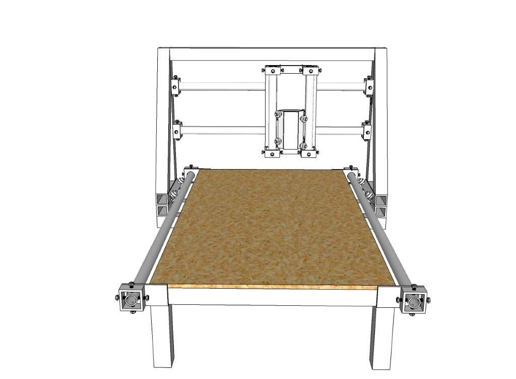

    Been playing with Sketchup to see what my router will look like. Think I'm going to have to beef up my long (X axis?) rails as the gantry is going to be heavy...thinking about it might have to lighten it a bit else the stepper will struggle. The base is 1000mm x 500mm, box is 40x40x3 steel, plate is either 3mm or 6mm steel (all used as available from my works scrap bin!)
    Comments???
