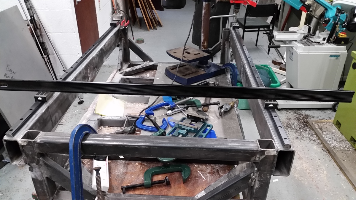

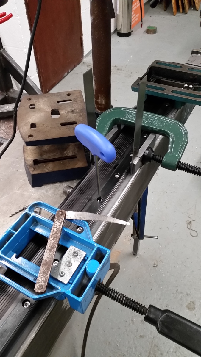

    Placing the straight edge against the rail there was a bow in the middle of the rail of about 3 thou so I loosened all the master x rail bolts and clamped (lightly) the straight edge to the rail in 6 places. I then tightened the bolts checking with a feeler that there was no gap between the reference side of the rail and the straight edge. Once this was done I placed the straight edge on the reference side of the rail and tried the feeler gauge again. It was the same all the way down with no gaps so I'm happy with that. I'm going to clamp (lightly) the straight edge to the rail again and then one by one take out the M5 socket cap heads and threadlock them in. This should give me my master reference X rail to set the second X axis rail from.

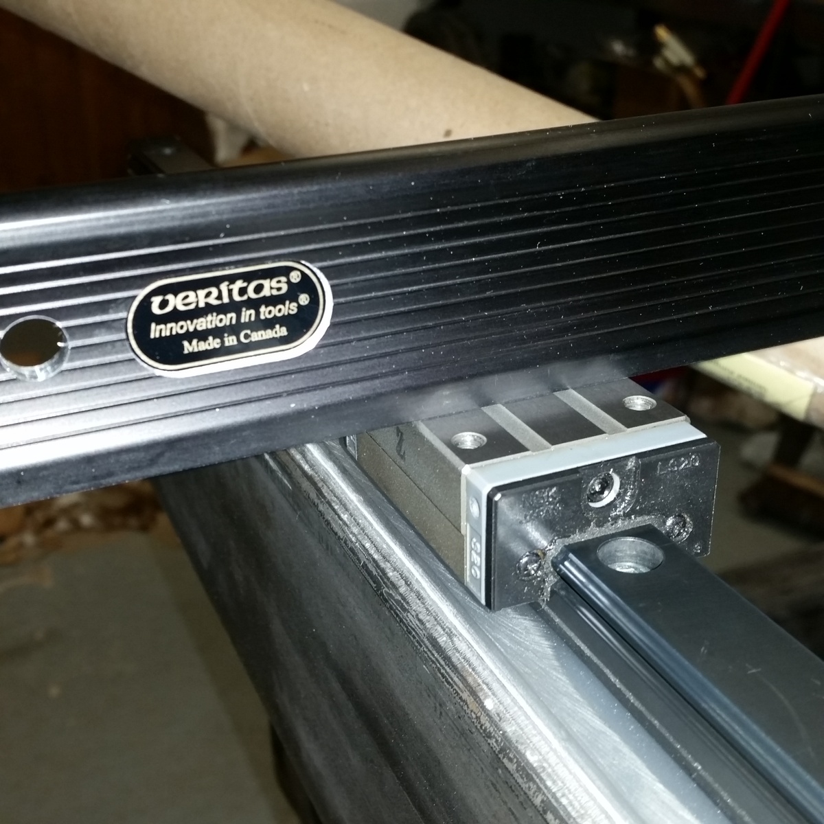

    I wanted to see if there was/how much twist there is in the rails. Placing the straight edge across the two rails on top of the carriages I tried to get a feeler gauge underneath the edge and couldn't. Shone a light from the other side and couldn't see a thing so it looks like the epoxy has done it's job in finding the level. Again I'm happy with that!
    That's a good indication that they're close, but since you've got the straight edge you might as well measure it carefully. The issue with what you just did is it's hard to measure very small angles and you don't get a reading for what the angle actually is. Instead you need to do something like in my build log - stick the dial indicator on one of the bearings and mount the straight edge parallel to the rail, but some distance (say 200mm) horizontally away from it. Make the indicator touch the straight edge, with it's movement perpendicular to the surface. That will convert the angular reading into a linear reading and amplify it. You don't need to worry too much about getting the straight edge level, as if you plot the readings on a graph that will just make a linear error which you can subtract.

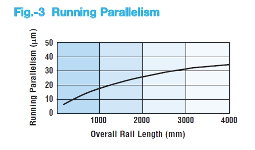

    These are the NSK specs on running parallelism....seems in theory I have about 16 microns for my 800mm spaced rails to play with....to be honest I think you can keep chasing numbers till you're red in the face and for a router that's going to be used for wood and plastics mostly with some aluminium then I'm not going to get my knickers in a twist about it.
    I'm going to do a quick test as Jonathan did (I'm intreagued now) and then once the gantry is made bolt it to the carriages and see what they sound and feel like.

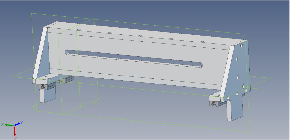

    Been drawing up the gantry in Geomagic 3D program today. Getting there, so far all the holes etc. line up!
