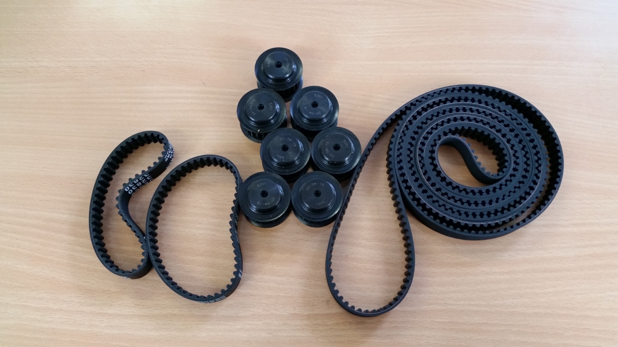

    Got some belts and pulleys today, didn't get them from Belting online or anyone like that as our local company we use for bearings etc. Gloucester bearings (Hayley) were so much cheaper for the pulleys and a bit cheaper for the 2525 belt...
    7 off 20 tooth pilot bored pinions - P20-5M-15F £1.73 each
    1 off 2525-5M-15mm HTD belt £14.85
    2 off 265-5M-15mm HTD belt £4.31

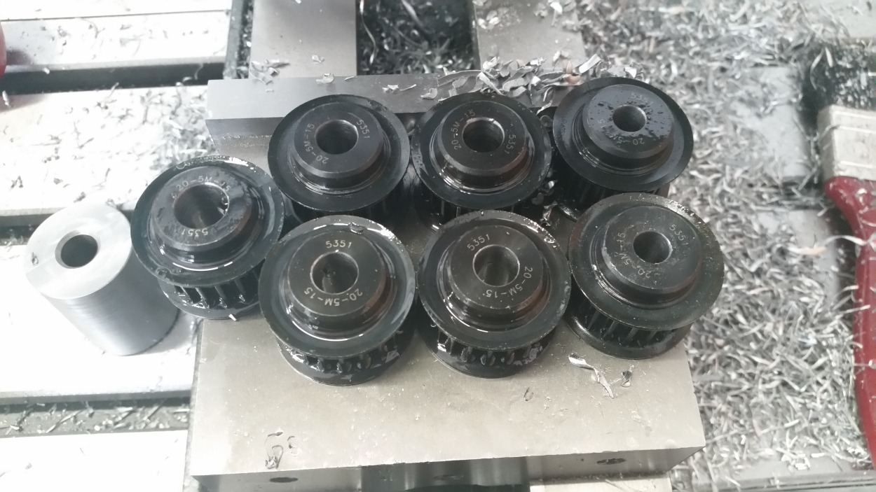

    I realise that the pinions aren't pilot bored like the ones from belting online but I was going to have to drill them out to the correct size for the ballscrew ends and stepper shafts on the lathe anyway.

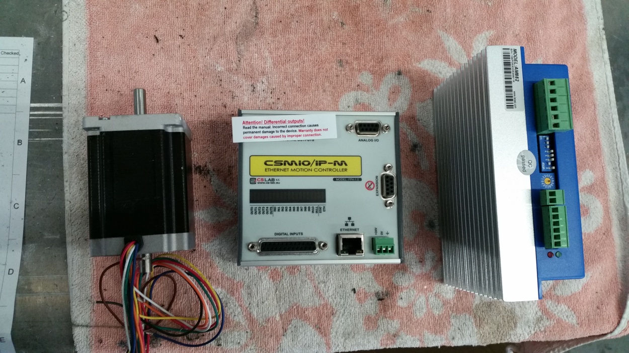

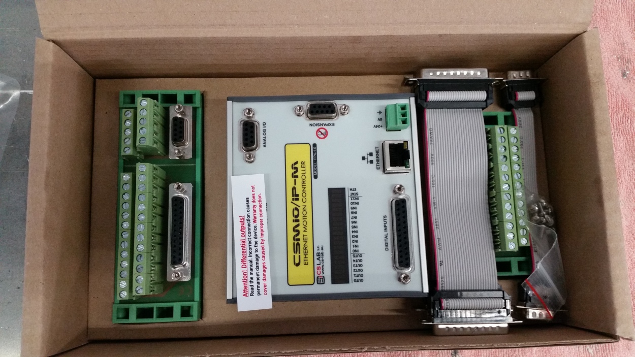

    CSMIO....
ID:	14755 Click image for larger version.

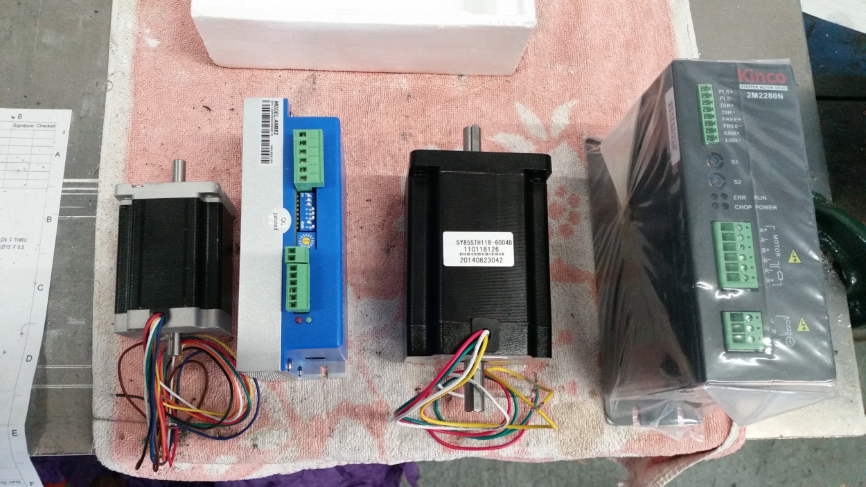

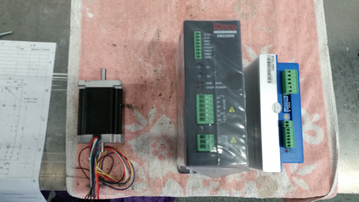

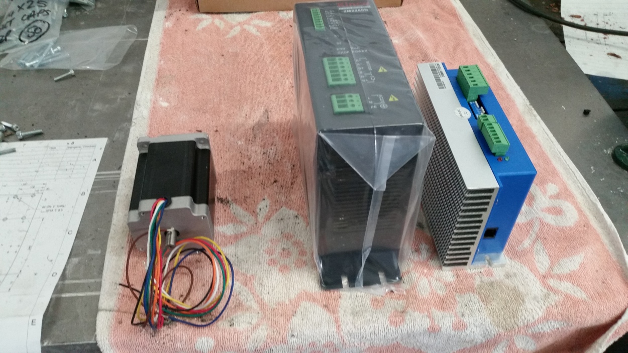

    Showing it's size against a Nema23 stepper and AM882

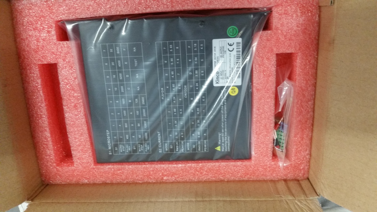

    Kinco 230V Driver
ID:	14757Click image for larger version.
ID:	14758Click image for larger version.
ID:	14759Click image for larger version.

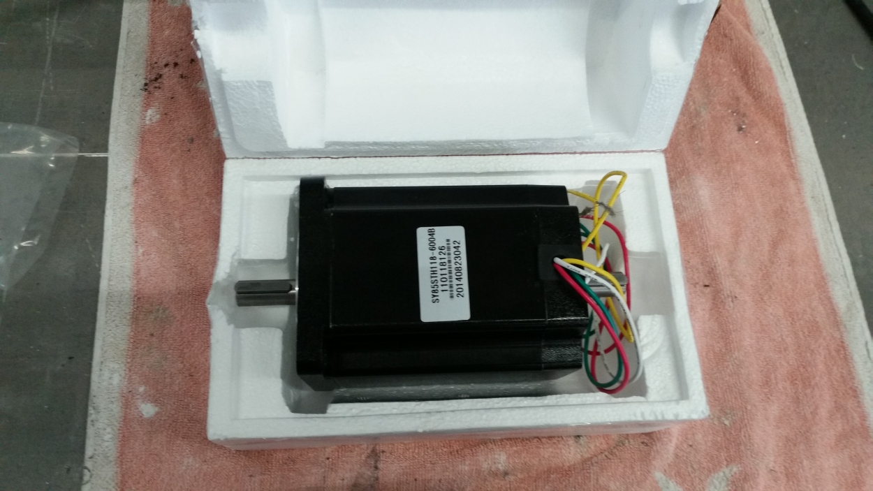

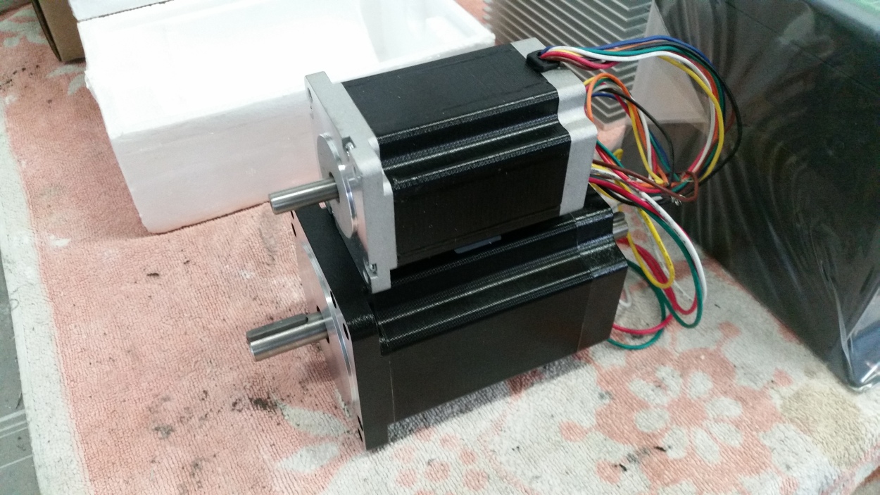

    Nema34 8.7Nm motor...(4 off)
ID:	14762Click image for larger version.

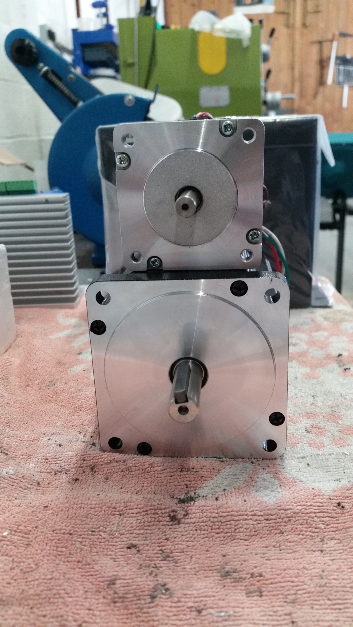

    Showing the difference between a Nema23 and 34...
ID:	14765Click image for larger version.
ID:	14767Click image for larger version.

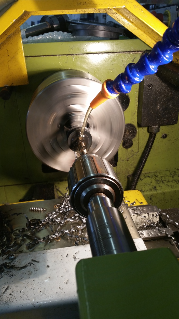

    Drilling the pulleys...2x8mm, 4x10mm & 1x12mm
ID:	14764Click image for larger version.

    Cheers!! Only one Nema34 is going on this....it'll be on the X axis driving the twin ballscrews. The other 3 will be going on the mill conversion ill be doing next...hoping to do more tomorrow but work is getting in the way!
